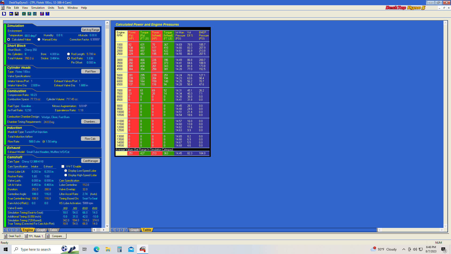

For what it's worth here's what Desktop Dyno is simulating for my TPI/Megasquirt build with 1.5 rockers:

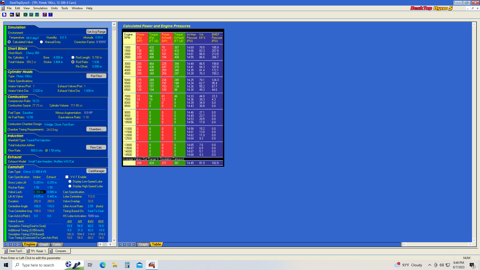

And with 1.6 rockers:
Old Aug 7, 2023 | 07:21 PM
REELAV8R's Avatar
REELAV8R
Joined: Apr 2011
Posts: 6,284
Likes: 1,171
From: Hermosa
Simulation seems to support extending the top a little. More hp through RPM and slightly higher tq around 4000 to 4500.
interesting it does not show any loss down low really (1 lbft @1000) and benefits start around 2000 rpm.
