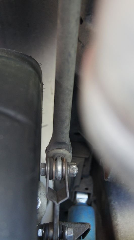

here is the clearance with a 18 x9.5" wheel with 4.75" backspacing.
Here is where the wheel sits on the car.

Other limiting factors. Rear Spring. This is with 4.75 Backspace wheels. If using Ridetech coilovers this is not a issue.
Sway bar if installed.

Thanks for the pics. Yes the rear spring clearance was a factor in my decision for coil overs. I'll have to get my car up and check the clearance with the frame rail too i guess.
