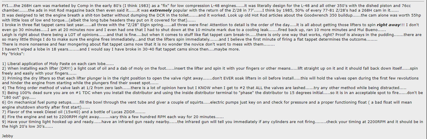

Make sure you remove the inner springs to break in.......
I wrote a whole cam break in check list in a previous thread recently......maybe somebody has a link.....

And Jebby is spot on about the break-in procedure the builder needs to run. There are a lot of issues with breaking in flat tappet cams, and the details seem to be lost with younger builders, so unless he has been doing it for like 40 years since when these cars were new, I strongly suggest you get him to follow Jebby's recommendations, including removing half the springs. There are way more steps involved than with a roller cam. Do it right and the cam should live, eliminate just 1 or 2 steps, and you only have a 50-50 chance of it lasting more than 5 minutes. It is much better to err on the side of caution with this.

I found it and took a snip for future use......

My first step after installing one and before installing timing chain...is to drop in the lifters and then spin the cam by hand. Mark each lifter and absolutely verify it rotates (usually on the closing ramp) as you spin the cam. If one of them doesn't..it WILL eat the cam and lifter.
There's a lot of poor machining out there these days.

And it isn't a bad idea to take the lifter straight out of the package and run a straight edge on the heel.....if it is flat....throw it away!
