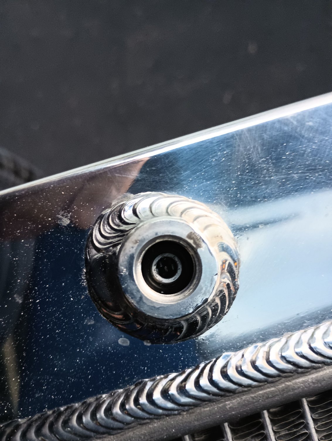

I did not know that radiators with automatic line connections had o rings .
Have never had a brand new radiator, got one from Champion and noticed the o rings.
At 76 one would think that i would of seen it. Radiators from the junk yard or just having one repaired and never noticed it, have probably put in 10 or more.
Learn something new every day.

Having this Champion radiator installed tomorrow in my 75, just checking it out an noticed the o-rings INSIDE the inlet/outlet openings.
I guess the installer will tell me go/no go, i never noticed it before in my 75 and we have had the radiator out for repair 4 times now, so just went with a new unit.
Will let you know tomorrow.

Lars That was the first thing i did in the AM, yes the new radiator has o-rings, Champion has started putting the o-rings in some of their radiators. The tech guy explained that's its a soft rubber o-ring to fill any voids that the flare doesn't get.
The Champion radiator part # was AE478
Auto Zone # was A478
Found 3 other suppliers with 478 in their part number so it must be a universal radiator--just not sure who is actually the manufacture is tho.

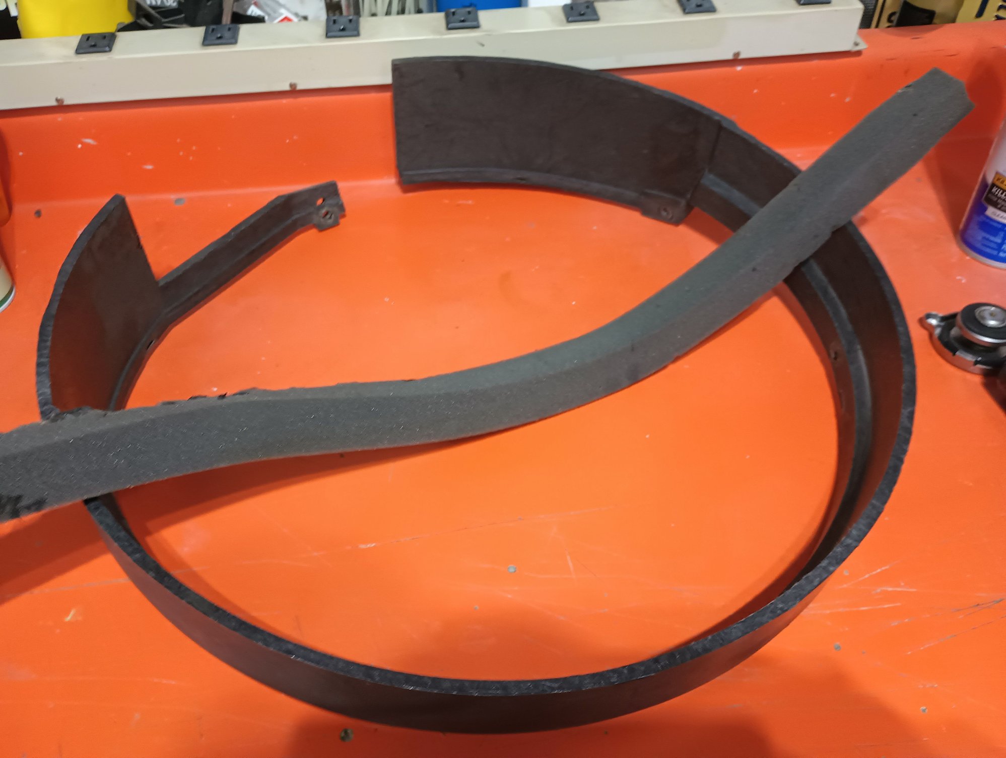

Anyway, it fits without any mods, will put the shroud extension on and reinstall all of the foam sealers tomorrow. Still runs at 195.
