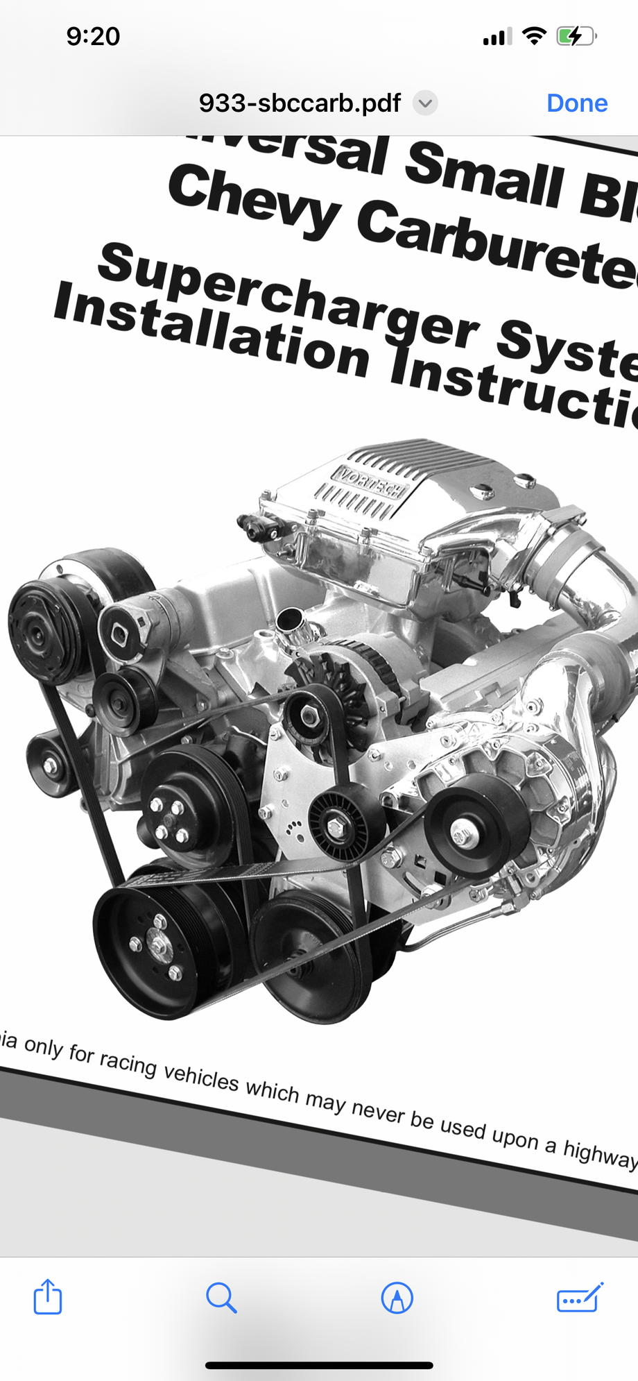

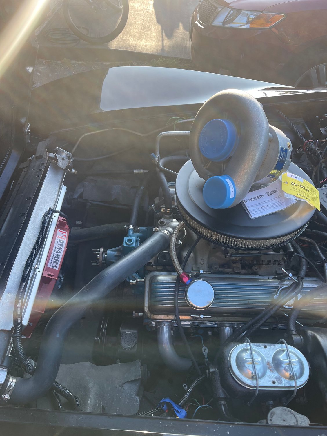

Tearing everything off the front of the engine to start. Swapping to a serpentine setup. Vortech doesn’t make a bolt on kit for the C3, so having to improvise/fab some of it. A few things will have to be clearanced. The factory hood will NOT fit, so looking into an L88 hood a few inches higher than stock. Had to purchase various parts from other cars, like a Firebird ac/tensioner assembly, a different alternator, long water pump, crank pulley, etc. The factory power steering pump will work, just have to swap the pulley. Went with Vortech’s fuel pump and bypass valve. Only running 5psi to start. Will post more pics as this project progresses.

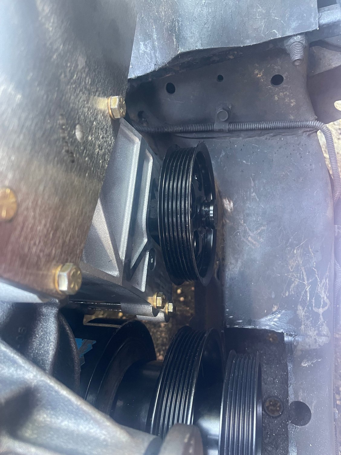

Making progress. Water pump on. Mocked up a few pulleys to check the alignment. So far so good.

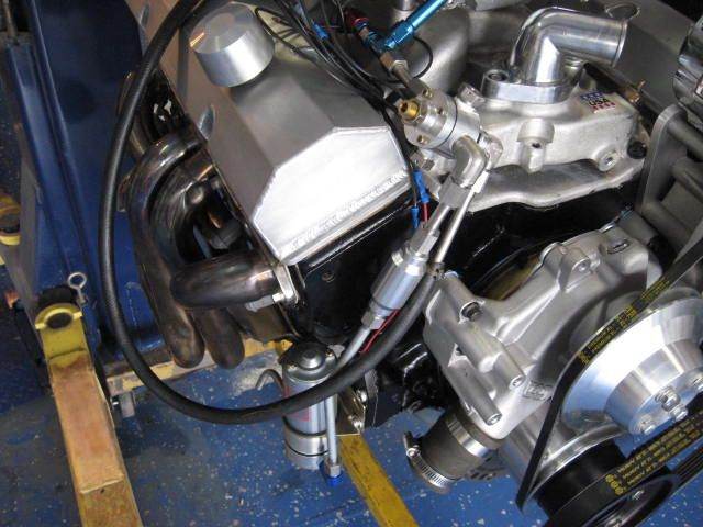

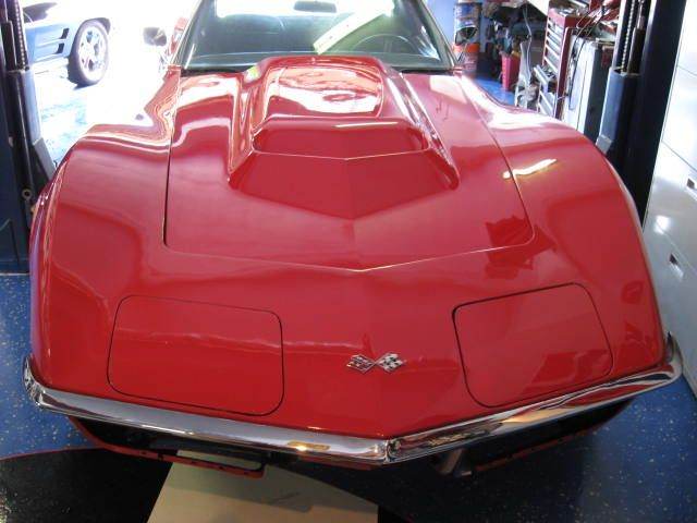

I had to build custom brackets to get the supercharger mounted low enough to clear the C3 hood:

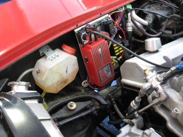

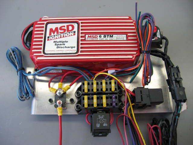

Boost-driven timing retard is imperative for proper max performance:

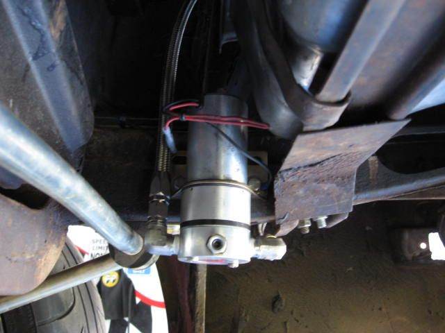

..and attention to fuel delivery pressure and volume is absolutely essential:

Very nice! I have a plan for the hood where the blower touches. Cutting both sides and adding vents to give it enough clearance.

I would not trust a msd btm boost retard on a expensive engine , I would put car on chassis dyno and find out what it likes wide open and lock it out or set up with around 16 to 20 initial and all in at 2500 rpm and with low compression you don't have to worry about hard starting .

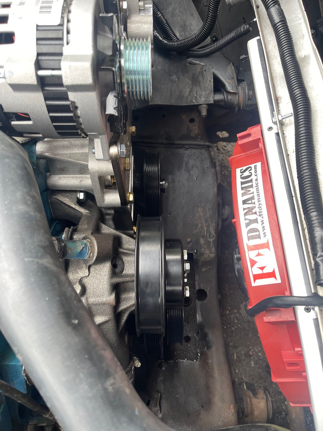

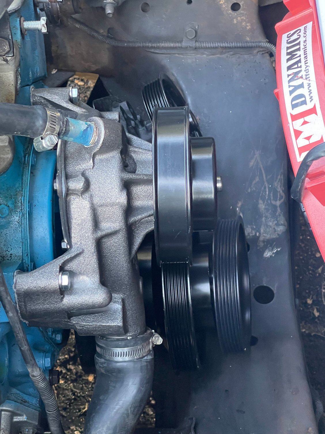

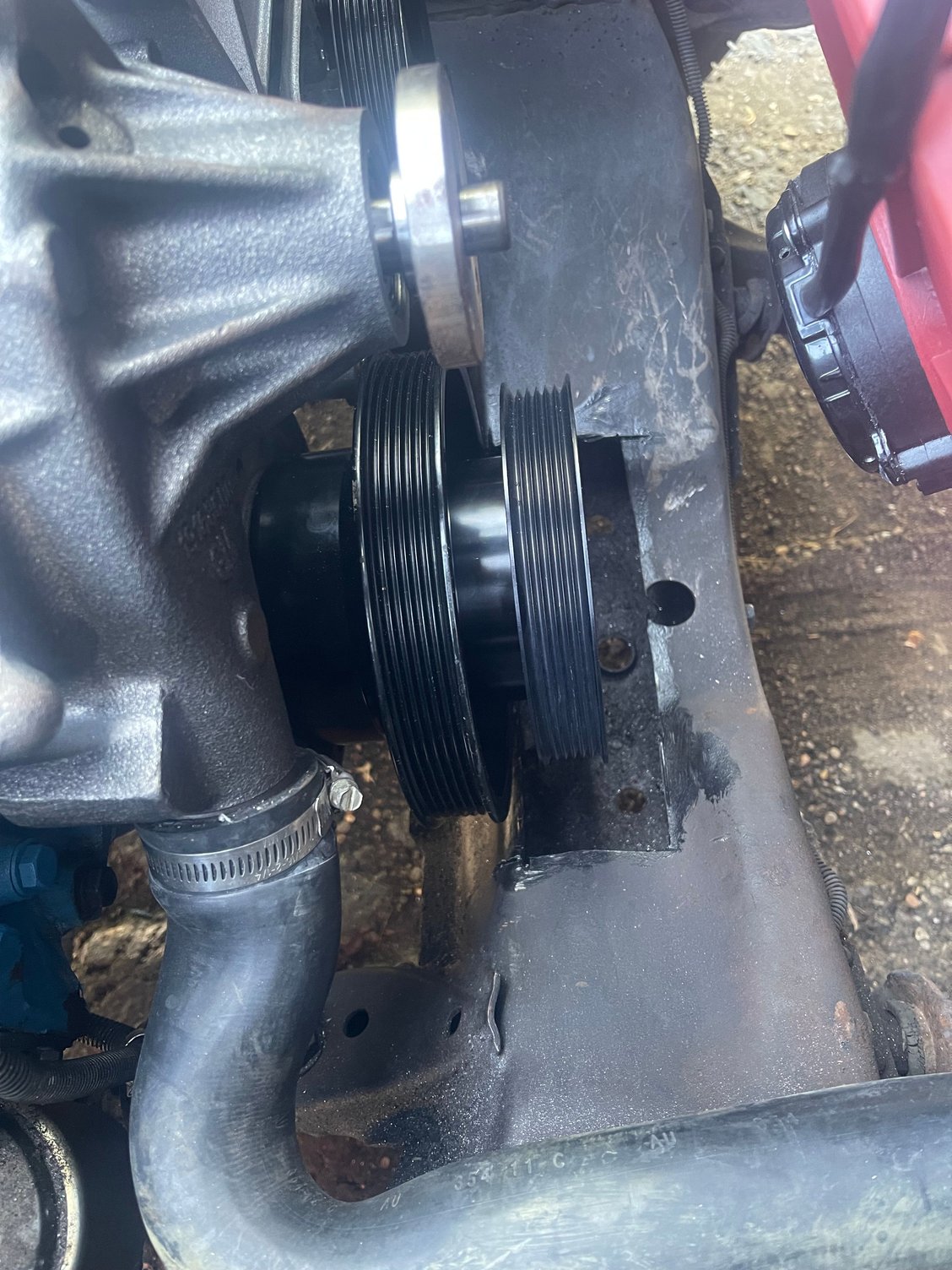

Making progress. Had to notch the K member for the pulleys. The p/s pump pulley has to be removed, then installed on the supercharger bracket, then reinstalled, then the bracket can be installed on the engine. Must be done in that order due to clearance. Thank you to nyciti for the help with the K member!

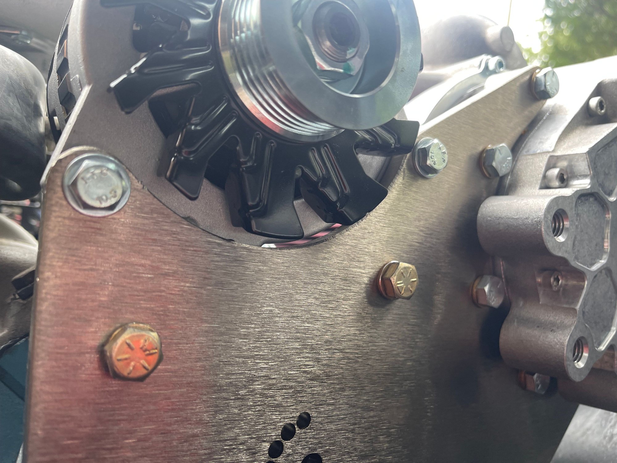

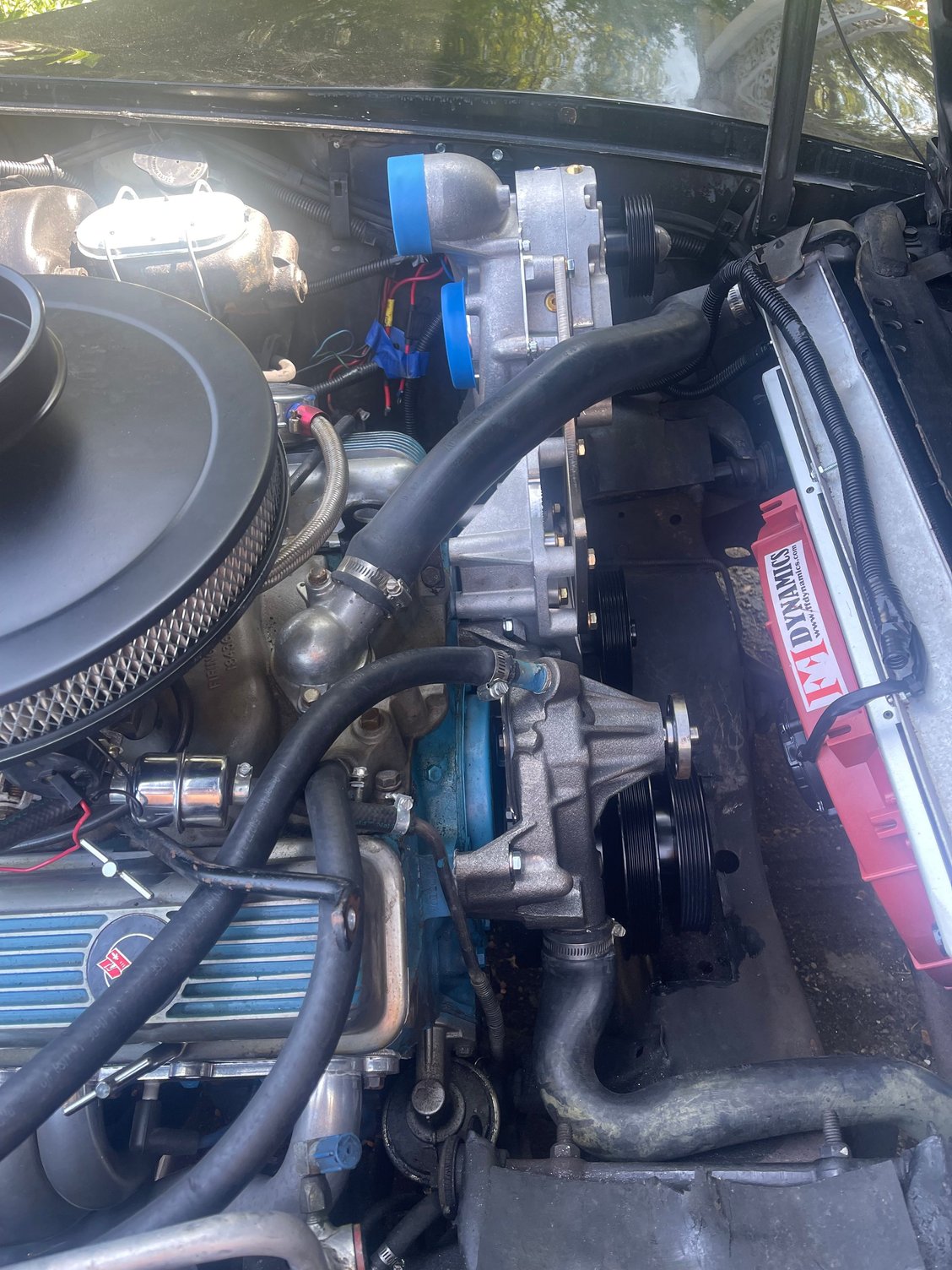

So everything lines up with the exception of the alternator, which sits 1/2” too far back. The span on the mounting bolts is 5 1/4”. Any ideas here?
