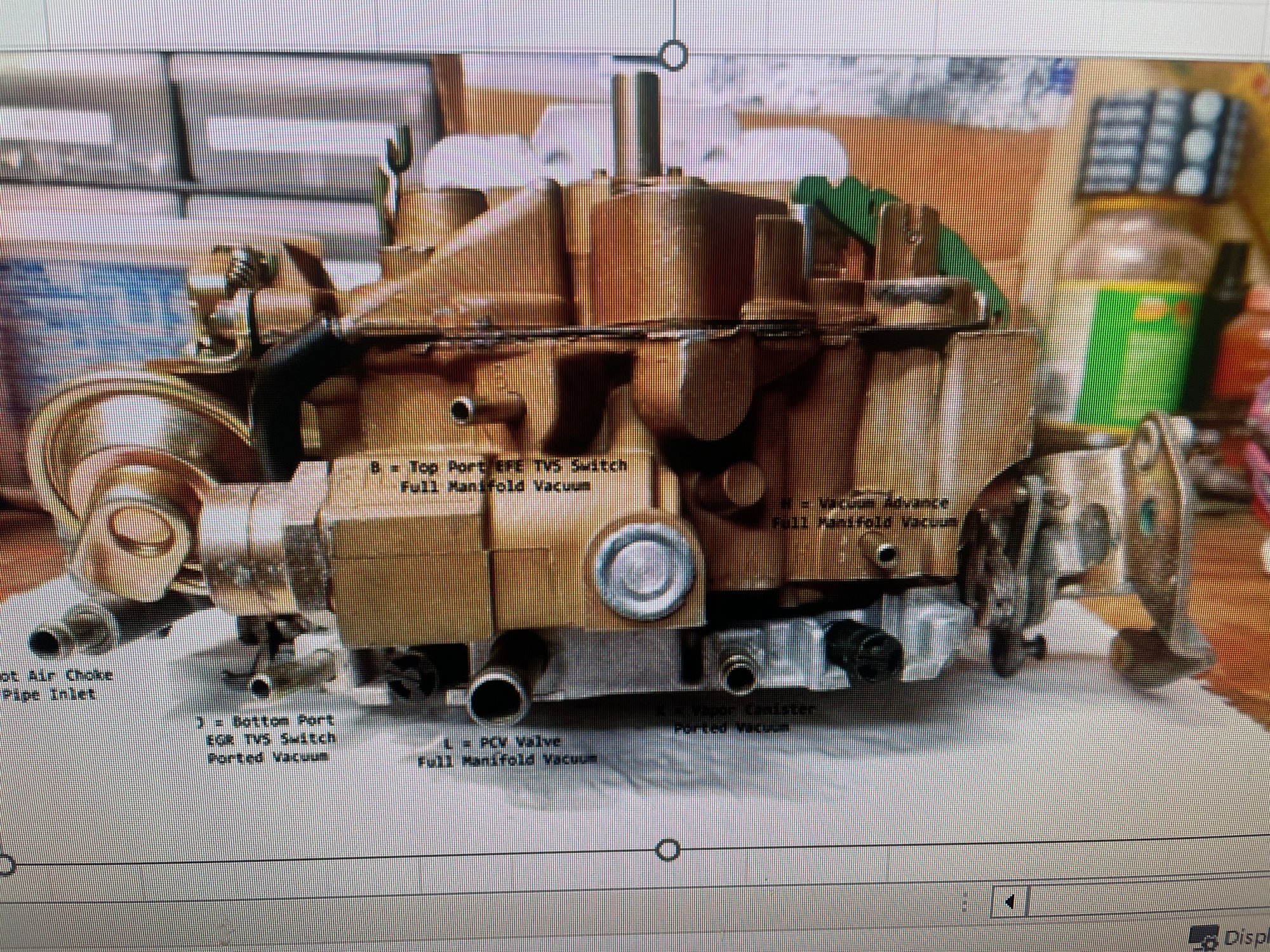

Hey guys, I know the vacuum advance should be ported and not to manifold. Below is an old thread regarding the water neck vacuum. If I bypass the water neck and go directly to the carb isn’t the lower connection considered “ported” and not manifold vacuum?

First - thanks for the quick reply. The port vs manifold seems to be up for debate. I use to think manifold, then ported, and now going back to full mani in the carb. I bypassed the tvs on the water neck. I have only 1 left that goes from the b location top left that goes to a component on the intake that is wired green and tan. What’s that ?

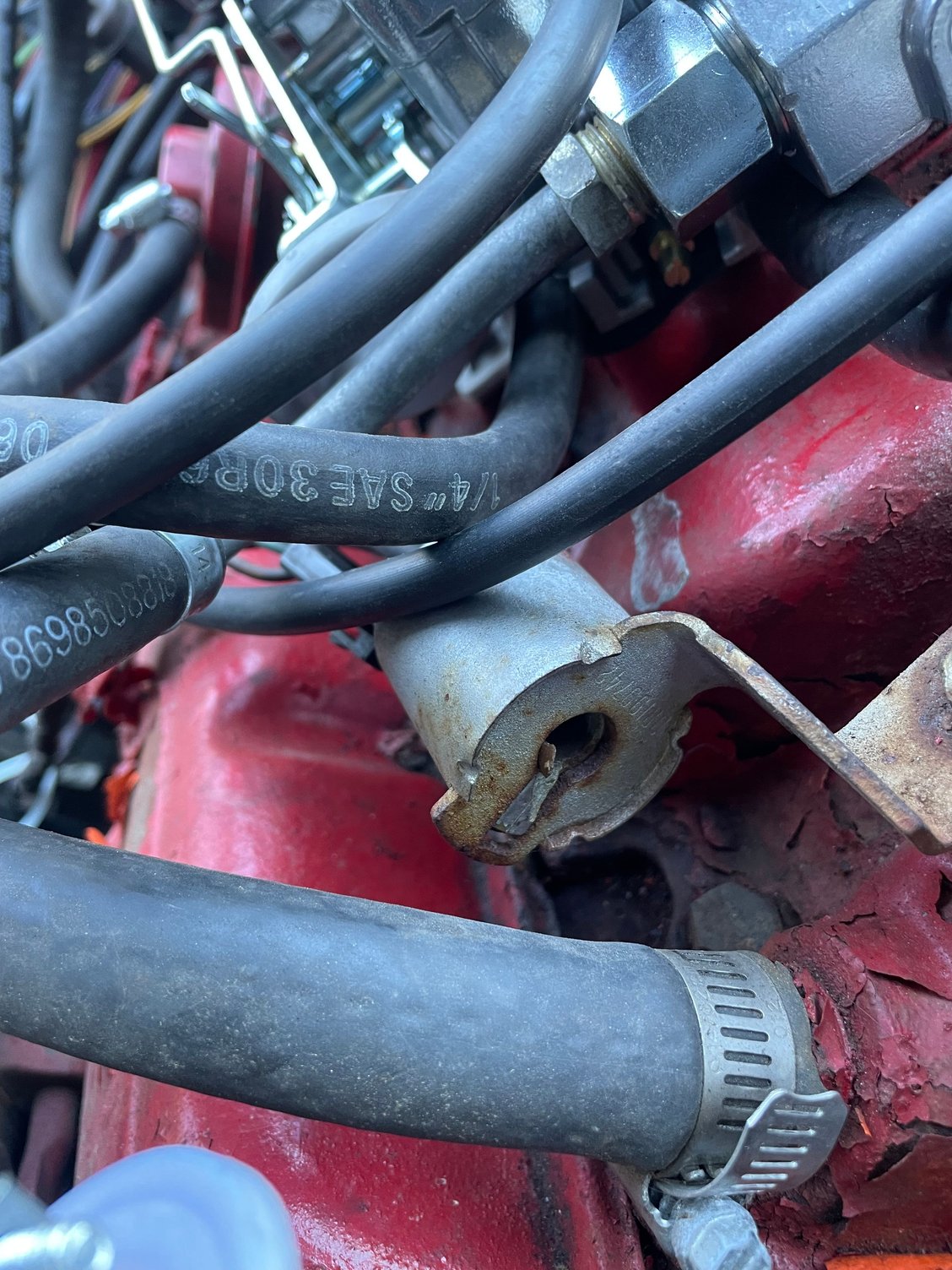

Bike space - looks to be the TCS solenoid. I ‘m going to delete it and see what happens, every time I turn the headlights on she starts to stall out. Must be a vacuum leak somewhere.
Old Aug 31, 2023 | 11:14 PM
gaboriar's Avatar
gaboriar
Joined: May 2020
Posts: 88
From: New England
Holy crap I think I found my leak. Didn’t realize it until I relooked at my picture. The facing part of that component should have a vacuum tee. It’s completely missing. Thinking when the headlights turn on its drawing more vacuum in the whole sys and that leak is the culprit. It’s wide ope
n

This is why we always ask for photos!
Is there a vacuum hose leading to the other end of the TCS solenoid?
Old Aug 31, 2023 | 11:29 PM
gaboriar's Avatar
gaboriar
Joined: May 2020
Posts: 88
From: New England
There won’t be in the morning. That is my problem (or part of it). The hose goes to the carb. Ported. Then the other side is just wide open as you can see. Will pull her and cap her at the carb.
