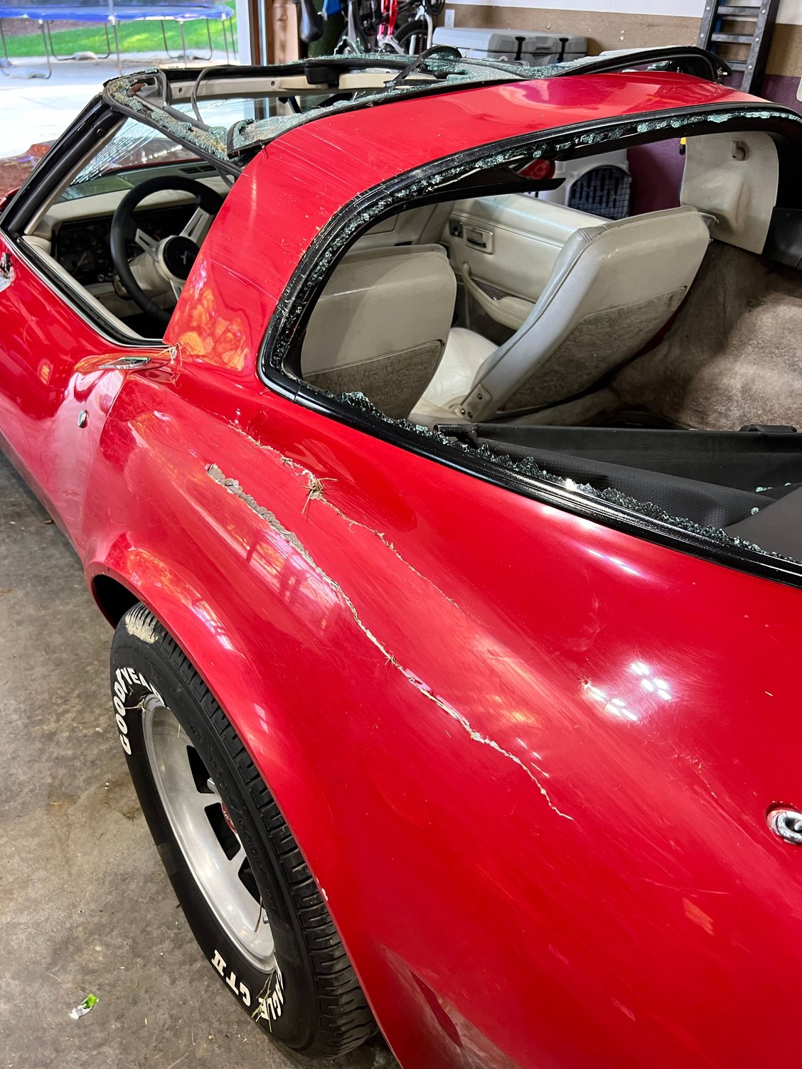

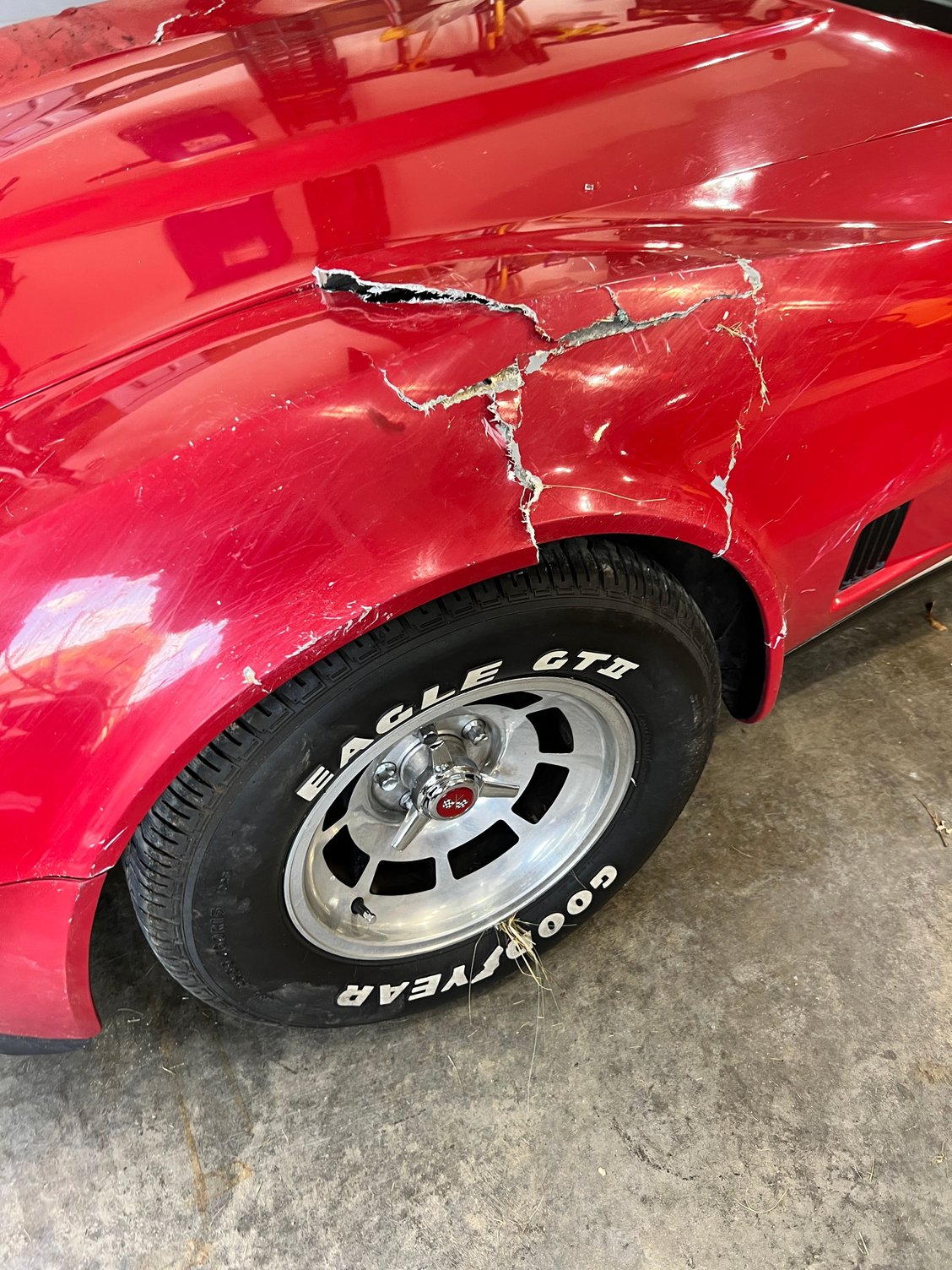

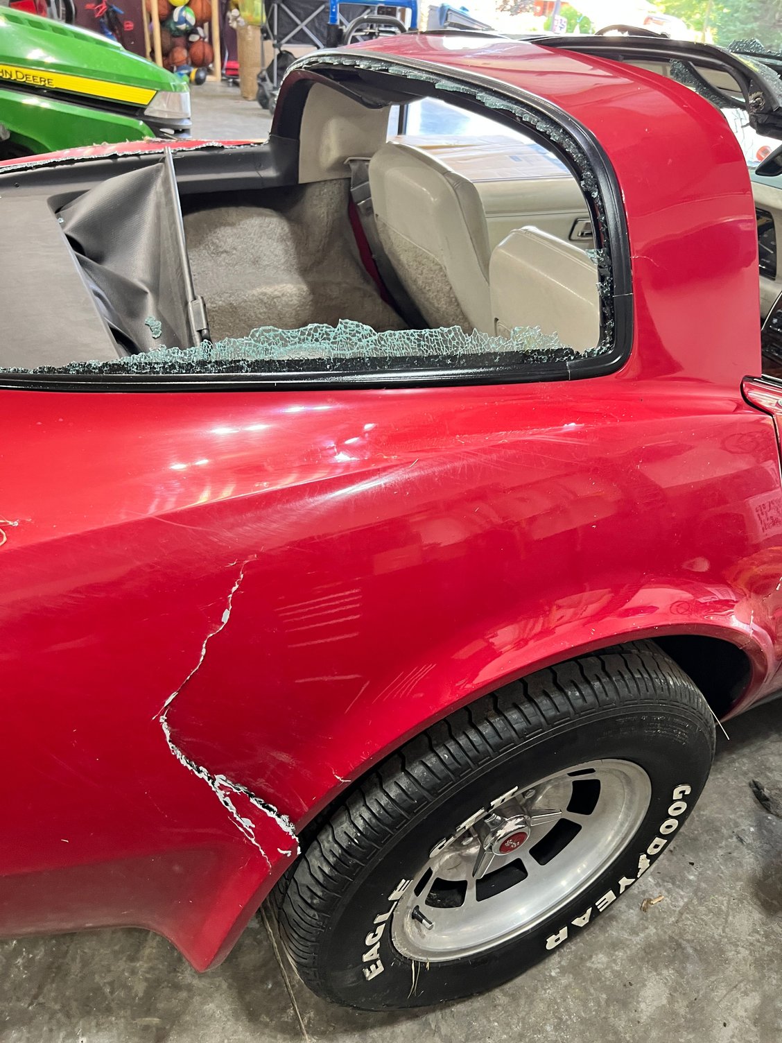

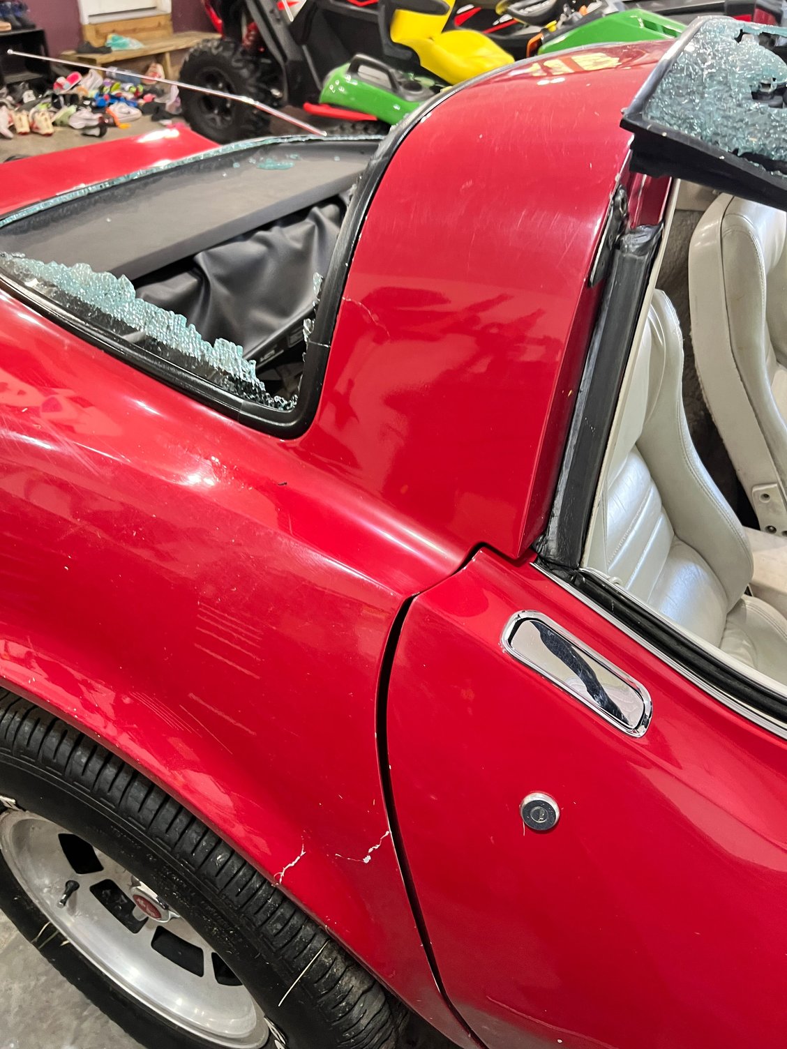

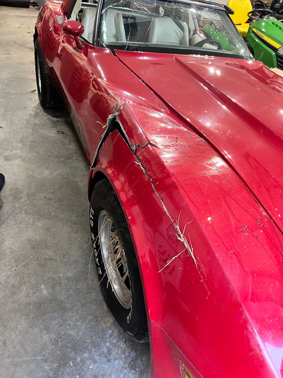

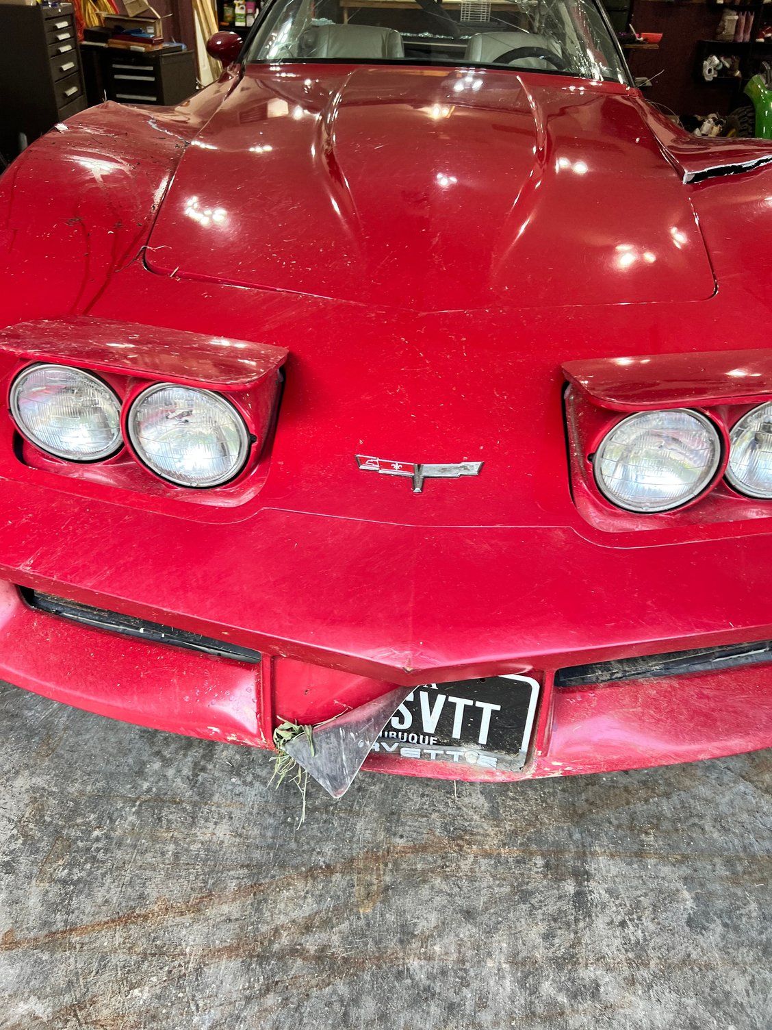

Guys!! Im in need of some major help. I rolled my late fathers 1980 Corvette and damaged the body really bad. What options do I have to get this rebuilt without it costing me 10x what the car is worth?? Any help would be appreciated. This car has a lot of sentimental value to me but I also don’t want to stick $20k into it. Thanks!!

If you went into a ditch, the frame is likely bent, as well as all the broken body panels you see.
It's worth more in parts.

I believe the frame is obviously tweaked, but not horribly.
I see a broken windshield and have to believe the w/s corner is bent down. The right rear door edge does not align. And the left front door gap is too large. Mine was bent under the front bumper upward about an inch, after landing in a ditch, like it had been given an uppercut punch.
It can be straightened on a frame rack. Your challenge will be finding one that will work on these old antiques.
I had mine straightened for $400. I had to give him the frame specification sheet, it wasn't in his machines computer.
The whole front clip "pops off" and glues on if you are not afraid of fiberglass. Easier to fix than a metal car, at home, no welding, just gluing. An entire front clip can be had brand new for 2500 ish. Just glue it on. Eazy-peazy LOL! (Just grab a broken fender piece and pull hard with your bare hands and that will give you an idea of how easy it comes apart). You certainly can't hurt it anymore.
Seriously if you want to dive into it and do the work yourself I say it could be saved, but for sentimental value, not for any value the car has. Take the $14k, add another $6k, and that will get you pretty far along. But you are basically looking at a long repair job. FYI I am budgeting 45K in parts for my frame off restoration project, and mine is a complete nut and bolt restore and frame-off, including a 13k engine, Tremec and Vintage Air, but I am doing 95% of it myself. You could easily spend 20k. Maybe more.
