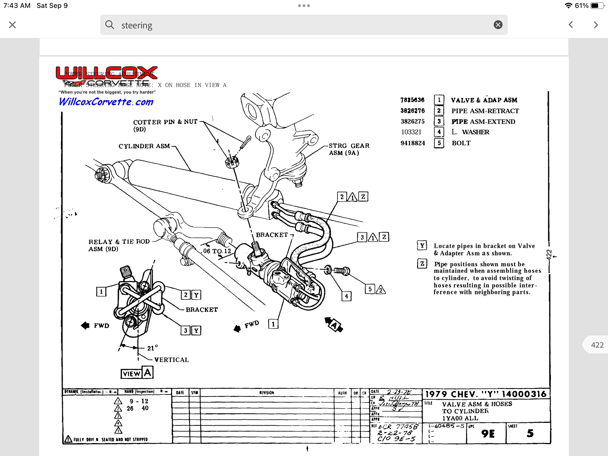

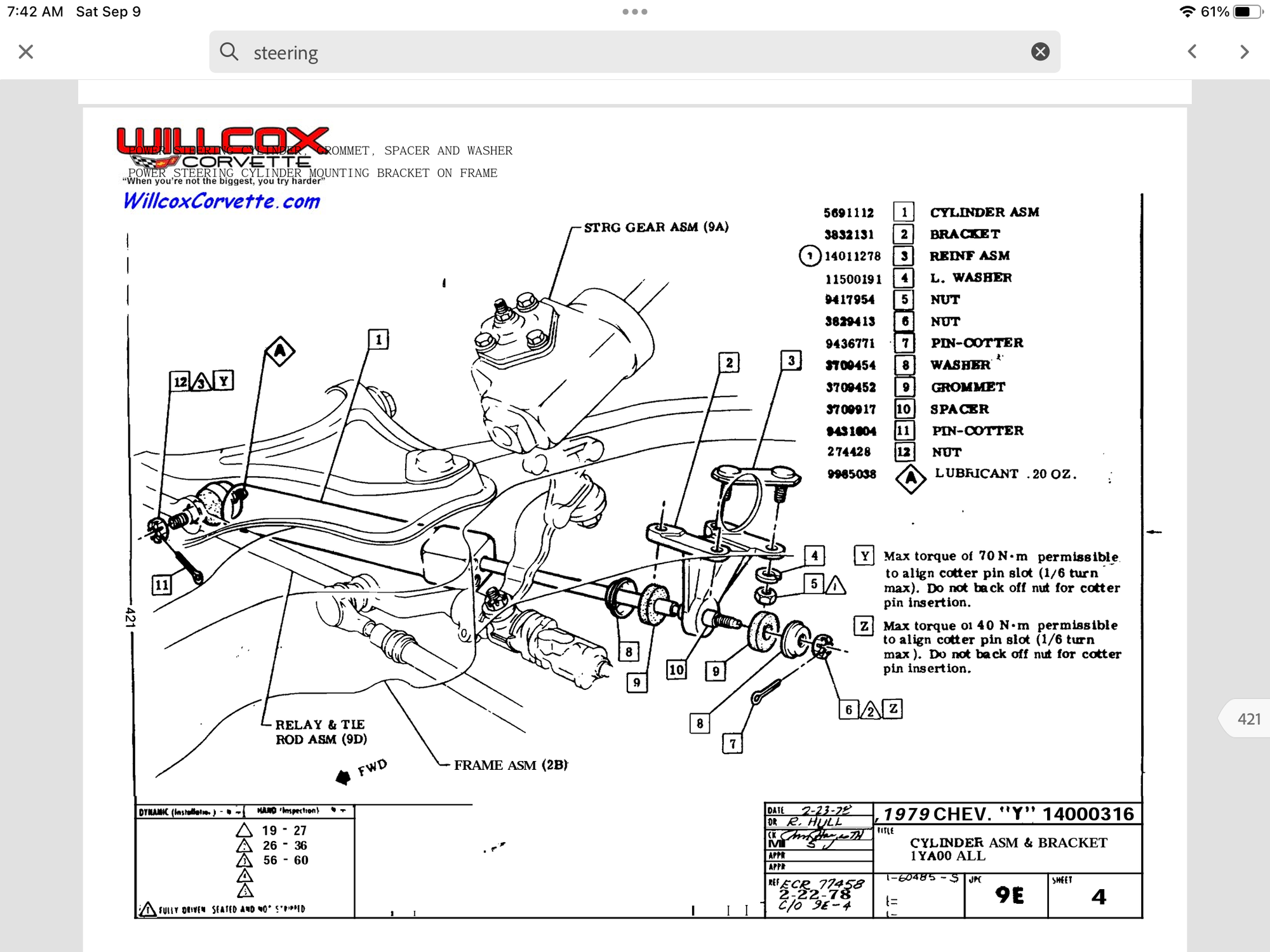

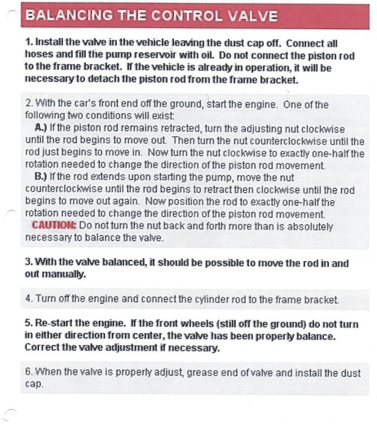

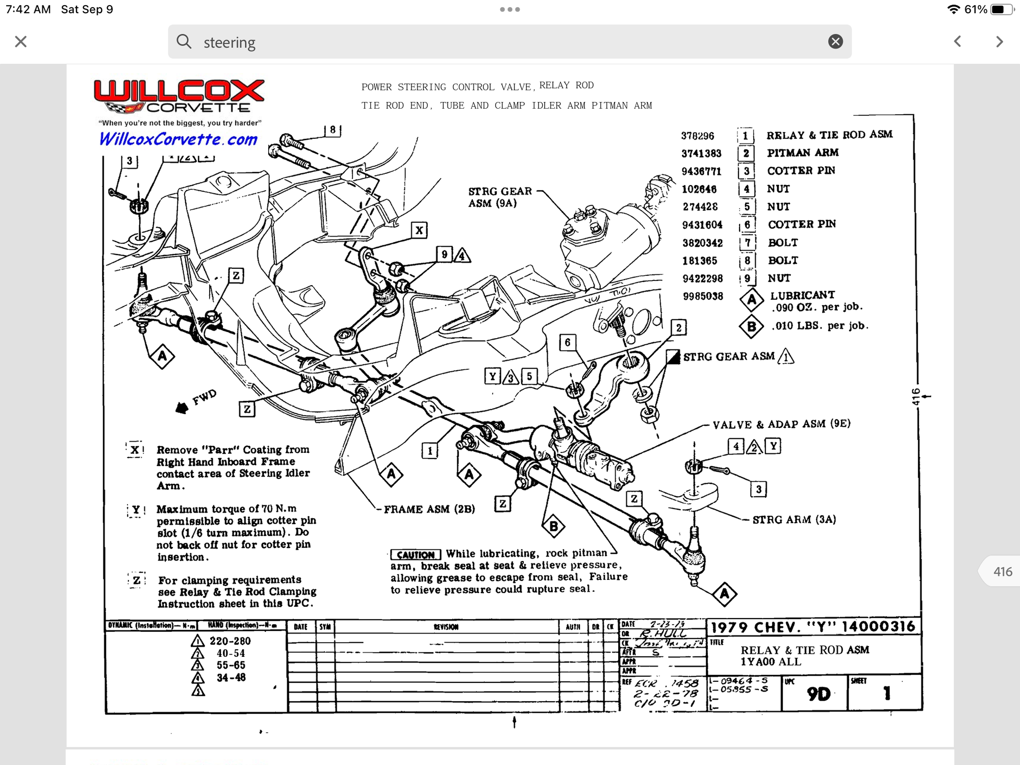

The steering control valve needs to be centered.
Do you have a shop manual? The procedure is in there.

you could try to adjust valve as mentioned.
put front tires in air and adjust, and or remove ram to find neutral..be careful though..i would try in that order and see what that does.

Adjustment instructions start at 6:23

First cycle your steering full left and full right 15 times each side, if there is air in the system that will cycle it out. Then do the centering procedure

I just overhauled my power steering. I used the ram to circulate the air out of the system. Just hand pushed the piston in and out slowly a bunch of times until the air stopped making noise. Put the rod back in the bushings/ bracket and fired it up. Time to balance valve took maybe 1-2 minutes max. Done.

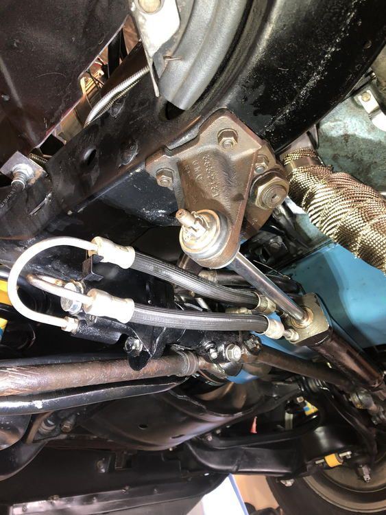

Need some trouble-shooting help with my 76':
1. I finally, after months on jack-stands, finished the front suspension, tie-rods, and new PSCV and damper. I just got it back from the alignment shop and it drives straight!!
2. When I turn it, there is about 2-3 inches of turn of the steering wheel before the wheels move. Then it seems to oversteer beyond what I put in to the steering wheel.
3. The steering or "power-steering" seems a bit tight.
Any recommendations on what I need to do? I used the C&S video above and basically followed the wwii chart above. BUT, getting the rod in a position to put it back in the bracket was really hard. I was adjusting the nut until the rod moved toward the bracket.

Anyway, in your case the most likely culprits of your steering play are:
- rag joint
- steering gear box
- PSCV
Its probably from the gear box or rag joint but I also have had issues with crappy PSCVs new from the box.
To diag, put your eyes on the rag joint and gear box and have someone move the wheel back and forth. Should see where the play is coming from.
If it’s the gear box send it to GTR1999. He is the best hands down.
