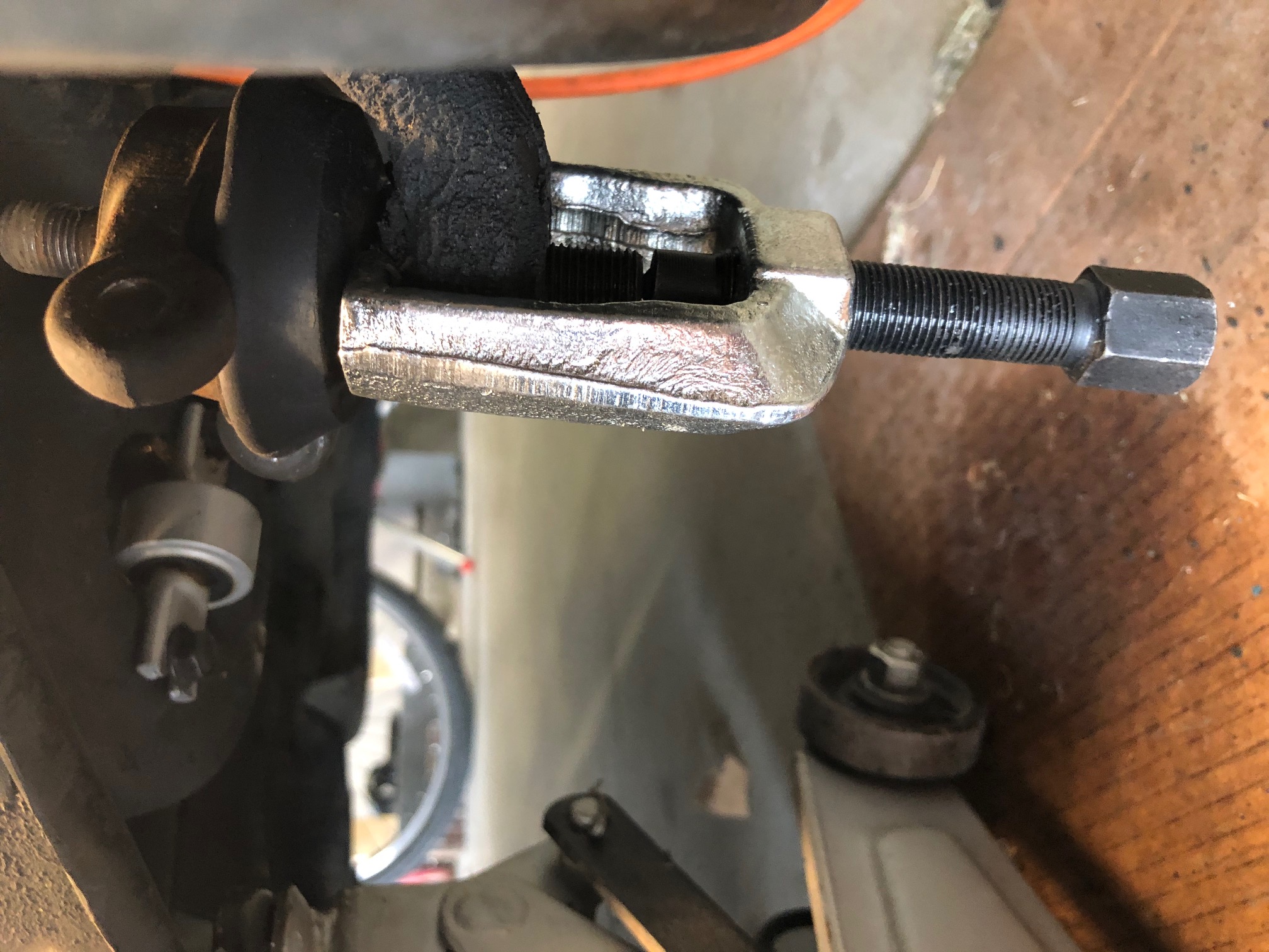

I have everything out or loose other than spindle on bottom,how do you get it off,does the spindle can beat off,I see two round head bolts,but like I said round on both sides,here’s pictures.

Unbolt the two bolts and use a puller to remove the ball joint.

Thanks,and I’m assuming it’s easier to pull it off now while it’s still bolted up top,thanks again.

Those are rivets on the ball joint holding it into the A-arm. That’s how they came from the factory. You will have to cut the heads of those rivets if you want to replace the ball joint.
Replacement ball joints should come with the bolts that replace the rivets.

If you just want to remove the spindle ,whack the spindle with a heavy ball peen hammer where the ball joint stud comes through. It’ll crack it loose from the taper fit. Put the ball joint nut back on a few threads first though so the spindle doesn’t come crashing off.

Thanks,got it finally.and not planning on replacing that,but cutting off bolts is my specialty.

2 different issues here,you're only cutting off the rivets if you're replacing the ball joint,all you want to do here is break loose the ball joint from the spindle. As stated it's held in with a tapered shaft,all that's holding it on is the fit.

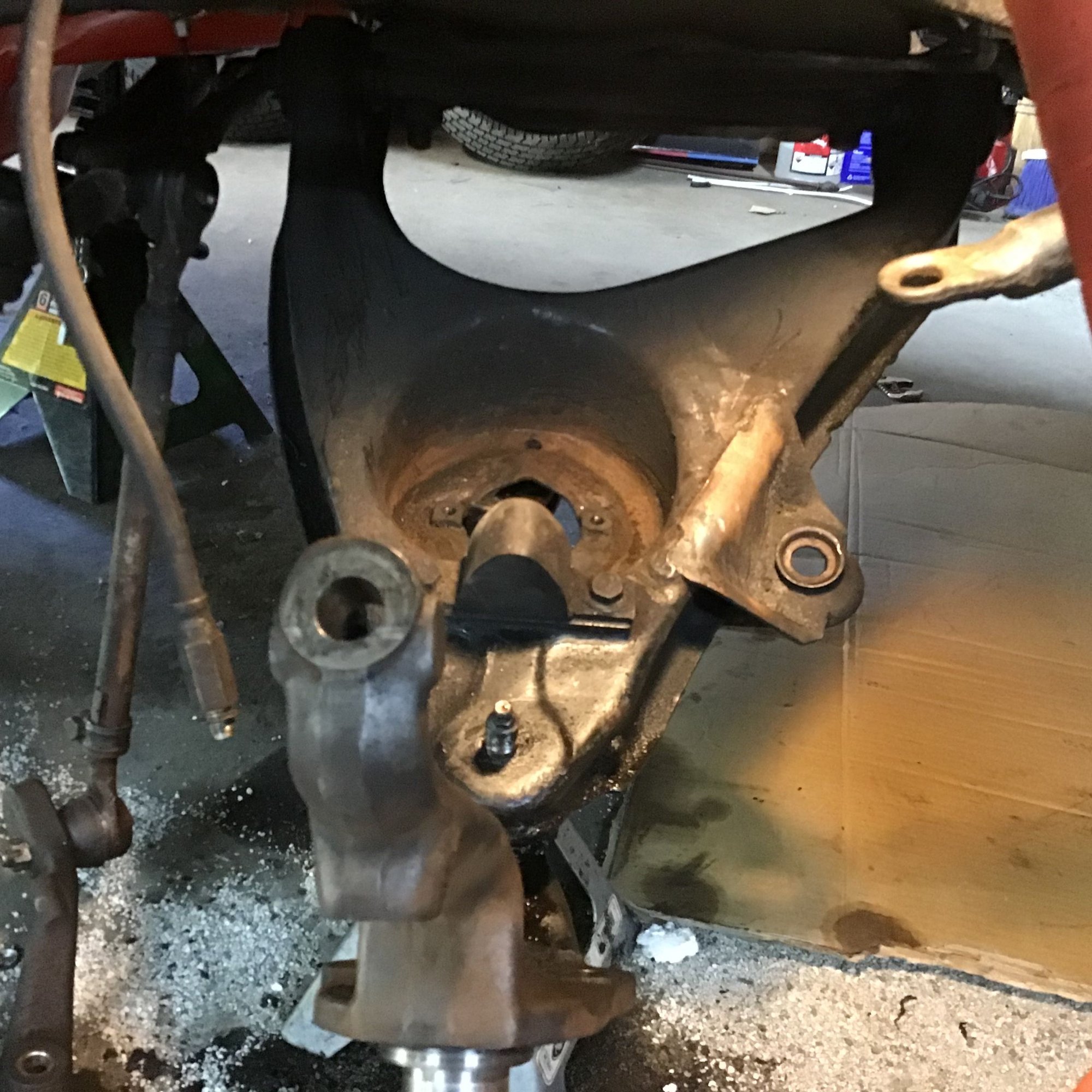

Ok,now I need help,I borrowed some type tool,but think it’s more for ball joints than bushings,but would work except for getting this cross bar out first,does it have to come out one way or the other,or doesn’t matter,does it have to be pressed out.I can get the bushings out with this tool,but the cross bar is in my way. Th

I just did mine the other day. Used an air chisel to work the bushings out from the lip on the outside with the arm in a vice. It's not going to be easy, they are pressed in there pretty good. If you try and use a hammer by hand you will be there for a year. Once you get one side out, the bar will slip out and then you can work on the other side.
I also watched a YouTube video where they burnt the rubbers out and worked them that way, but I chose the air chisel.

When I did mine I used the air chisel also but first I drilled out all of the rubber bushings with a few HF throw away drill bits till the rubber was all out.
If the arms are in good shape no need to replace them, just rebuild.
