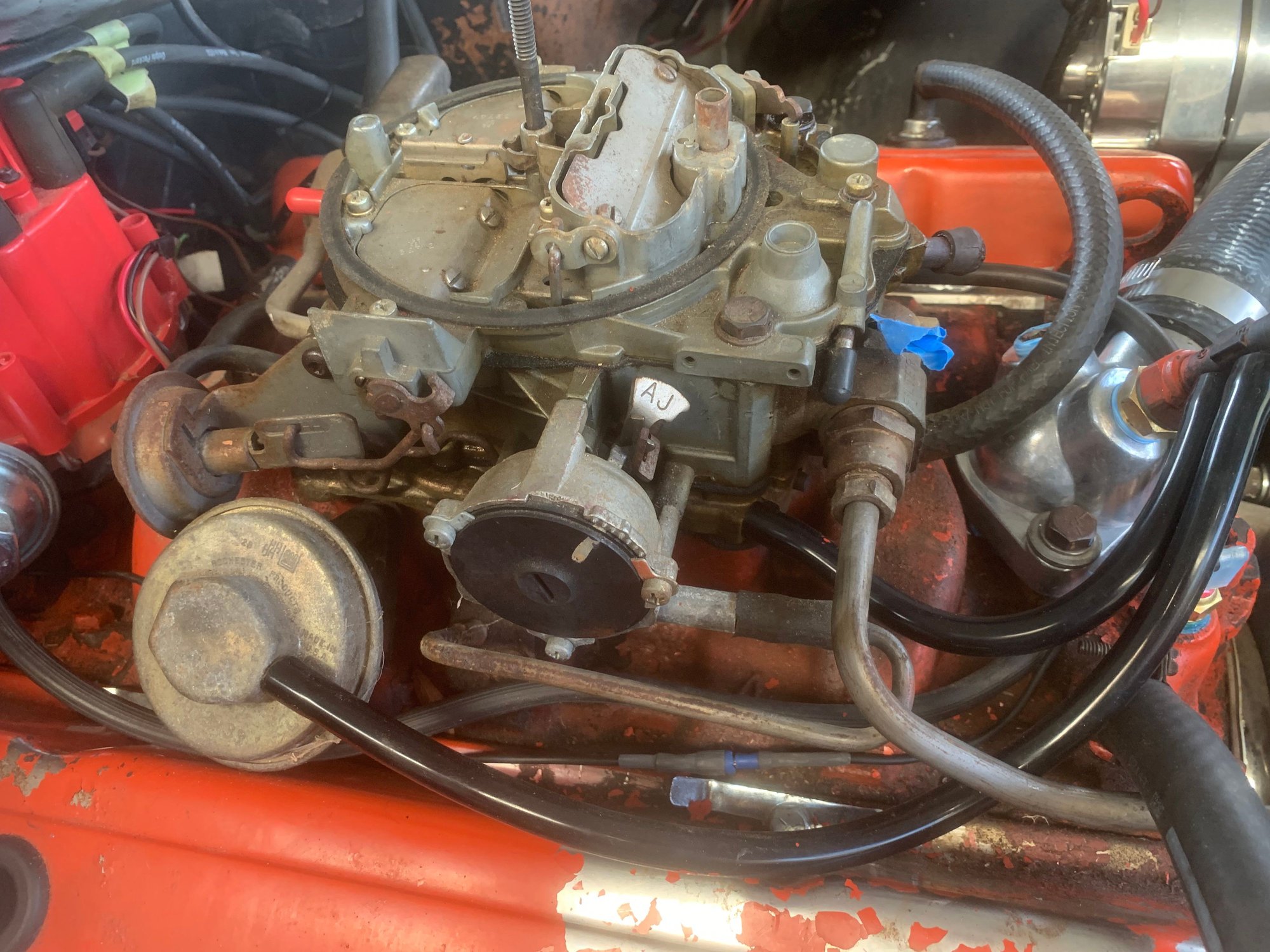

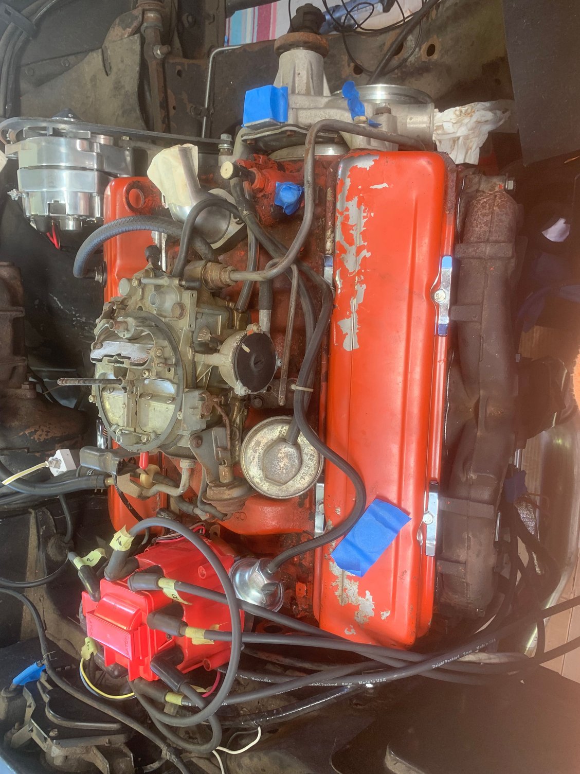

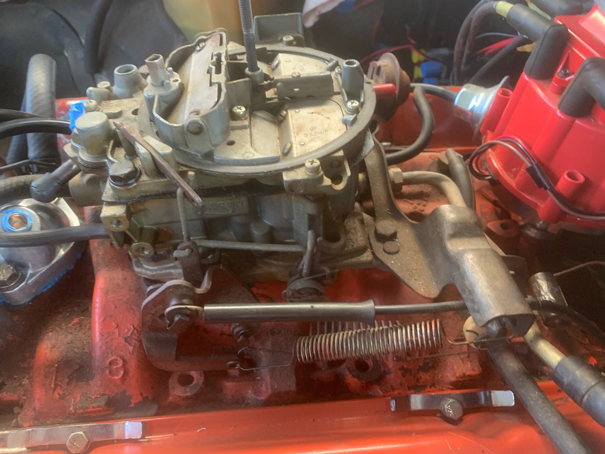

[QUOTE=Bikespace
If not a video, can you post some photos from all sides with the air cleaner assembly removed? [/QUOTE]
Please note this is a work-in-progress where I have no guide other than here. If you see something I should change, please let me know.
I needed the port for the Thermo-Vacuum switch for the electric fan setup, so I moved that TVS to a threaded water neck.
I plugged the Vacuum Advance into a port on the drivers side front of the carb - I think it is manifold vacuum.

I am not the carb guy BUT
I don't see the rear upper choke tube connected.
That little metal tube runs from the front of the choke to a plate in the intake. The tube from the intake to the rear of the carb is missing. Thus, I am sucking in-filtered air into the choke/carb. I am trying to source the back half of the tube. However, the choke tube is connected to the manifold.

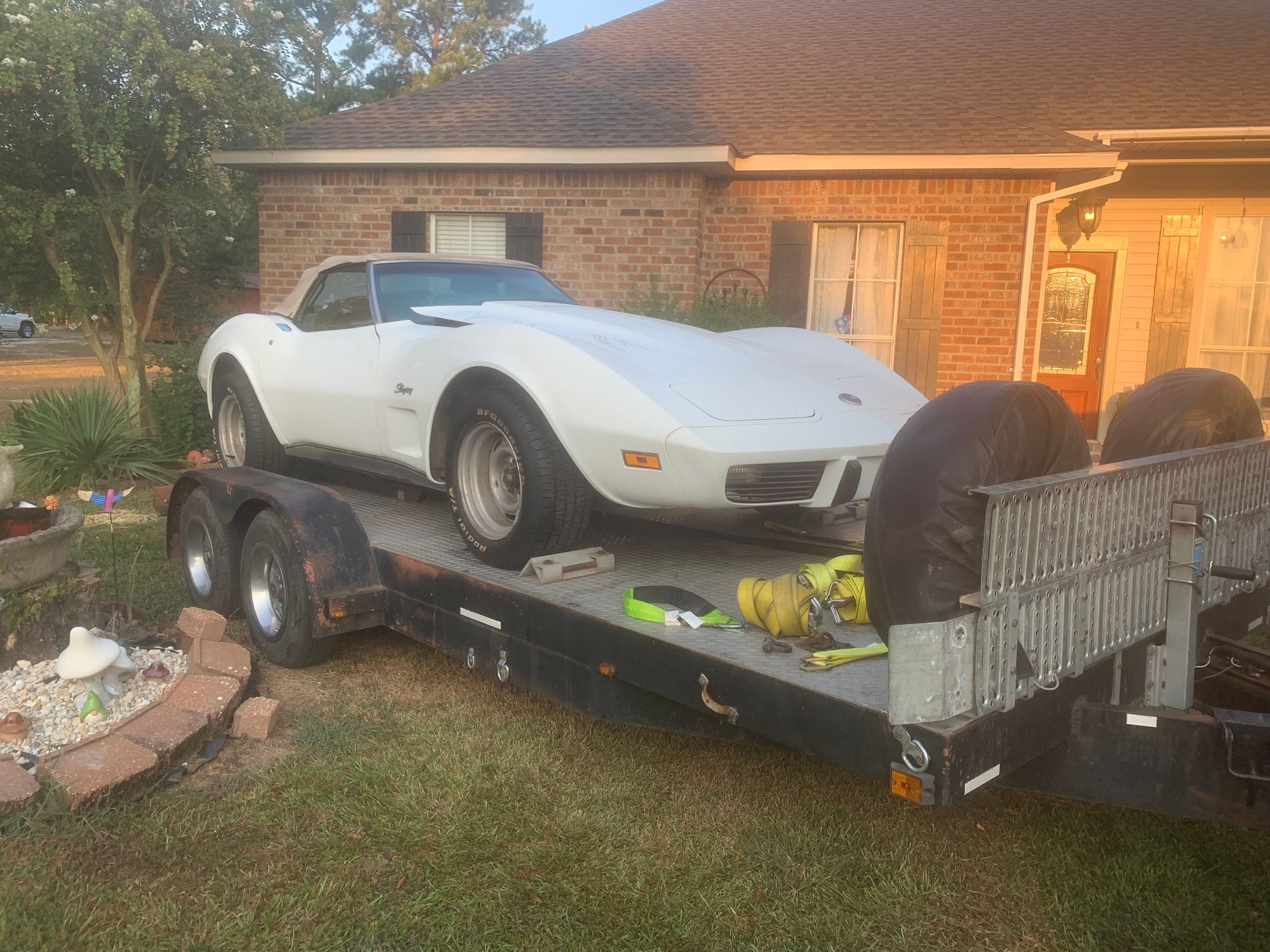

Pic when I got her home a month ago. In a thousand pieces and sitting for three years…
