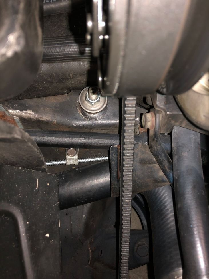

Vintage Air came through and sent the right bracket, free of charge. Now I'm having some issues getting the right belt length. I finally found one that is 60" long, but it is about .25" from hitting the lower radiator hose. I will try to find one that is a little shorter, but wanted to ask it if it necessary to route the house over the balancer pulley or just the water pump? It would help if I could just go around the water pump, so I'm far away from that lower hose. Otherwise, I'll keep searching. Napa was either too long or too short. Similar issue with AutoZone, although I did find the one I currently have on it.

On mine, the belt came too close to the hose, so I cut the mounting ear off the back of the compressor so I could use a shorter hose. It is hard to see on your pictures if this is an option for you. Jerry
Thanks
Keith
I had the same issue when I installed my VA kit. After researching, I discovered many factory cars had the same issue and some came with a shield for the lower hose. I found a diagram of that shield and fabricated one to match. You definitely want to do this if the distance remains close because as the belt stretches it will hit the hose for sure. Mine would eventually stretch enough to make a ticking sound as it slapped against the shield. I eventually found a slightly shorter belt that required me to remove the AC compressor to install. That helped some but even then, once that belt stretched enough, it would touch the shield on occasion.

Funny you suggested this. I created a temporary shield but don’t trust it. Maybe I can find a shorter belt.

Thanks. Looks like a common enough issue that I need to just fab a shield. I currently used an old car tag to create a wrap around the hose that is held on with zip ties. Temp fix to make sure the system is working. Now I need to find some thicker metal to fab a bracket.

My belt is over an inch away from the radiator hose. It is closer to the control arm shaft so there is no way it would hit the hose.
