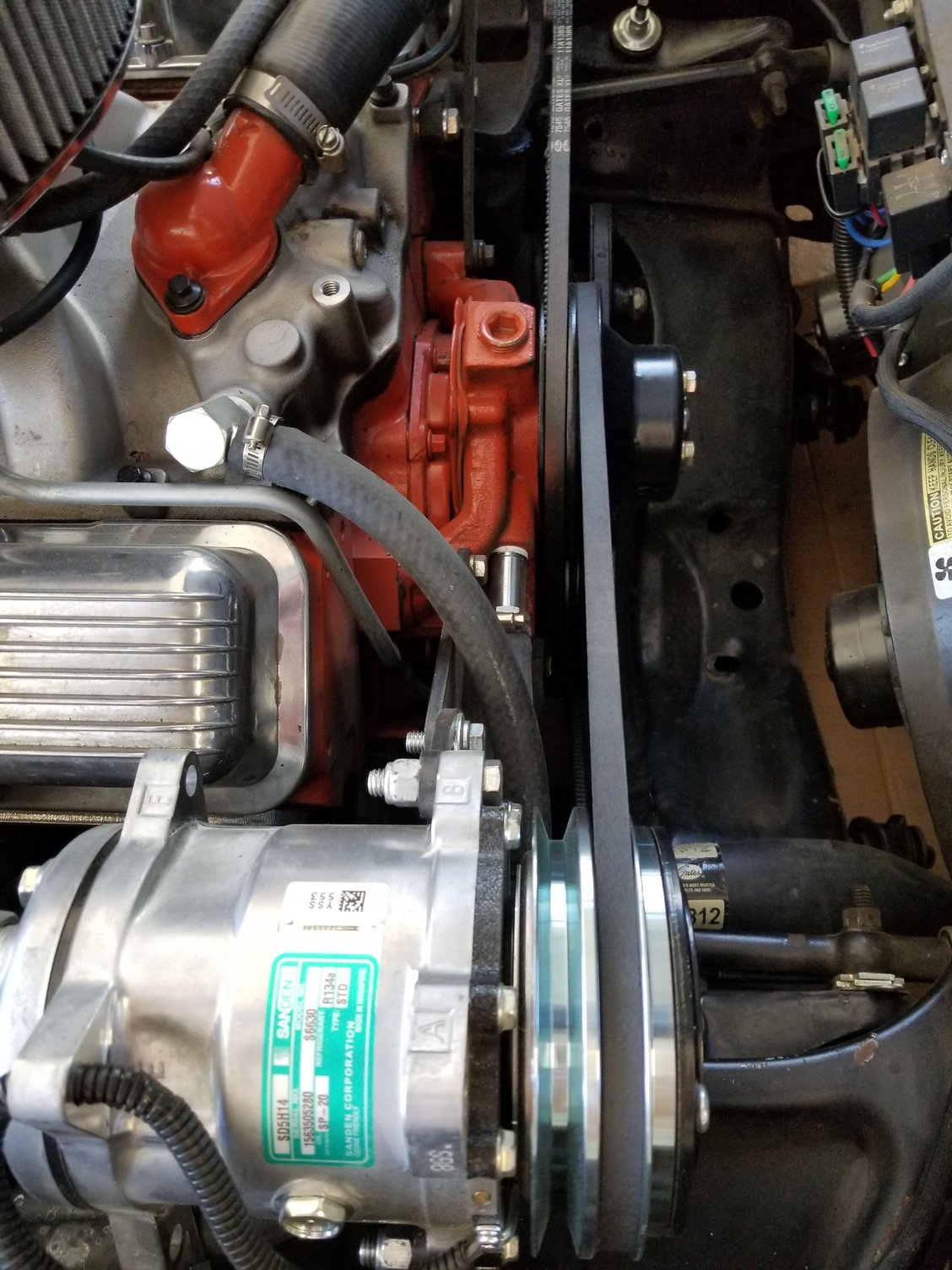

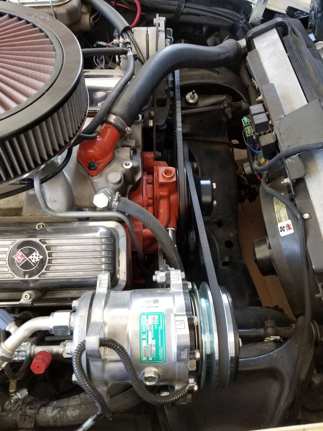

I have a ‘72 with a 350 engine and having issues with installing the compressor. I have the brackets installed, but the compressor is sitting too far back to connect to the water pump and for the belt to align. Surely I’m doing something wrong. Of course I’m trying to complete this project today and Vintage Air isn’t open to get assistance. I thought I would ask you guys to see if anyone with a Vintage Air install can help. Here are a couple photos to show the issue.

Those brackets look almost exactly the same as the brackets for my Sanden aftermarket a/c compressor. Since I wanted to use the forward-most pulley (former smog pump use) I ended up modifying the horizontal bracket to shift the compressor forward and then added a spacer in front to shim it to the appropriate position.
Your alignment does NOT look terribly off..... can you place a straight-edge from compressor pulley groove to water pump pulley groove for a better perspective and show us a picture?
BUT - anyway, if you are willing to modify the bracket it is really quite easy to do..... but make sure you have to first. If you want more hints just ask.

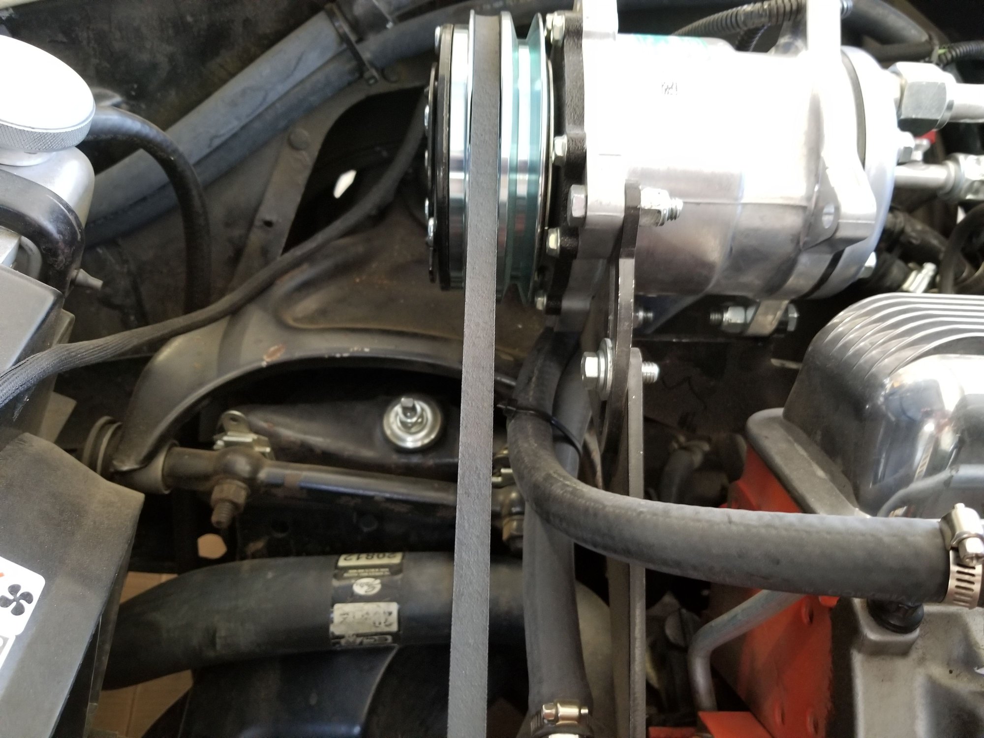

I wouldn’t expect to need to modify the bracket, as I ordered a kit for this exact application. Here are so photos with a straight edge.

It should line up if you bolt it on to the water pump. You don't have it bolted on in the picture.

I ordered the correct kit. I’m pretty sure the water pump is correct, but even if it isn’t, the compressor needs to com forward to line up with the belts.
the reason I don’t have it bolted to the water pump is because it doesn’t line up. Needs to move forward 3/4” or so.

It looks like you might have the wrong bottom bracket or have it mounted wrong. I have the exact same setup and the rear upper mounting tab should line up with the front of the valve cover. In your pic I see a spacer or something between the mounting tabs. Mine doesnt do that. The lower bracket should be mounted to the bottom mounting tabs. And the front grove on the pump should line up with the front grove of the pulley.

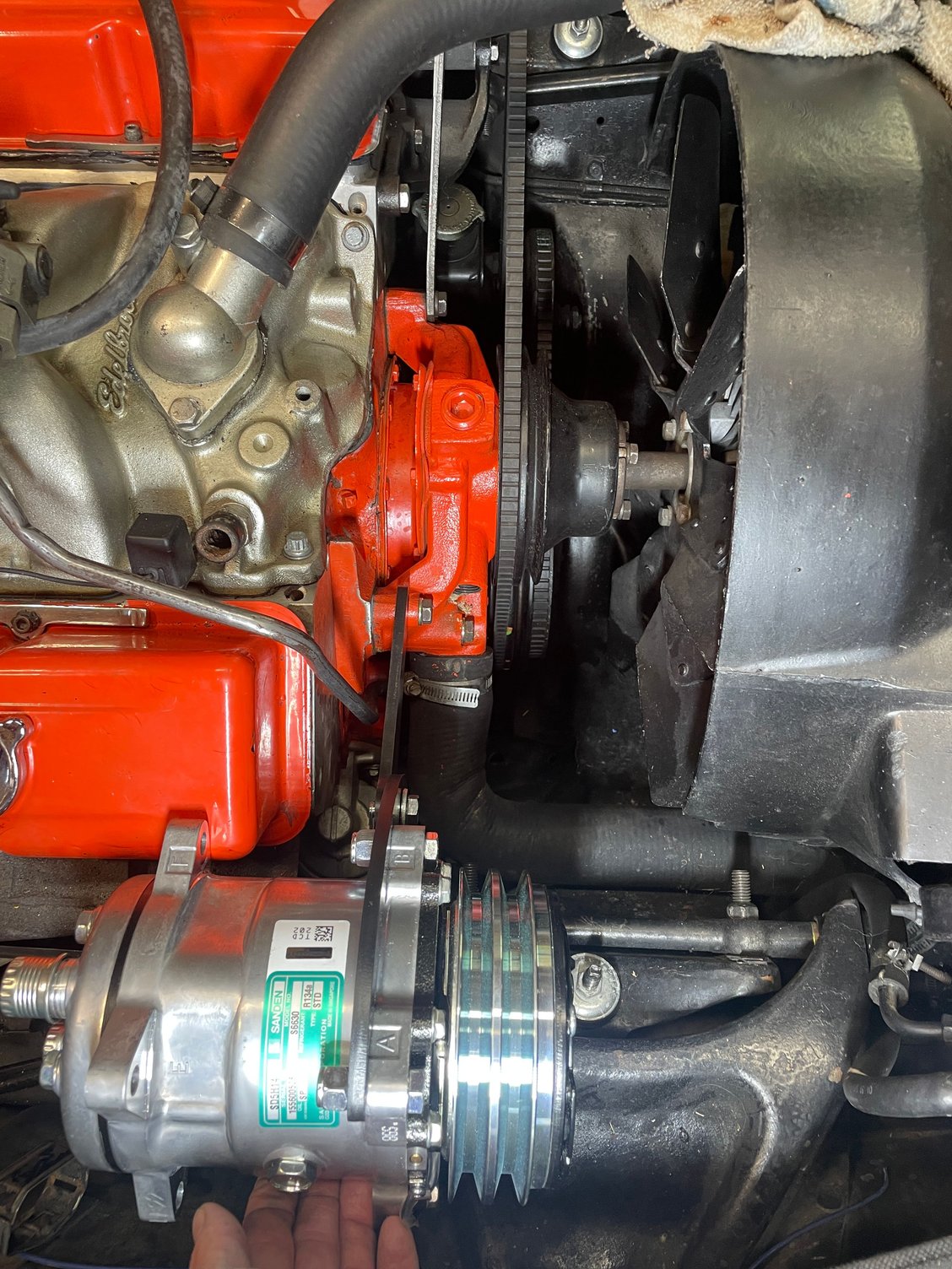

Is there any chance you could take a photo for me?
Keith

here ya go. I think you may have the lower bracket for a short water pump

It does look like I have the long water pump but not when I measured it.
Am I wrong? Is this a long water pump?

It looks like a short one to me. On a long one there is a big gap between timing chain cover and the pump, enough to stick your fingers between it.
