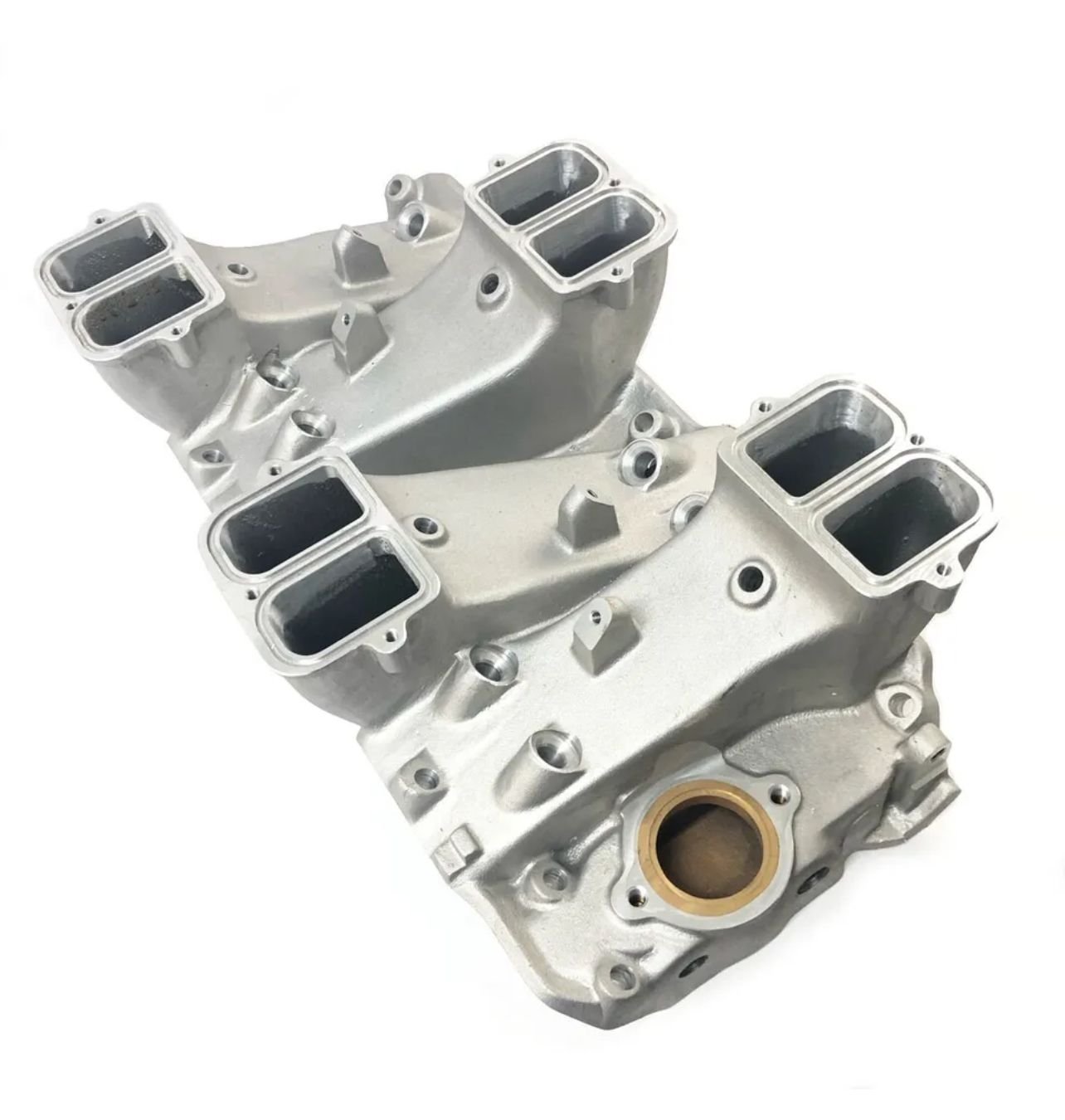

Per edelbrock, that pro-flow setup is 10” tall across. Haven’t measured anything yet, but that intake looks pretty tall to me, especially once you add TB and air intake hose, it probably gets worse. Now, I like the idea of getting air from under the windshield area. I’m planning to get rid of distributor anyway, I’d say there should be enough room where dizzy is to add a TB and some sort of fabrication for a small filter there.
there are 2 possibilities I’m interested in… either ramjet 502 lower plenum or mercruiser crossram lower plenum to fabricate something to cover it. Not sure how it’ll perform. Just an idea. Especially mercruiser plenum interests me, as it has more runner length, but looks somewhat tall also already. What you think…
