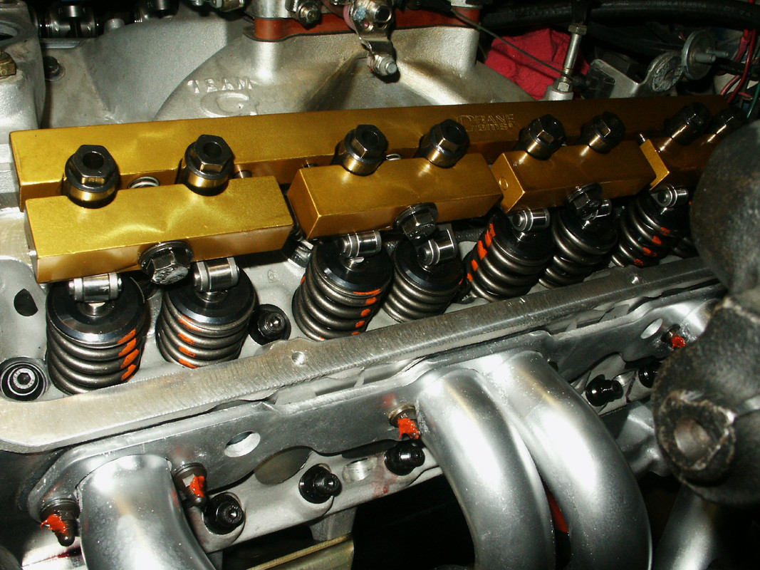

Originally Posted by Shunyun
On my 383 I included a
Summit Racing™ Oil Pump and Pickup Kits SES-3-60-08-002, which I bought not realizing the implications of a high volume pump. The Comp rocker kit warns that I’ll need a deflector or else the rockers will run dry and gall.
I thought that the valve covers serve that purpose. Do I need deflectors and if so, do I need tall valve covers?
Getting back to the original question. My original L-82 cast aluminum valve covers came with little splash tabs above every rocker arm. Are they needed or even work I don't have a clue. One of my first mods was going to 1.6 ratio roller tipped rockers and heads with screw in studs 64 cc chambers. They had clearance issues with the L-82 finned cast covers. So I went to taller valve covers. I never had a problem. Upon rebuilding and hot rodding my original block with a .030 over bore I installed a Melling high volume pump... all without issues.
Shunyun, could you explain your setup? I actually used 7/16th ARP studs on my 383's and later 396's and a stud girdle which would be a type of oil deflector.
So just now I looked up my Comp Cams RR's and I don't see a deflector warning. I run a combo of 1.7 and 1.6 on my SBC's
Ultra Pro Magnum™ Roller Rocker Arm: Chevy; 7/16" Stud, 1.7 Ratio - COMP Cams®

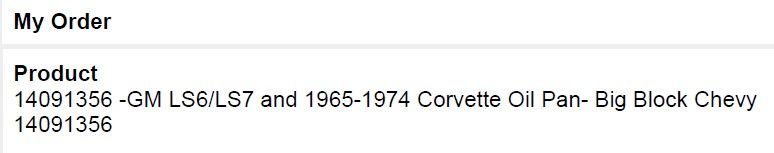

427 hotrod & Jebbysan
Thanks guys. I have a new original GM BB oil pan and tray for LS-5/LS-6/LS-7 corvettes. I think I will just put a larger dia and braided line on the oil gauge, for quicker response, and keep an eye on the psi at higher rpms. I may be just fine. If the psi drops I will address it at that time. The Milodon pan you suggest will be my plan "B".

The OP mentioned ball-n-stud so we assume he is running the Magnum arms
https://www.compcams.com/magnum-roll...2-ratio-1.html
These do come with a spring pressure warning of "less than 350lbs open"
I have seen them gall with much less.
Hence the concern about drippers to keep the ***** from galling.
Way back in the days gone by I had a set of stock orange covers that I cut out the top and bent outboard to be able to adjust hot lash on a running engine with flat tappet lifters. I never saw the oil squirting like out of shot needle where it would jump over the whole rocker. It's a pulsing flow as the tappet moves up and down over the oil passage and the tappet has a bleed off rate. So it's just my opinion that the oil is not going to just squirt over the rocker arm because of some high volume pump. The real issue is excessive spring pressure along with higher lift long duration cam shafts. That's why I asked about his setup. heads, springs, cam timing

This is the one I got new from Pace Chevy in'19 before they were discontinued.
So I am not sure if this is the same as the LS-5 oil pan or not. It did kind of look like the one that came out of my car.
Is that going to be good enough for my needs?
The pan has almost a full flat baffle around the oil pump, and a spring loaded door, and there is a matching but even larger windage tray for the main caps, that reaches to the shallow part of the pan.
The shallow part of the pan is so shallow my previous truck 454 rod bolts left scrapes on the old pan itself, just because it had a few dents in it. So the rods are really close to the pan.
Hence my questions.
I have pics if needed.
