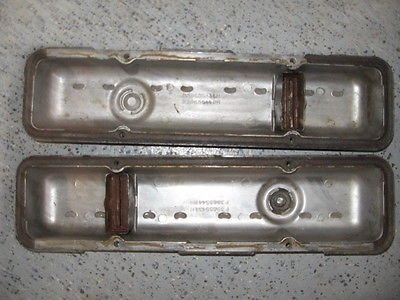

This is what I mean by having drippers inside the valve cover. Little bumps on the inside right over the ball studs. These are aluminum. Steels ones have something similar. All GM ones have them. But aftermarket implementation is very spotty. With full roller rockers it doesn't matter. With ball-n-stud it can matter a lot. I have seen guys have valve train problems just because they changed to fancier prettier valve covers and did not have these! Duh!

...drippers inside the valve cover. Little bumps on the inside right over the ball studs. These are aluminum. Steels ones have something similar. All GM ones have them. But aftermarket implementation is very spotty. With full roller rockers it doesn't matter. With ball-n-stud it can matter a lot. I have seen guys have valve train problems just because they changed to fancier prettier valve covers and did not have these! Duh!

Regarding the covers, I got my hands on some Edelbrock but as you say, they're bare necked inside. Thinking I'll probably sell those here, as I bought them from a neighbor, and get some that get it right.
