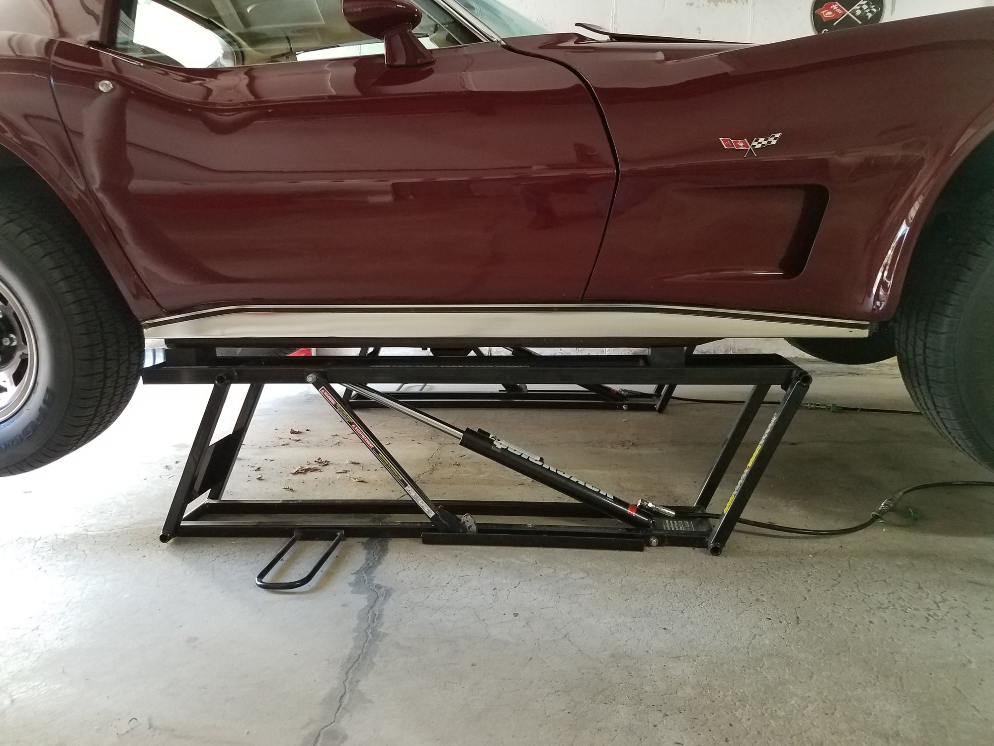

Folks,
I was eyeballing this picture BKbroiler posted and trying to figure out where the forward lifting block is placed? I've learned not to re-invent the wheel when the Forum has so much knowledge.
In the post below it was stated to place the lifting block where you normally place jack-stands......
https://www.corvetteforum.com/forums...post1607158687
I understand that but I usually place my jack-stand farther forward. Anybody have have a closeup? I can figure out the rear but don't want to mess up on the forward placement.... it appears to be immediately before the frame turns inward? Does this look about right?

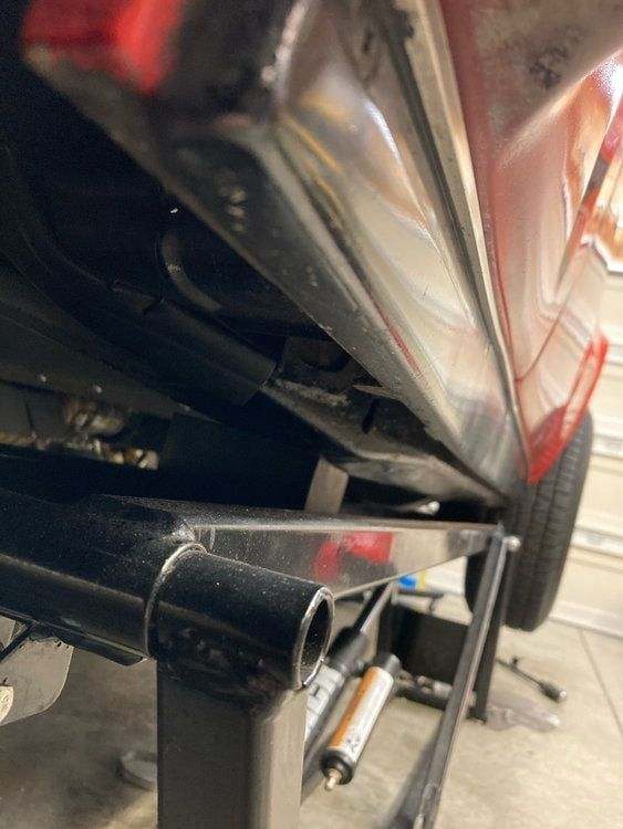

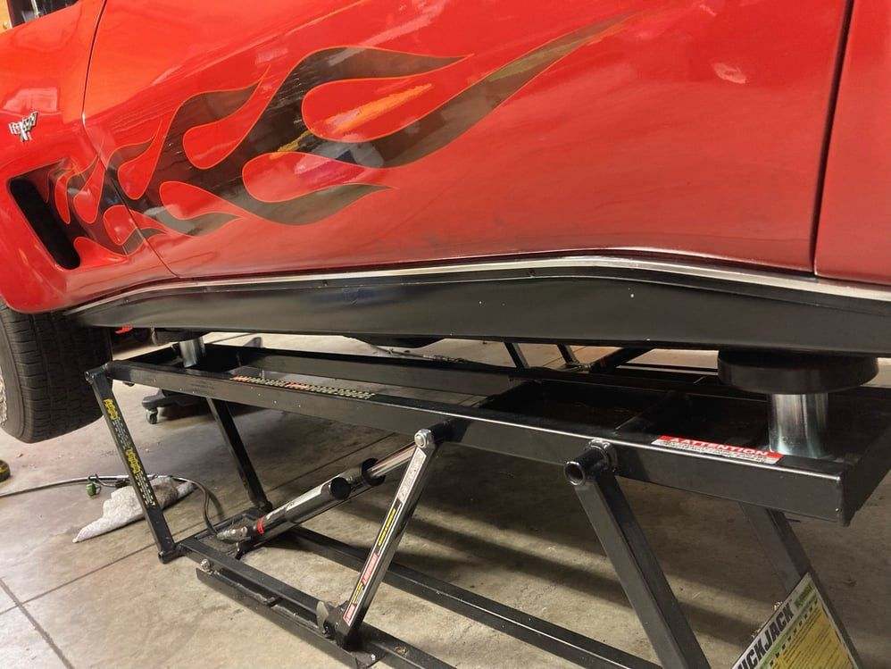

Does this help? It's the only photo I have with it on the Quickjack.

It looks like about right placement.
put as far back on frame as you can than with the shortest quickjack leaves you putting the front black just before the frame turns in.

Thanks Guys!
Looks like straight down from the the front door forward gap.... I can work with that.

Just for the record, this is the pic I posted.
The front rubber blocks are just behind where the frame curves inward, as mentioned above. That is a factory recommended lift point.
