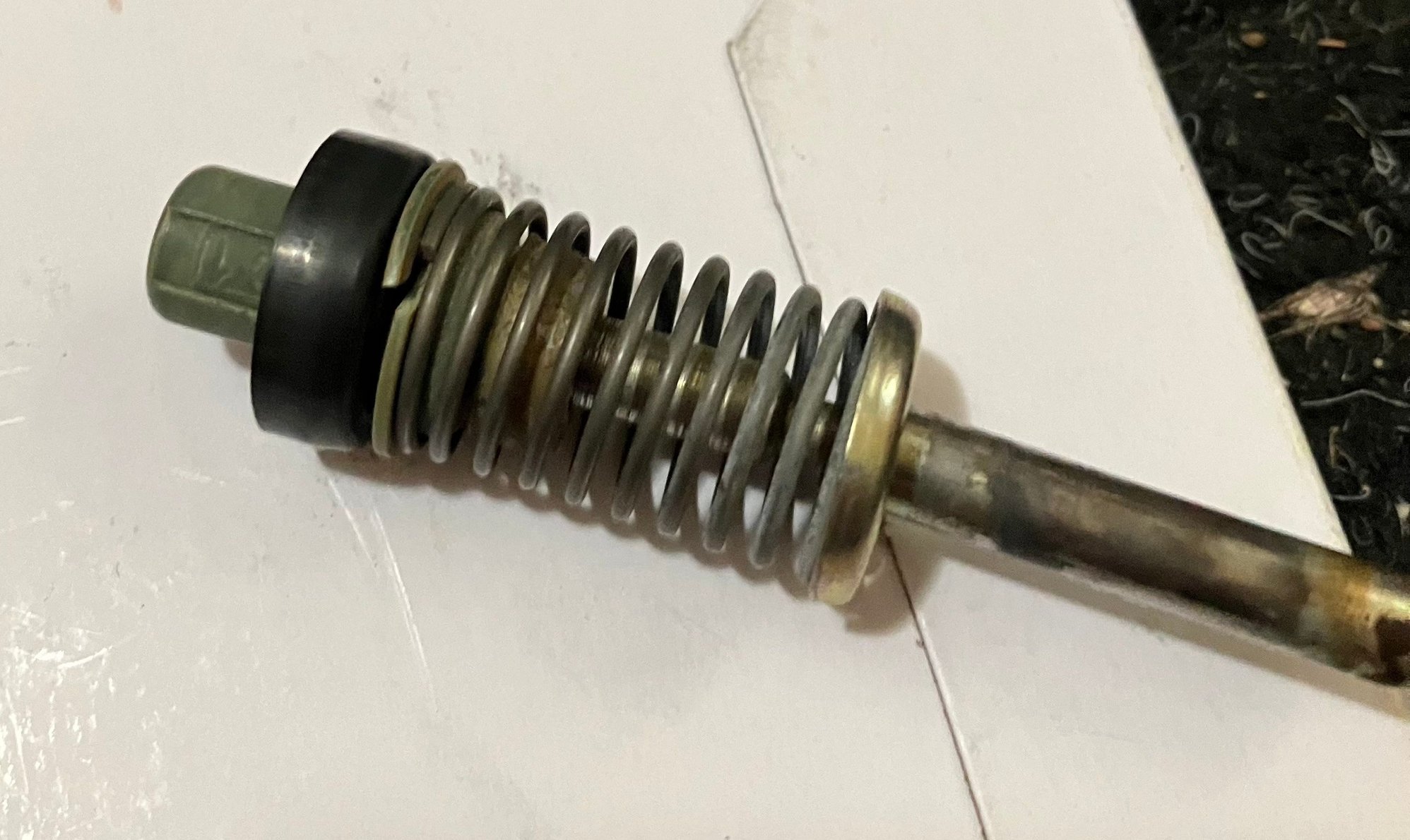

Your accelerator pump is dead. It is probably one of the cheap non-ethanol-compatible pumps, and the diaphragm has either collapsed, or swollen up and sheared off the accel pump shaft. Replace the pump with a good pump. You get a good pump from Cliff.

Ok I got the parts and installed them. The old pump was not that bad, the cup was not shredded but there was a crack in the plastic disk at the wire end of the spring.
old accelerator pump. Notice the crack in the plastic disk just next to the rubber cup
