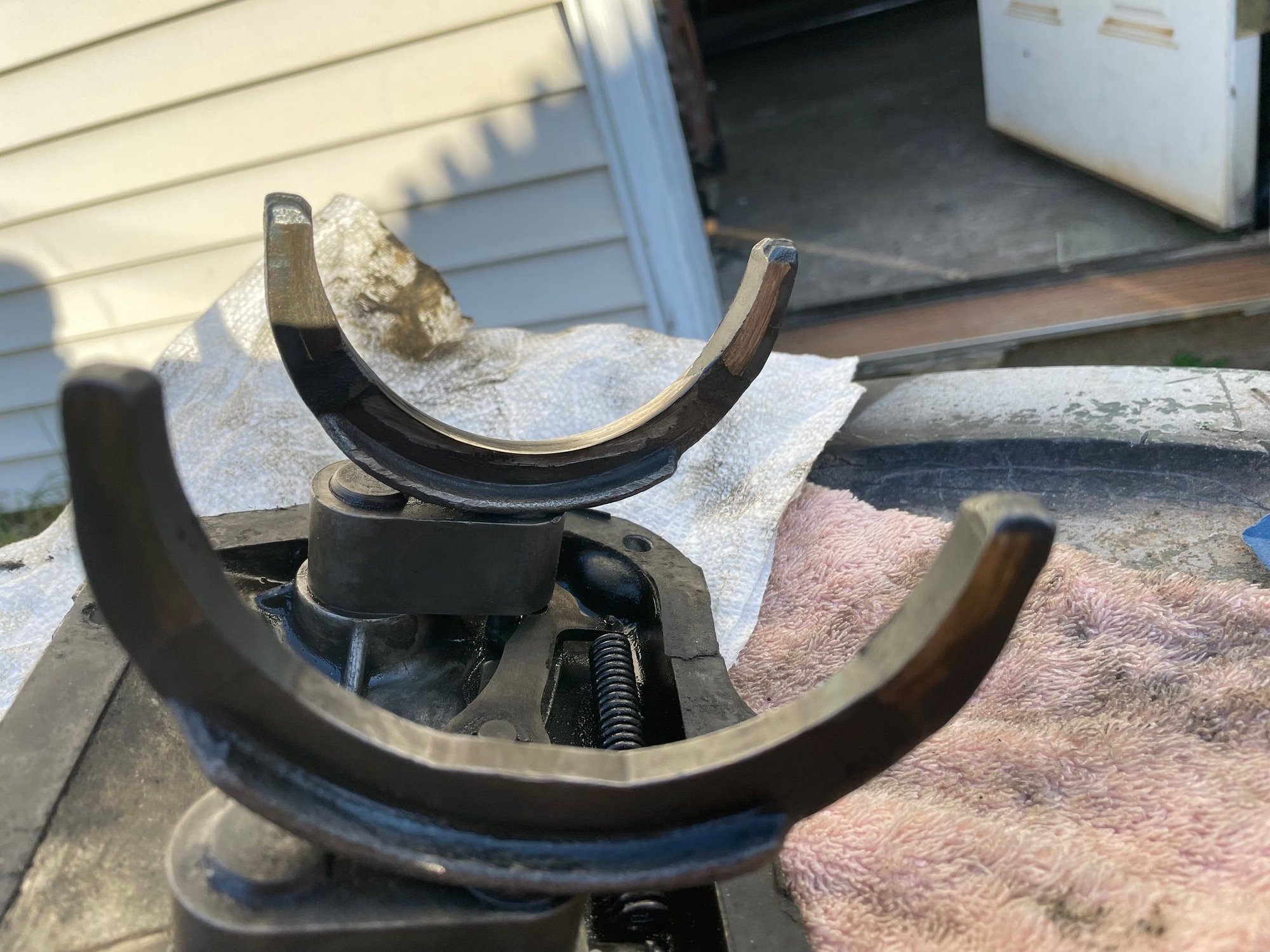

i have a 1970 vette 350/350 4 speed m20 muncie i had a problem with 1st and 2nd gear lever with a lot of slop , 3rd and 4th gear lever rotates real crisp i removed the side cover to see a lot of wear on the 1st gear fork. its worn on the inside circle area of the fork my question is what is the cause of this and can i just replace the fork or do i need a total rebuild i dont know the history of this car just picked it up

Looking at your pics that part of the fork isnt supposed to contact the slider. Just those two raised tabs at the end of the forks move the slider. Either your sliders arent installed correctly or they have issues but again they just go front to back so check everything that moves them. Post pics of the inside of our transmission and the linkage and the outside of the housing that holds all that stuff together

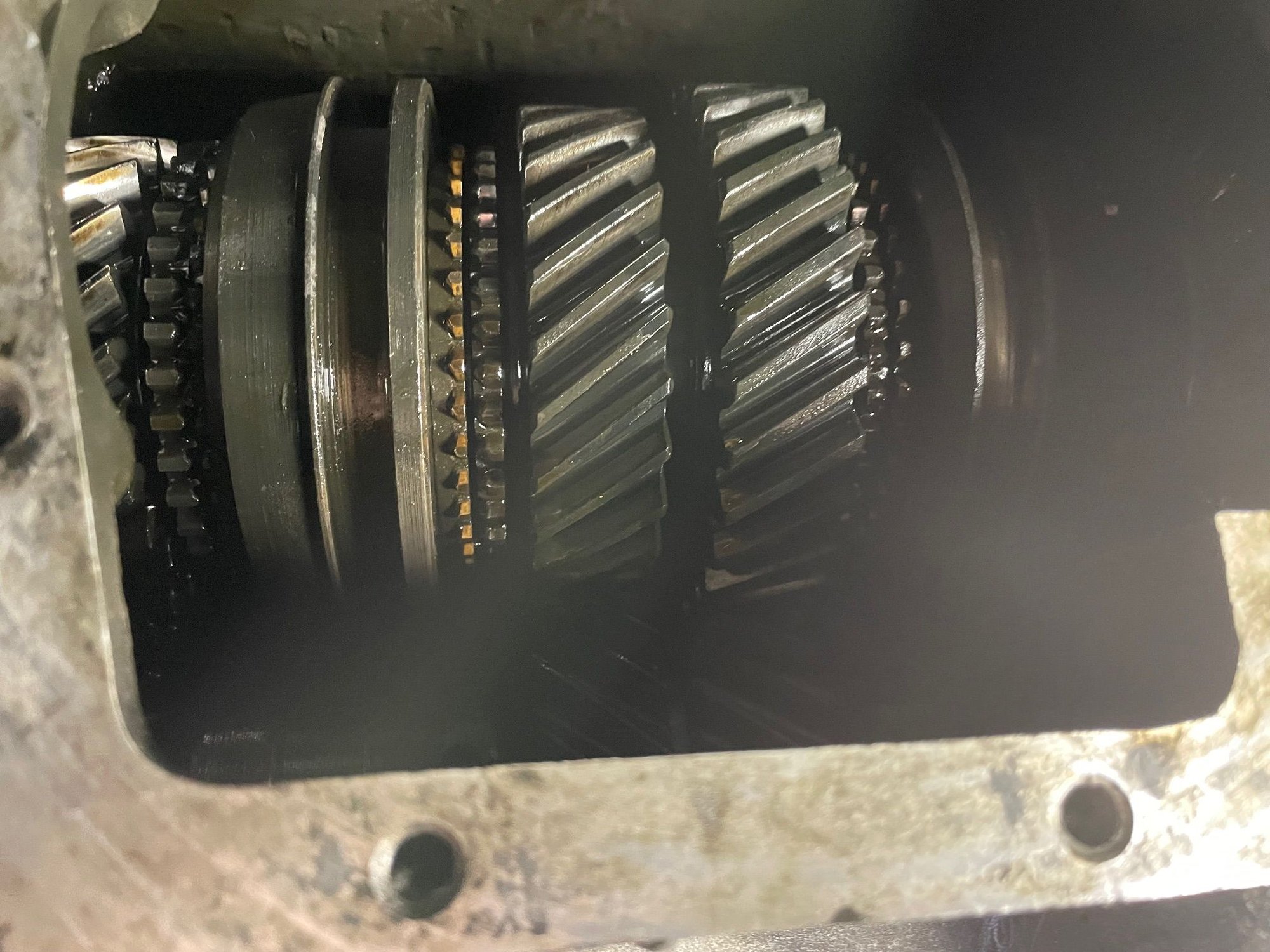

heres the picture of the gears nothing looks chipped or worn

After having the car in reverse the shifter and trans would go into neutral postion but the lever on 1st gear on the transmission wouldnt lock into the center notch (neutral) so i would have to get under the car slide the shift lever to the neutral position to be able to put in first gear. With the shifter rods disconnected there was not a good click like lock in like you hear normally hear when you take the lever by hand and move from 1st to 2nd with shifter rod disconnected

Thats a shifter issue. The transmission doesnt know anything besides where the forks put the synchros for each gear. Y9ou need to rebuild the shifter as sthe bushings maybe worn or the shift rods themselves are bad. Is it the stock shifter or a Hurst

You should measure the fork and groove to see how much wear is there. If the slider is worn you may not get all the play out.
