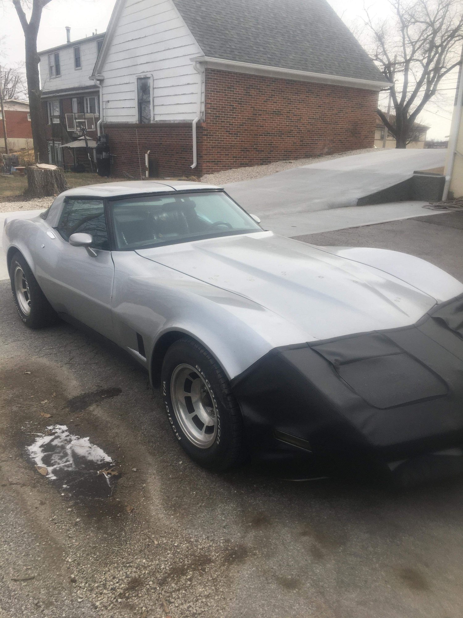

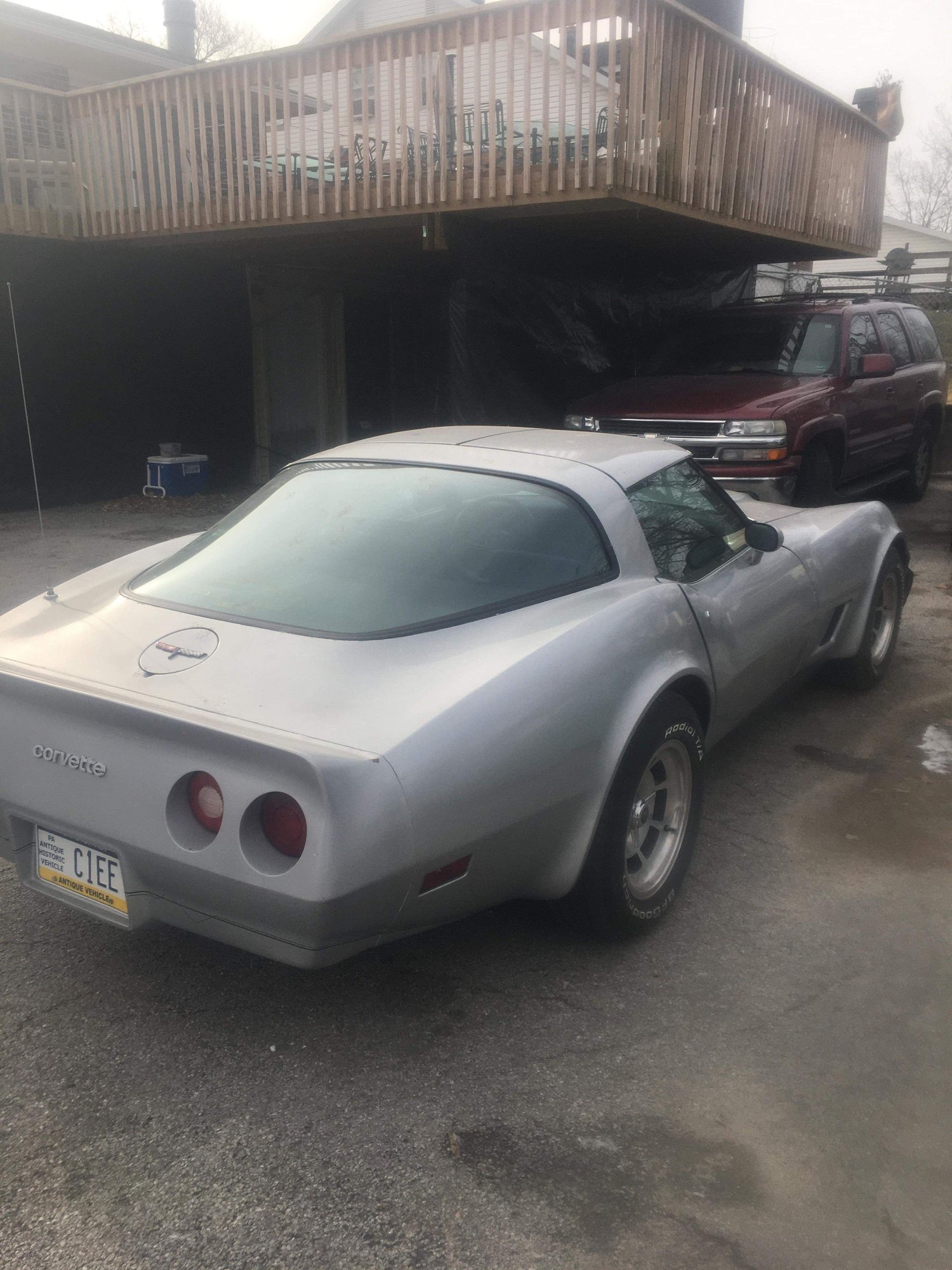

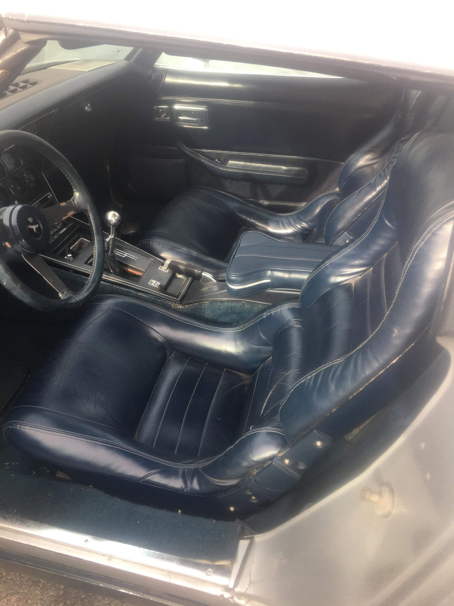

man ive loved them ever since i was a kid ill get you some pictures its silver with navy blue here are some pics yeah didnt know how rare the four speeds were kind of lucked out. I’m so excited to work on it over the winter. I plan to get some Doug’s headers and side pipes and then an edlebrock intake manifold and 650 carb kit with a new distributor that should wake her up a bit then i can get rowdy
Old Dec 4, 2023 | 11:20 PM
Bikespace's Avatar
Bikespace
Joined: Mar 2017
Posts: 11,953
Likes: 4,508
Nice! That should clean up well and be a super-fun car.

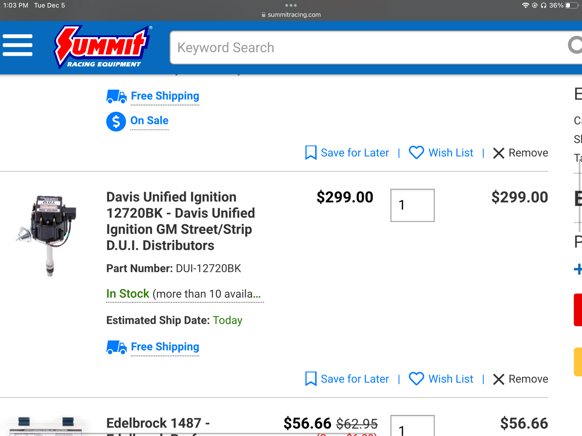

alright i just looked around a bit is this one good?
Old Dec 5, 2023 | 02:23 PM
Jebbysan's Avatar
Jebbysan
Dr. Detroit
Joined: Mar 2012
Posts: 10,097
Likes: 4,027
From: New Braunfels Texas
If you order it direct from DUI....they will curve it for you......
