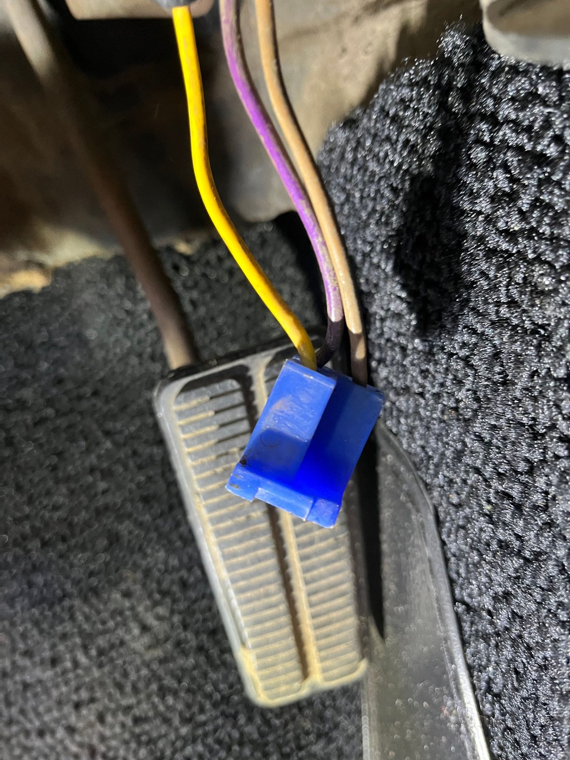

Hello from the C4 forum
I’m working on assembling a 1976 Auto Corvette. The interior of the car was stripped for paint, unfortunately the owner died before putting it back together. I am putting the car back together for the family. I have the dash back in and every connector accounted for except the one pictured below.
I have an assembly manual for the car plus a color wiring guide from dr rebuild. For the life of me I can’ find this circuit. Any help would be appreciated!

It's in the right area for the rear window defroster switch.

Thank you! I will take look for that.

Just to close out this thread. ‘75 was correct that was the connector for the defroster. Thank you for the help!
