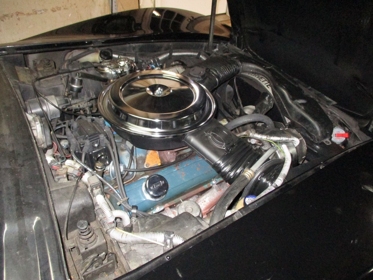

Just to confirm:
You sold your 81, then turned around and bought a 78, took all of the paperwork from the sale, and locked it in the car at an offsite storage location. And you have no pictures on your phone, or from a nearby family member or friend, or from the original listing on Craigslist, FM, Bring a Trailer, or wherever you found the 78 to buy. And you didn't even check to see if it was an L48 or L82 when you bought it. What color is it? What transmission does it have?
I'm not going to say that sounds like the far-fetched tale an AI would tell us, but FFS...
On the off chance you are a real human, do you remember if the underhood system had one or two snorkels? In 1978, dual snorkel CAI was used on L82s., single snorkel on L48.
Here's a dual snorkel system from a 78 L82 installed on my 79 L48. Did it look like this? I HATE chrome, and only chrome aftermarket lids are available right now, but this system should perform better than just about anything else you can put on that car, at least up to 400 hp or so.

Originally Posted by Bikespace
Just to confirm:
LMAO i am not an AI but it damn well seems like it the 81 was a pain in the *** guy pulled out on me i just wanted to do some preliminary research on what would need to be done. kinda similar with this one im getting more info on it now and im trying to see what would need to be done so i can get funds in order to start working on it ASAP to have it ready for the summer. im getting more pictures tomorow and facetiming the man with it to get a full rundown. unfortunatley the guy doesnt have any pictures of the engine posted. from what i can tell its an l48 the tach doesnt say l82 nor is it badged as such. i will have more info soon its an anniversary edition with the 4 speed manual yeah i dont love the look of the snorkel but i might have to keep it lmao. i hopefully should get teh car next week im talking to the man im buying it from tomorow on a facetime to get a very detailed description of the car. its been my dream to own a C3 ever since i saw em but as you can tell i have much to learn. so im as of right now im gonna go with i have an L48 im putting dougs sidepipes and headers on it but what else should i do to wake it up? people were saying for the L82 get Lars papers and do the dist and carb is it the same thing for the L48? im really sorry for all the confusion guys you have been so helpful im really tryna learn here im new to this **** but have a passion for cars my father instilled in me.
