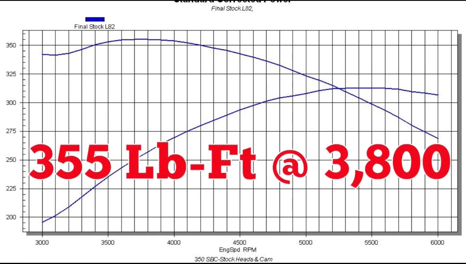

This thread may help you. Side pipes not for power but cool.
if it is an L82 than you already have ideal distributor. You should confirm this.time it like the thread below..
also see what gears you have now..auto ? Manual? You may already have the gears you want.
pics? Original carb? Have it rebuilt by member Lars here mentioned.
https://www.corvetteforum.com/forums...x-power-3.html
L82
L82
L82
