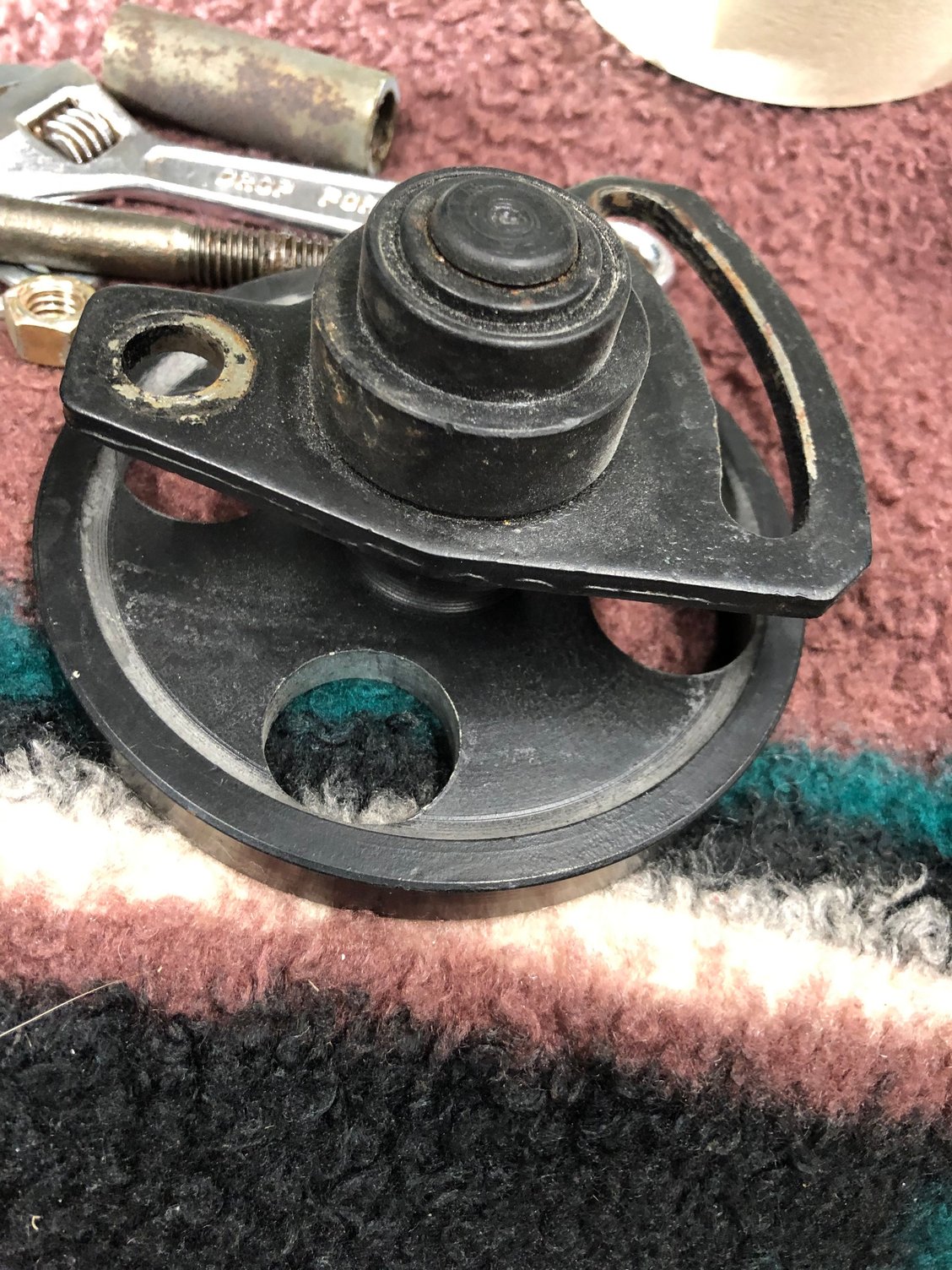

When I pulled my PS pump I noticed the idler bearing doesn’t sound 100% to me. It’s not got a lot of movement but sounds fairly dry. Kinda un decided on finding bearings or buying the bearings already pressed on the shaft and just re using the bracket and wheel. What is the best way to get this done?

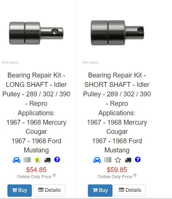

SO.... if you can figure out which of those 2 "long" pulleys is the equivalent of that Everco a8632 then the video website has the bearings available for 58.95.
seems like GM, Ford, and AMC used that A8632...
I suspect it is one of these:
https://secure.cougarpartscatalog.co...pulley&CatID=0
