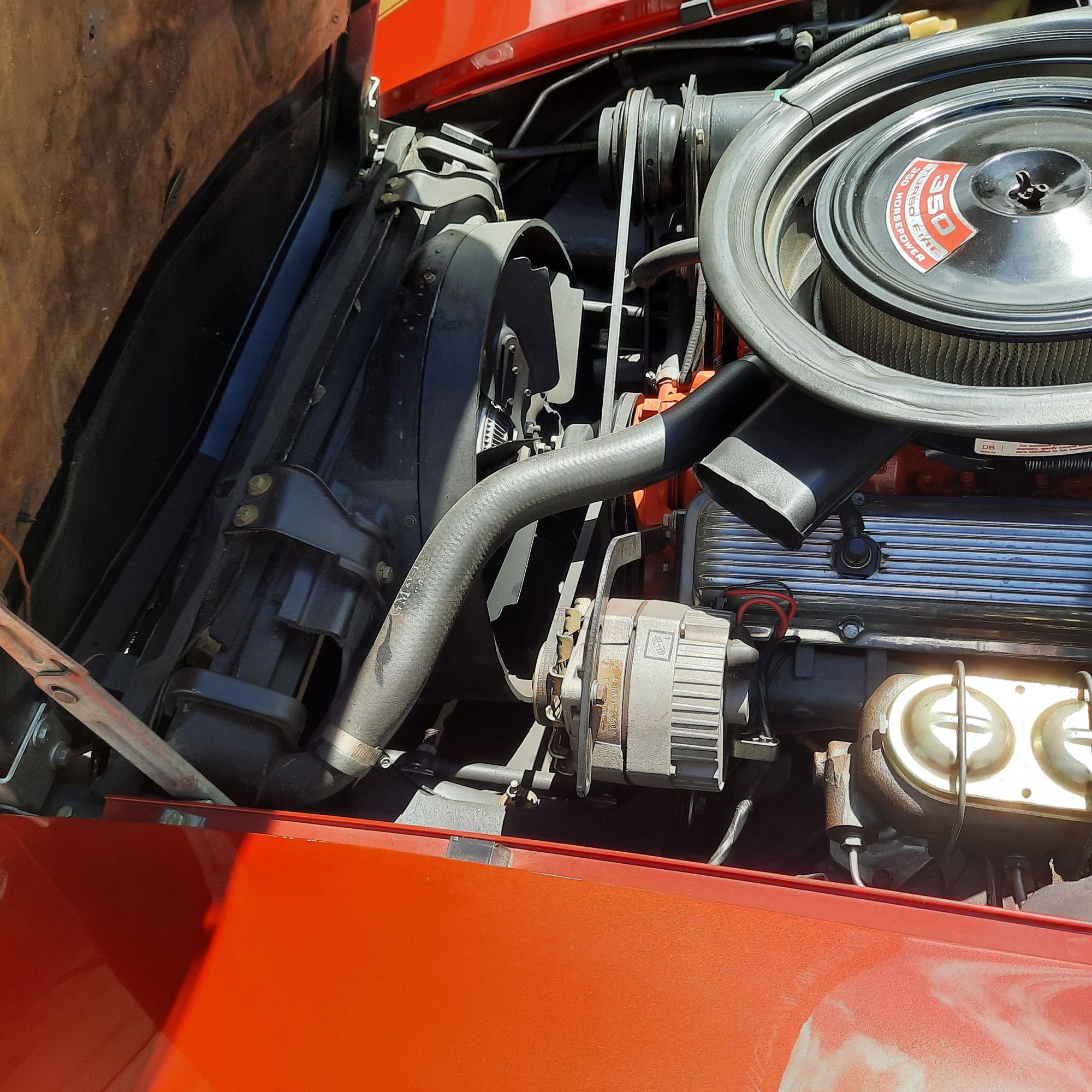

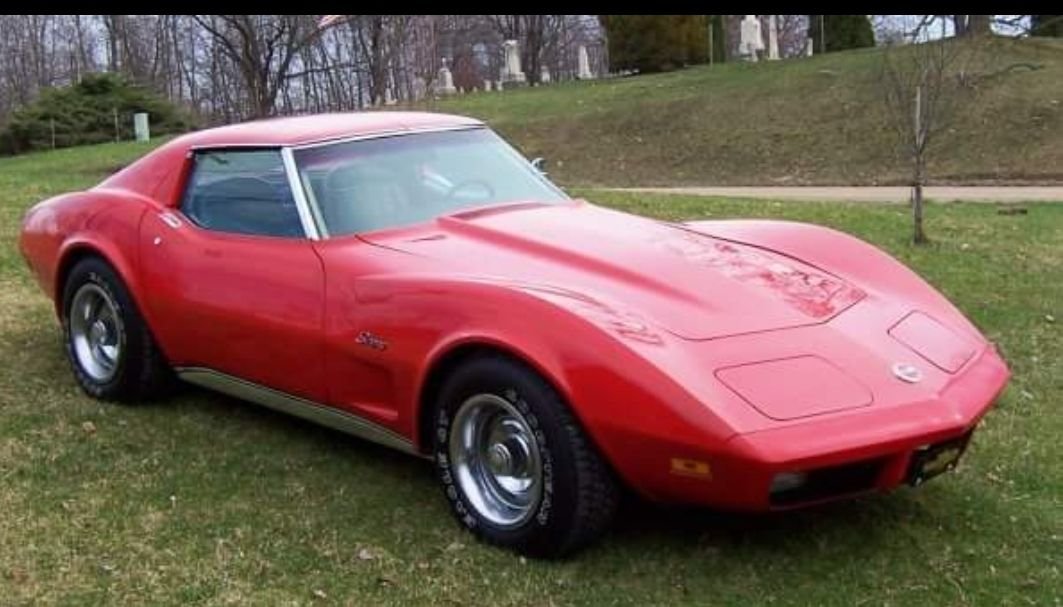

I'm sure someone has already broke ground on a LS-Swap for this generation, does anyone have issues they may have ran into ? And love to gear your success story along with your comment.

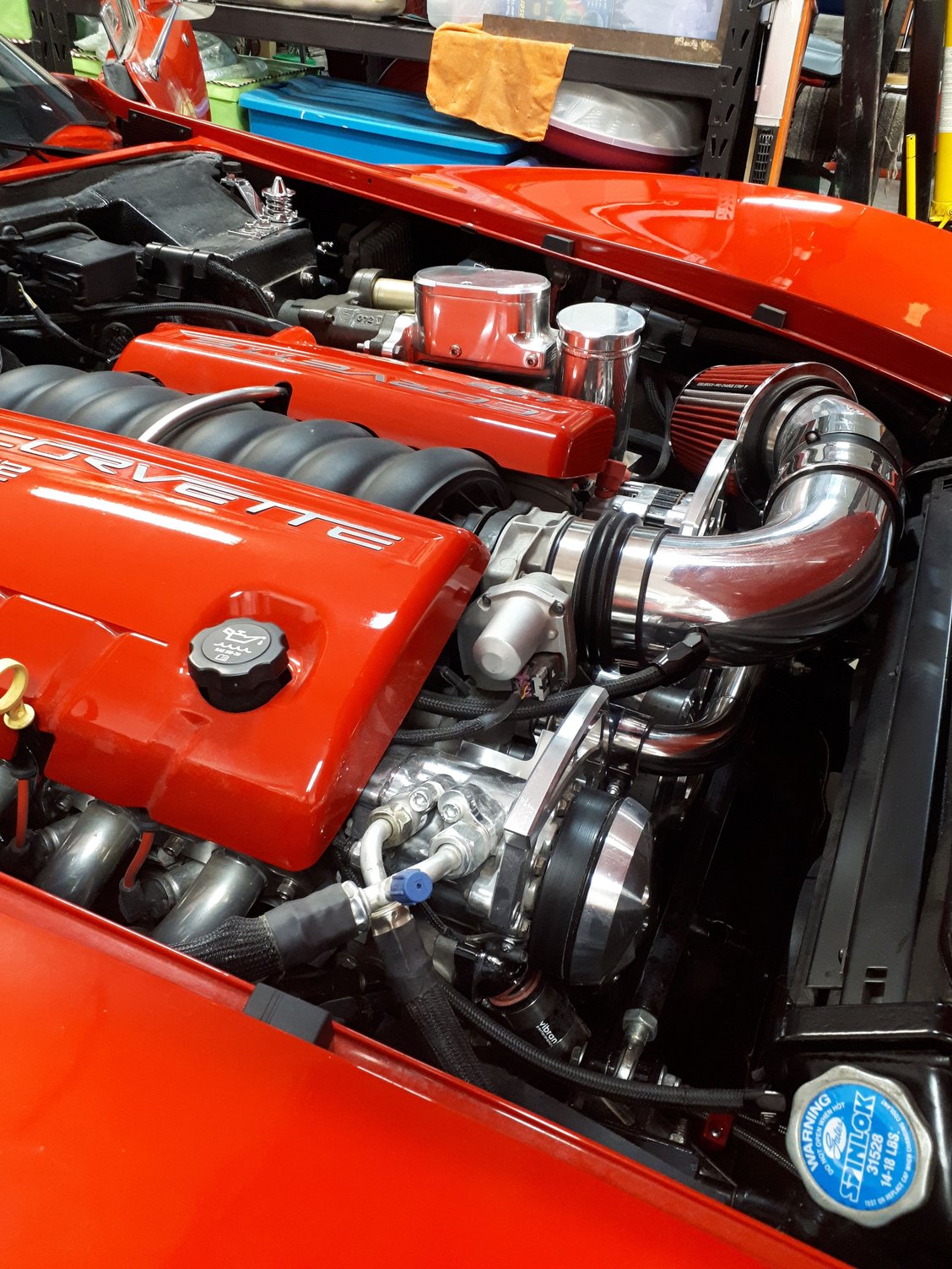

I did the LS swap into my 74, if you decide to go that direction (it is your car) do lots of reading. I bought an 06 gto ls2 with 4l65 trans. Which required an oil pan change. The accessory drive is from March. The fuel system is an in tank pump with the fuel regulator in the engine bay (if I had to redo it I would use the vette filter regulator combo). The ecm, tcm and peddle came with the motor and I did the wiring mods myself (the ecm from the gto is a 2yr only so do some reading on that). As for the cost it's not cheap but cheap and corvette don't belong in the same sentence.
