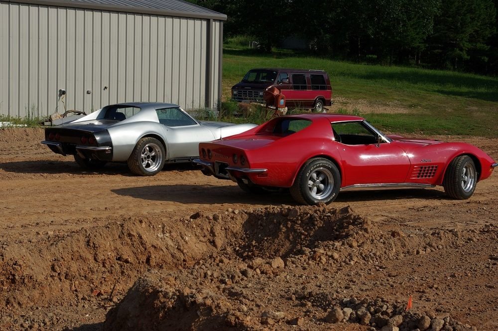

200s installed in 1973. Bone stock suspension. No mods to wheels or use of spacers.

Old Feb 29, 2024 | 05:20 PM
a striper's Avatar
a striper
Joined: Jun 2015
Posts: 1,266
Likes: 156

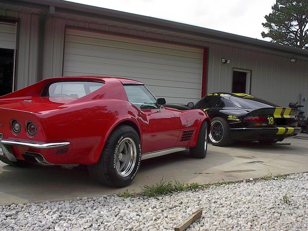

My 15x8 and 15x10 cleared the brakes without a spacer. But they're from 2006. I can't speak to any changes over the last 18 years.

Old Feb 29, 2024 | 07:15 PM
a striper's Avatar
a striper
Joined: Jun 2015
Posts: 1,266
Likes: 156
They are two piece which allowed me to get a custom offset to stuff 10" in the stock rear bodywork.
Old Feb 29, 2024 | 07:40 PM
JonBial's Avatar
JonBial
Cruising
Joined: Feb 2024
Posts: 13
From: Pennsylvania
Thats good news!
I hope I can achieve that same look!
Awesome Vette you have there!
Thanks
Old Feb 29, 2024 | 07:48 PM
Richard Daugird's Avatar
Richard Daugird
Joined: Dec 2015
Posts: 3,181
Likes: 732
From: Texas City, TX Texas
Yes that does look killer. Maybe Discount Tire can get them and test fit them. I'd bet A.R. will allow a return from them.

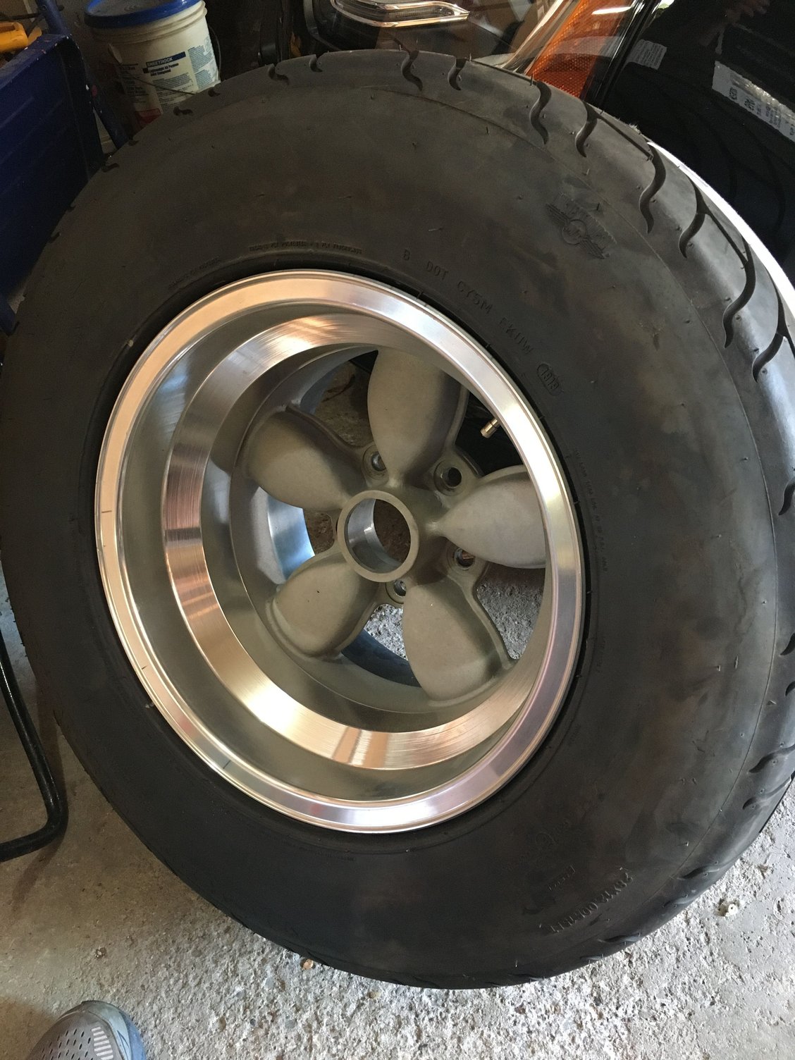

Im under the assumption theyre welded. These arent mine. I was trying to find a pic to determine the inside barrel dimension. The individual at American Racing says 13.1". Im kinda thinking that cant be right.
