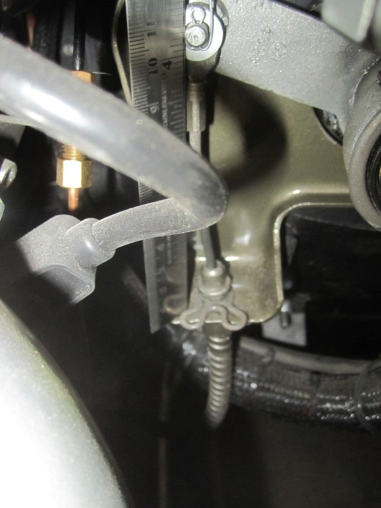

The column lockout in full up is about 4-3/8" from the bracket to the pin
key cylinder gap, can press in from there to turn to run
Is yours a tilt/tele or fixed column?

Look at the lever in the engine compartment, you may have a cable to the shifter that is not hooked up. Pull the lever all the way up and see if that changes anything. The lever is on the column and looks like what is pictured above.

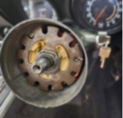

Hi Everyone,
I thought I should come back with an update.
It was indeed the lock cylinder that was the culprit.
I installed a new lock cylinder and now I can move it from the RUN position, back to the ACC position.
However, I can still not move it all the way to the LOCK position, and I think perhaps it is because of the
interlock linkage to the gearbox that many have mentioned.
Also, upon reassembly I found that the telescopic shaft locked in the bottom position after I mounted the
steering lock plate and retainer ring.
It was moving up and down freely, but after struggling to get the lock plate back in place (I didn't use a depressor tool,
only my thumbs) I found that the shaft now is not moving at all so I can not get the next part assembled, because the threads
does not reach far enough.
I am not sure if this was a direct consequence of putting the plate back or because maybe turning the ignition key?
Is the tilt only supposed to work when the key is in LOCK position, if so, maybe this is my issue?
