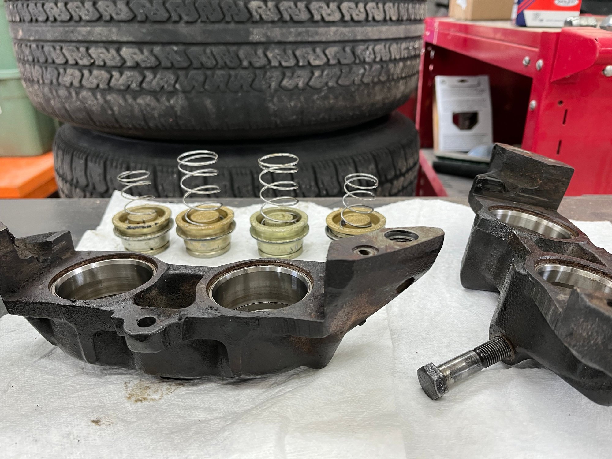

Pulled the LF caliper today and broke it down. Lots of sludge in two if the bores but they were all sleeved with stainless. Cleaned everything up for inspection. Discovered i have two different diameters and lengths of piston springs. FSM makes no mention of this. See pic. Normal? Which spring goes where?

There has been lengthy discussion on whether the fronts are even supposed to have springs.
The rears do, to take up any slack between pads to the rotors.

Heads UP—if rears need them why not the fronts as well? Isnt the only difference in the fronts and rears the piston size?
Seems like the fronts get the fat springs and the rears get the skinny ones

All of the front and back brake calipers I've rebuilt (maybe a dozen) have springs behind the pistons – and they all appear the same length within the caliper. Here is a GM parts book listing for the front and rear springs (65/66 used a different piston):

I did Google C3 front caliper springs and guess what.
This forum popped up with discussion (arguments) about it, whether or not the fronts get a spring.
It was about lateral forces in the front pushing on the pads when turning. Where as the rears are more stationary being on a axle.
Who knows?

With two different part numbers for front/rear springs i figure there is a difference. This also seems to match what I see on the Zip site. Guess i will breakdown a rear caliper and see what is there.

Before i proceed which spring was designed for the front caliper? Taller and narrow? Shorter and wider? Does not seem wise to mix springs in a caliber.

Here are the kits I used, from CSSB Inc.
https://www.cssbinc.com/1965-1982cor...t-1-1-1-1.aspx
https://www.cssbinc.com/1965-1982cor...kit-1-1-1.aspx
Take a look for yourself, but it looks like the longer springs are on the rear pistons.
They even sell the springs separately.

Very interesting. Maybe only the "O" ring style gets springs in the front?
Lip seals may not? IDK
Old saying: If it came that way, put it back that way.
Those rebuild conversion kits are nice.
But at $63 on each corner of the car, it gets pricey.
