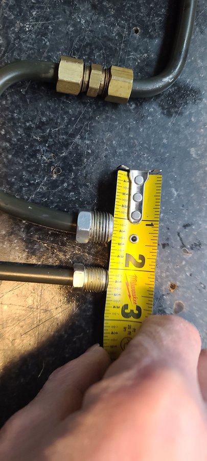

That's the normal, standard length of an inverted flare fitting - you're not going to find anything, or need anything, longer than that. If that fitting, assuming it's the right size, does not seat against the pump's inverted flare sealing cone, you have a problem with the pump. But I've never seen that happen.
But is that really a 3/8" diameter fuel line..? Looks like 5/16"... have you checked it? Is your inverted flare fitting a 5/8" thread fitting? It looks like 1/2", which won't work... you can't thread a 1/2" fitting into a 5/8" threaded hole.

Original fitting on the right. New fitting on the left that threads into the AutoZone pump, but isn't long enough to seat correctly

I have two of them here in the shop, and they are both correct. If you can't find a good Delphi, use Carter part number M6955. I've never seen one of those pumps with a 1/2" threaded outlet. They are all 5/8" for a 3/8" fuel line. I think you have a line and fitting problem - not a pump problem. How are you measuring the pump female threads? Are you measuring across the minor diameter of the female threads? If so, the 5/8" threads will measure at 1/2". You have to measure the threads on the major diameter, which will be 5/8". They don't make that fuel pump with a 1/2" threaded outlet.

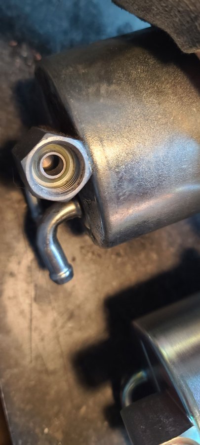

I got a Carter pump m6955. It is still not the same as my old pump. It uses the smaller sized fitting. Which is 1/2 in threaded on a 5/16 tube. It also seems to be missing an insert for the flare to seat against. Which would explain why the flare isn't seating inside the pump fitting. Here are photos of both pumps and tubes. Photos rotated when I uploaded. in the first photo The Carter pump is on top the old pump is on the bottom. You can see the fitting in the new pump is completely bottomed out and still not seated. The old pump seats before all the threads are in.
My old pump and flare line are on the top, the new Carter pump and smaller flared line are on the bottom
My original pump on the left. The new Carter on the right. There seems to be a seat inserted in the fitting on the old pump, but not on the carter.
Closer look at the Carter pump
This is my old pump.
Here two flare lines again. My old one on the left with 5/8 thread on a 3/8 tube. On the right the one that fits in the Carter pump, half inch thread on a 5/16 tube
