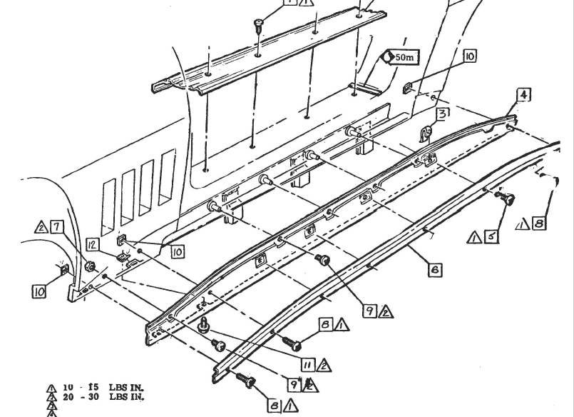

Hello. Newbie here. I have ordered from Fix part # ET-301 and am trying to see if anyone knows or has information on 69 corvette upper and lower (fiberglass)rockers where the hardware all goes. The imaging that came with parts really doesn’t help. Any help would be appreciated thank you!

If you haven’t done so already, get yourself an Assembly Instruction Manual for your 69. It’s a great reference and contains the information you’re looking for.

Here is a picture from the Assembly Manual.

Thank you so much for your help!
