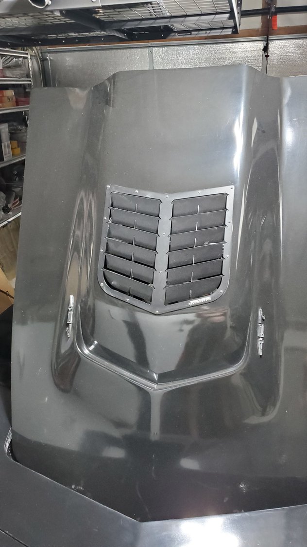

Has anybody installed the Track Spec Louvers on their standard hood? I want to get rid of some of the heat in my engine bay and found this heat extractor on Summit Racing. It measures 15.5 by 15.5 and extrudes downward towards engine 7/8"

I have it on my L-88 Hood. And it is 1/4 inch away from hitting the air cleaner. Unless you have a High rise hood, I don't think it would work.
I would put some clay or foam on the air cleaner and close the hood to see how much clearance you have first. Then go from there.

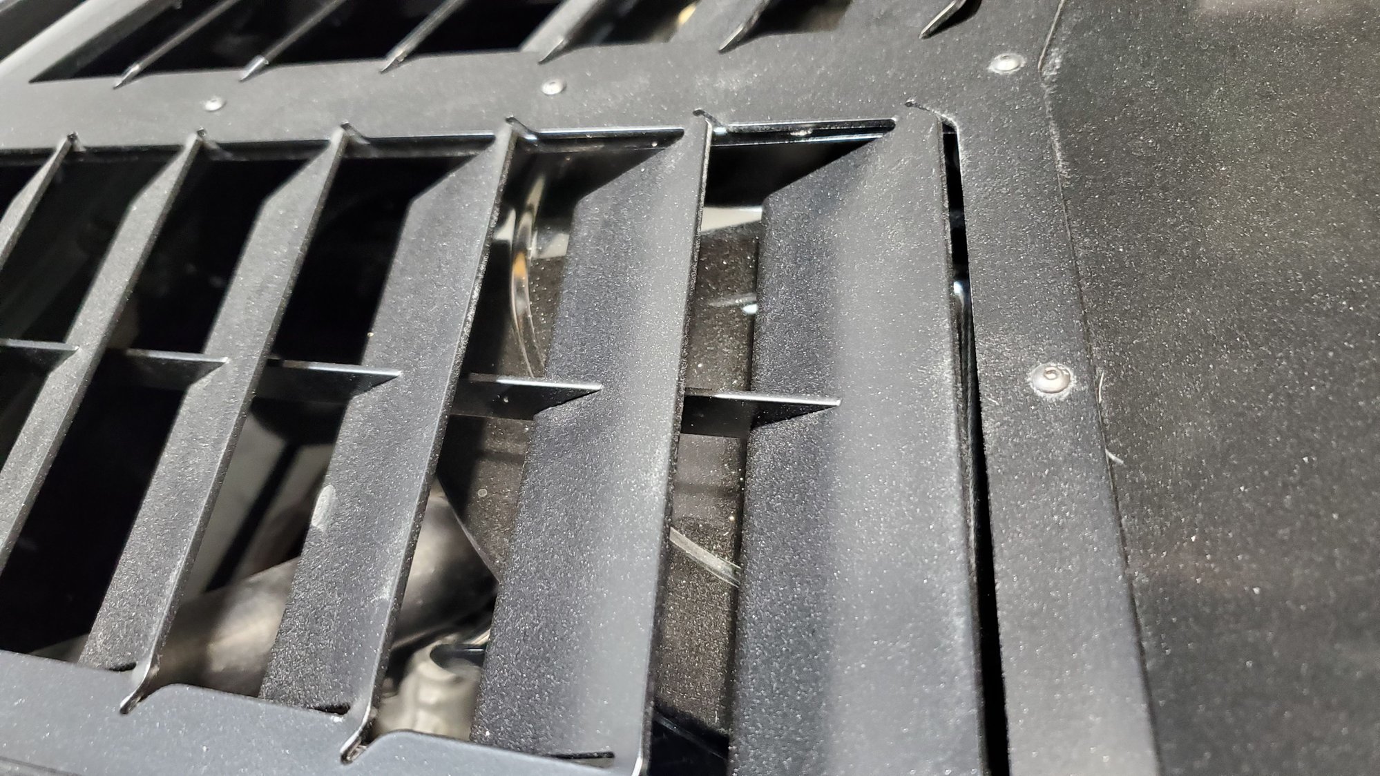

Sorry for the dust. lol.
I put it more up front to help with lift at higher speeds. The L88 hood has an opening toward the windshield with the high rise hood. Plus I think it looks better more up front.

Any vent will help with heat issues. I haven't pushed mine to see how much of a difference it makes yet. Just put it on over the winter.
Hope this helps.
