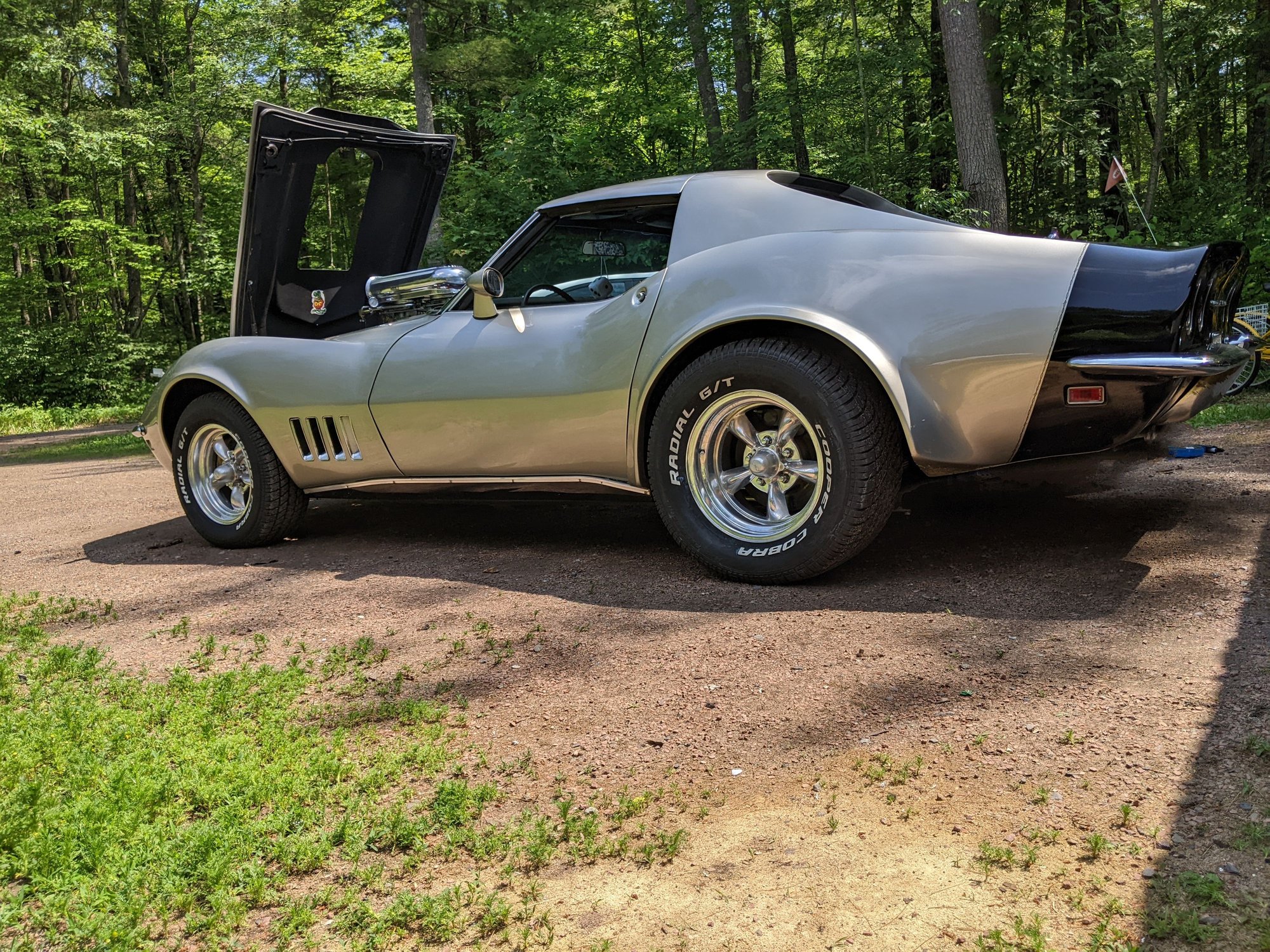

I solved this issue by cutting a hole in my hood and to stop it from looking awkward I filled it with a tunnel ram.

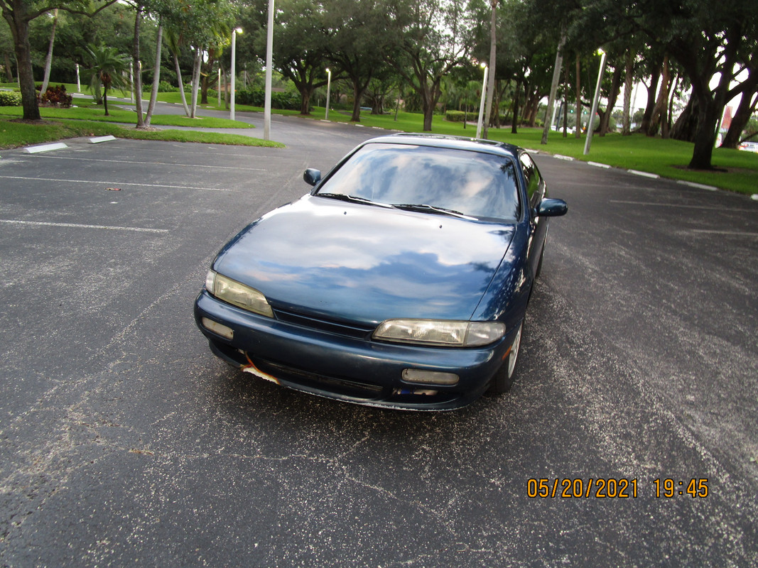

If the air temp is 102*F. Oil temp is 208*F. Coolant at 200*F.
Then its perfect. You insulate, no heat in the engine bay, perfect engine, perfect bay, done.
Your 'theories' about somehow melting the engine while the air oil and coolant temps are in check is just hallucination!!!
Would you all like an example of my applied science where i put my money where my mouth is an build a fully insulated gasoline powered vehicle that has reasonable output? Absolutely flawlessly tuned for economy and power and reliability with a factory looking appearance and noise level ah who is doing that these days?

Even though I don't like chrome, or stuff poking through the hood, I LOLed at this perfect reply to the other responses on this thread.
