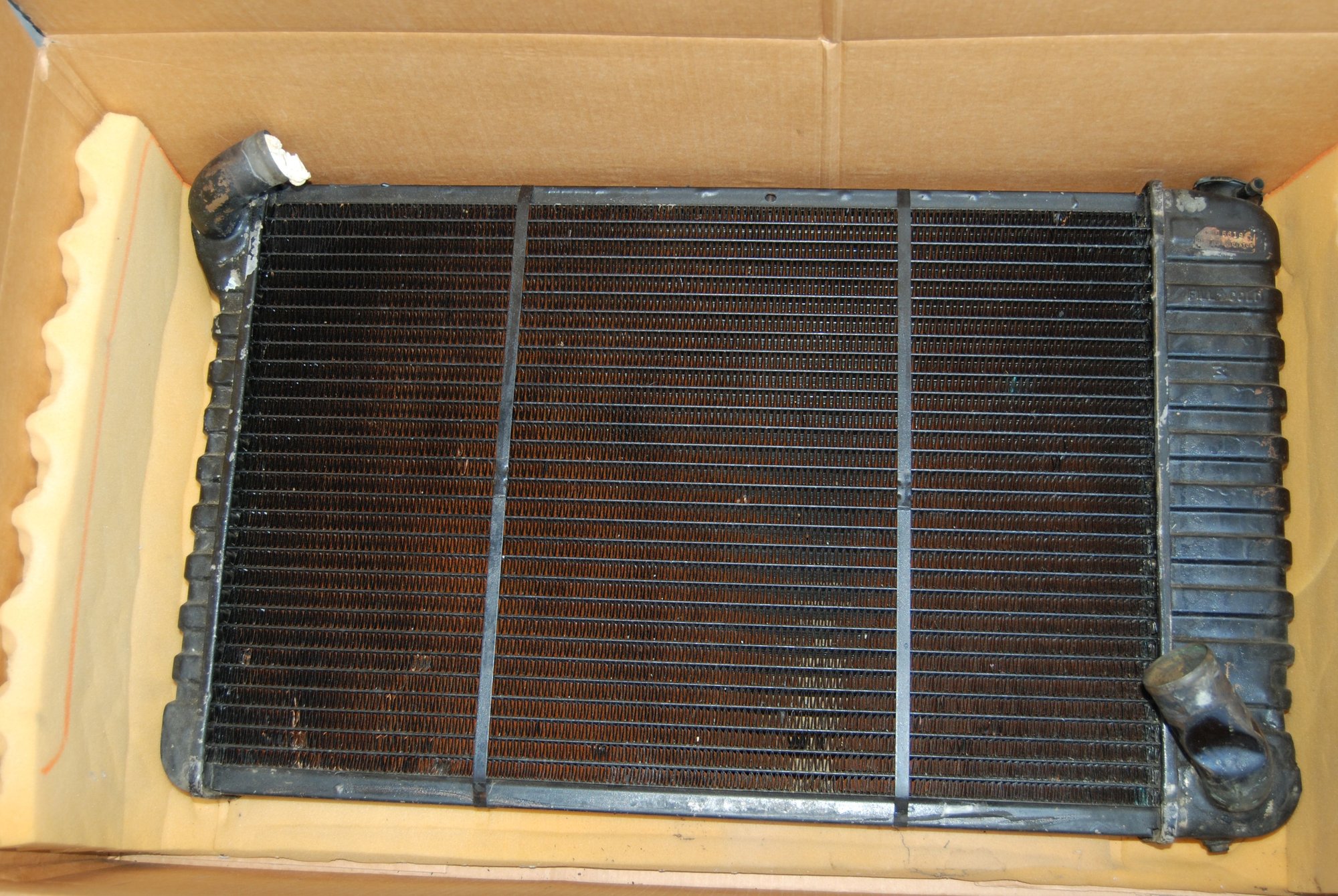

I couldn't tell here if you are looking for new or used. I have this out of my 69 that's been recored at least once, maybe twice. Held pressure when I took it out. Loball price for you, mostly shipping.
Thanks, but I need one for an automatic.
