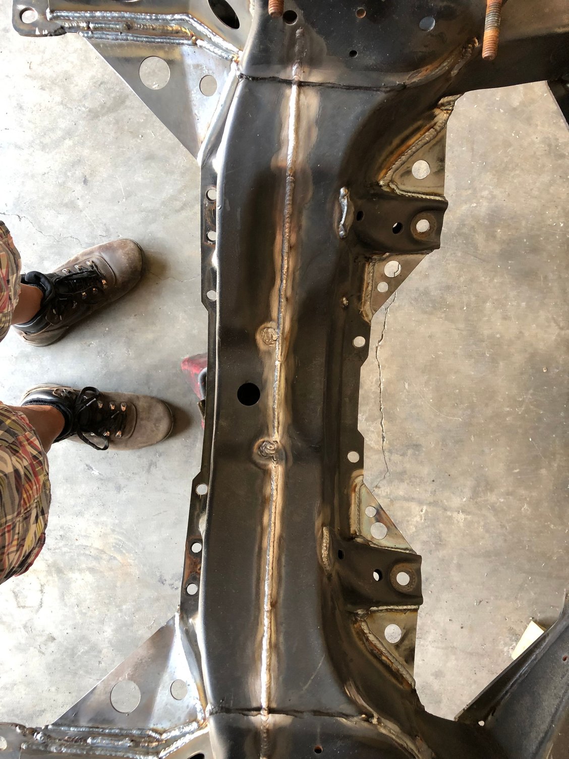

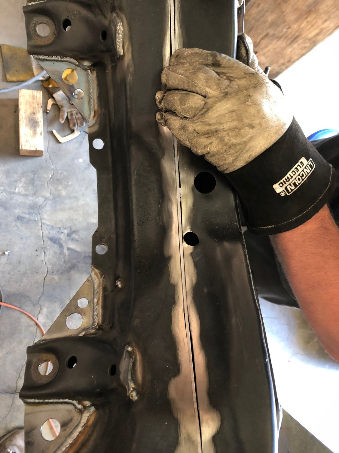

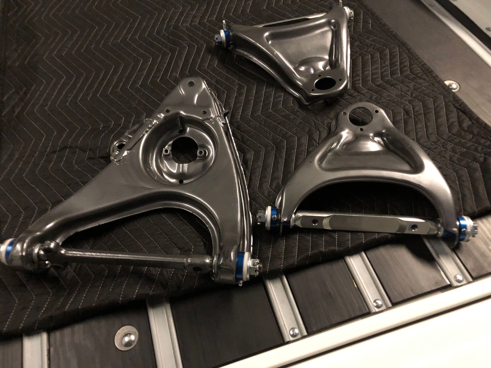

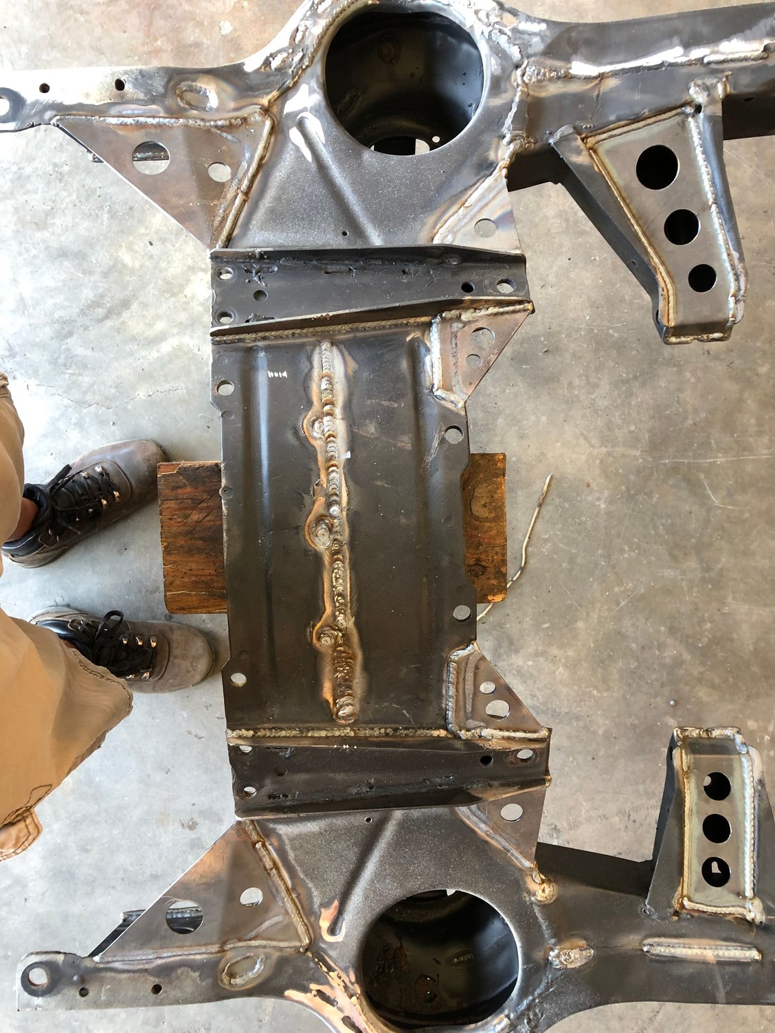

Del A Lum bushings will help
And this you won't find it in the power book
And these
