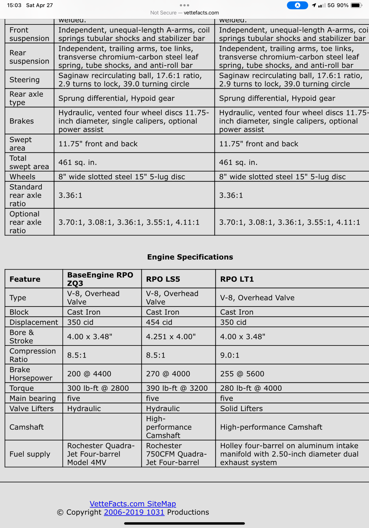

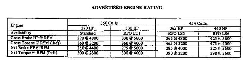

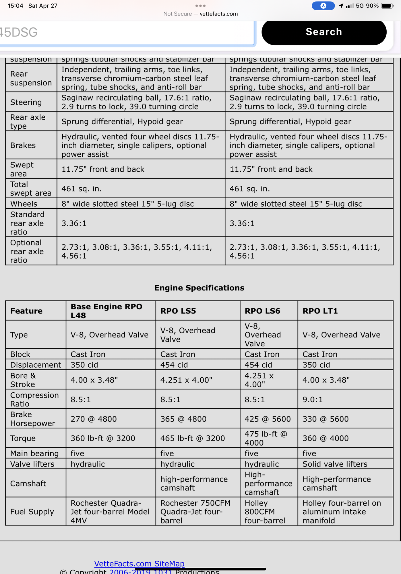

1971 engine specs
1972 engine specs
This is a comparison between basically the same engine, rated in gross…1971 and net…1972.
Hope this helps.
Prior to 1972, American carmakers used the SAE (Society of Automotive Engineers) “gross” measurement of horsepower. Gross meant the figure was taken from an engine running on a test stand, with no air cleaner assembly, accessories or exhaust system connected.
By 1971, carmakers began reducing compression in many engines in order to meet upcoming emissions requirements and to use unleaded fuel. General Motors and Chrysler began advertising both gross and SAE net figures in 1971, derived from an engine tested with air cleaner assembly, accessories or exhaust system connected.
source

1971 Chevy specs. They rated the same engine both ways.
