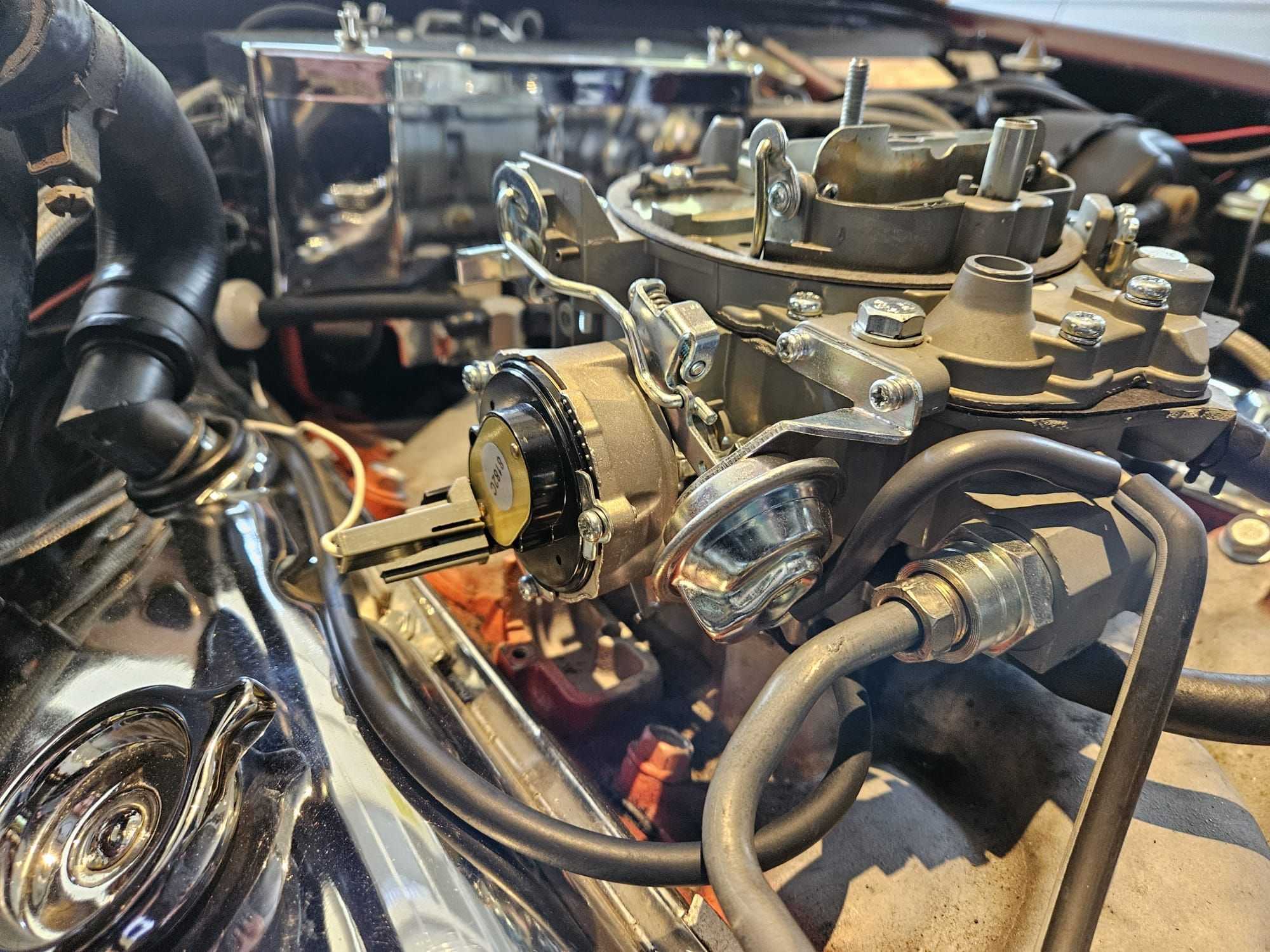

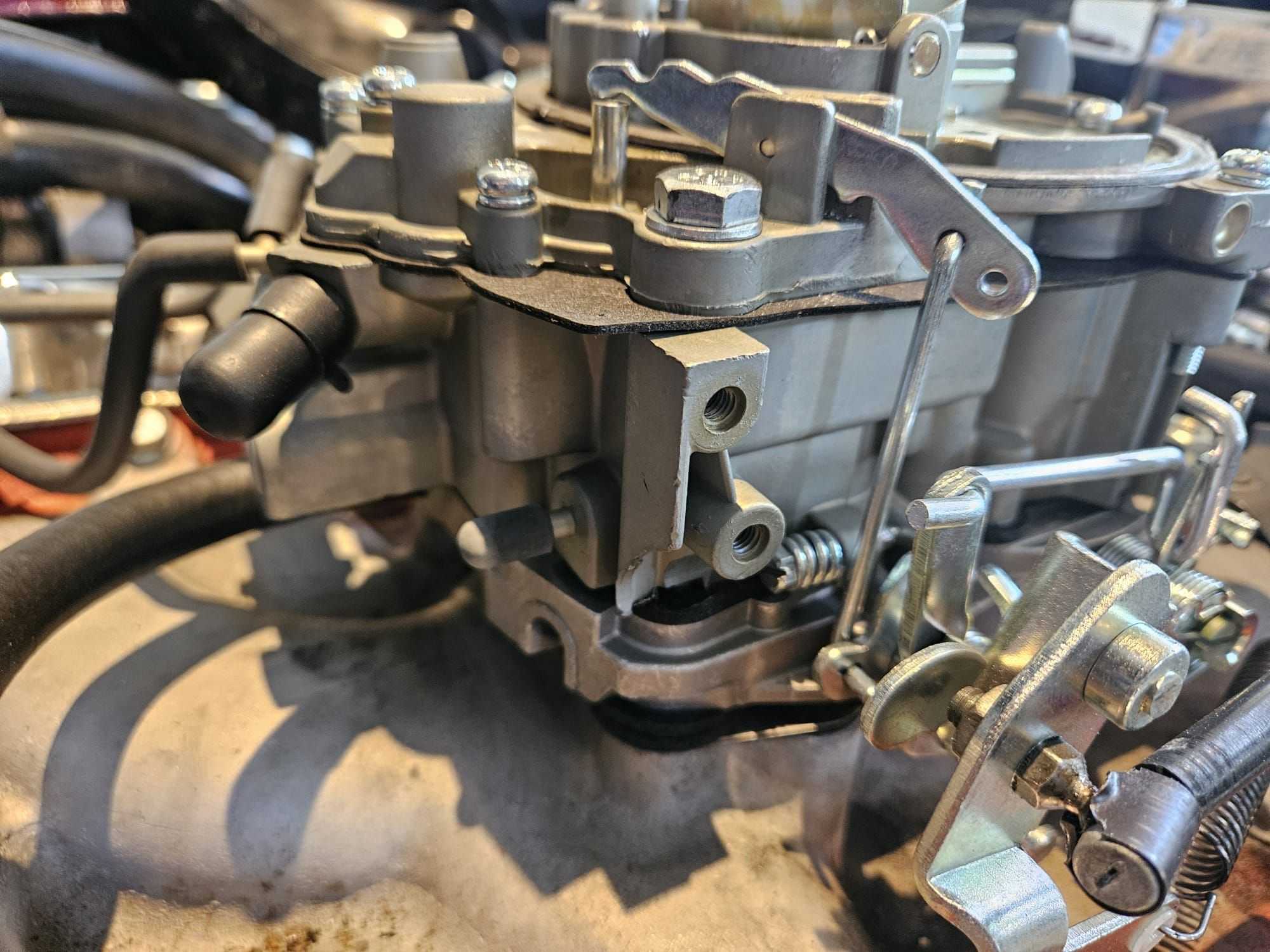

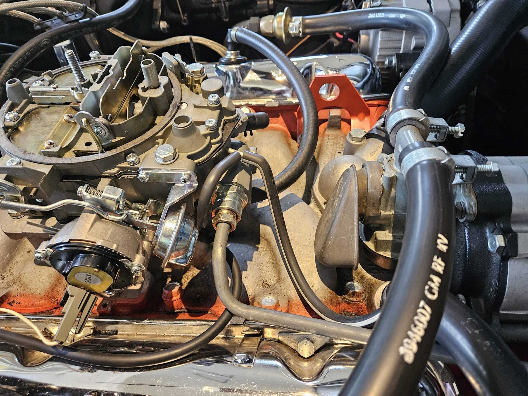

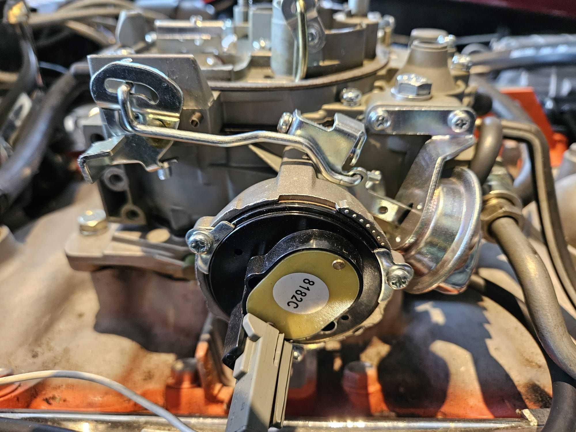

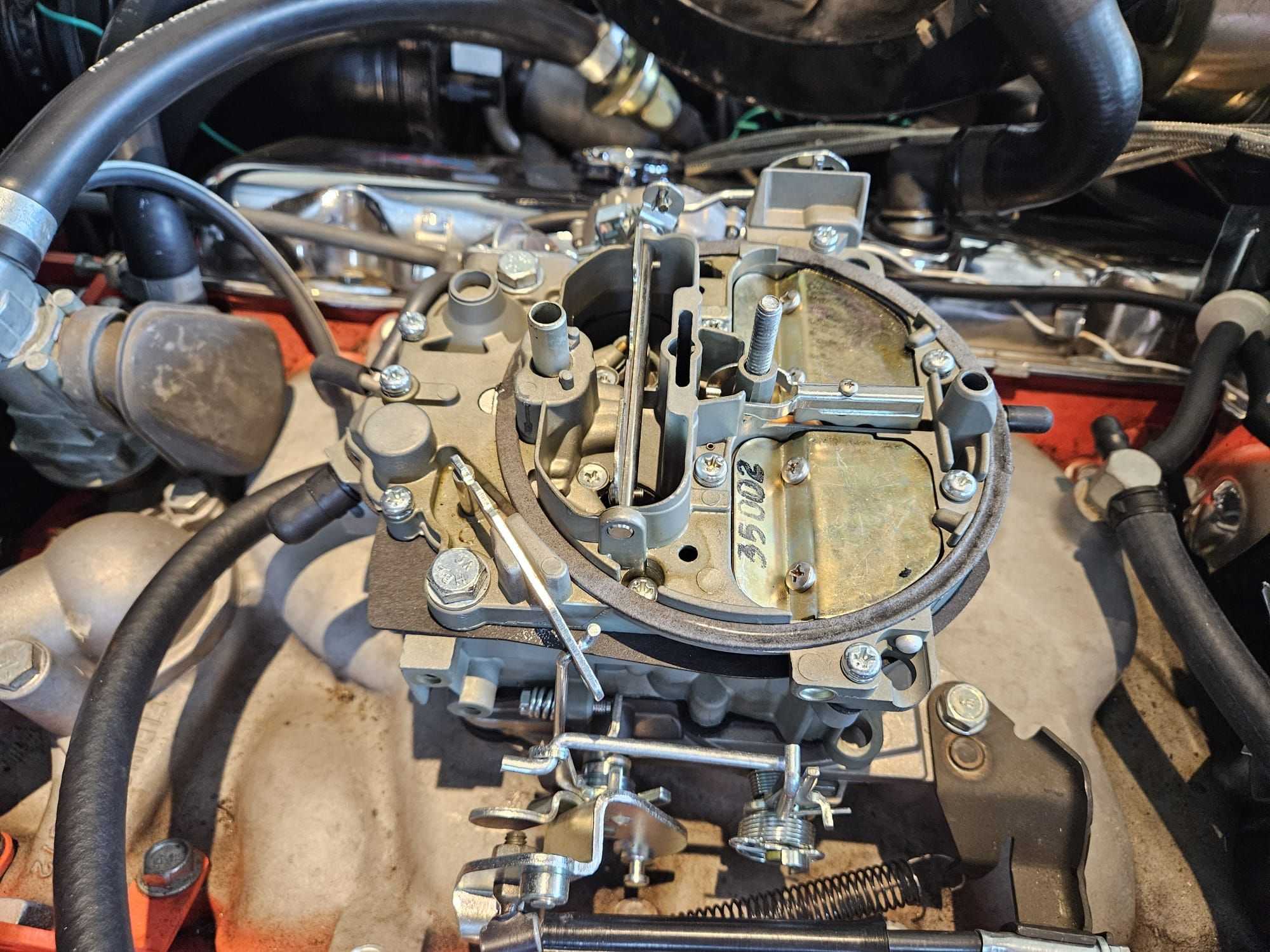

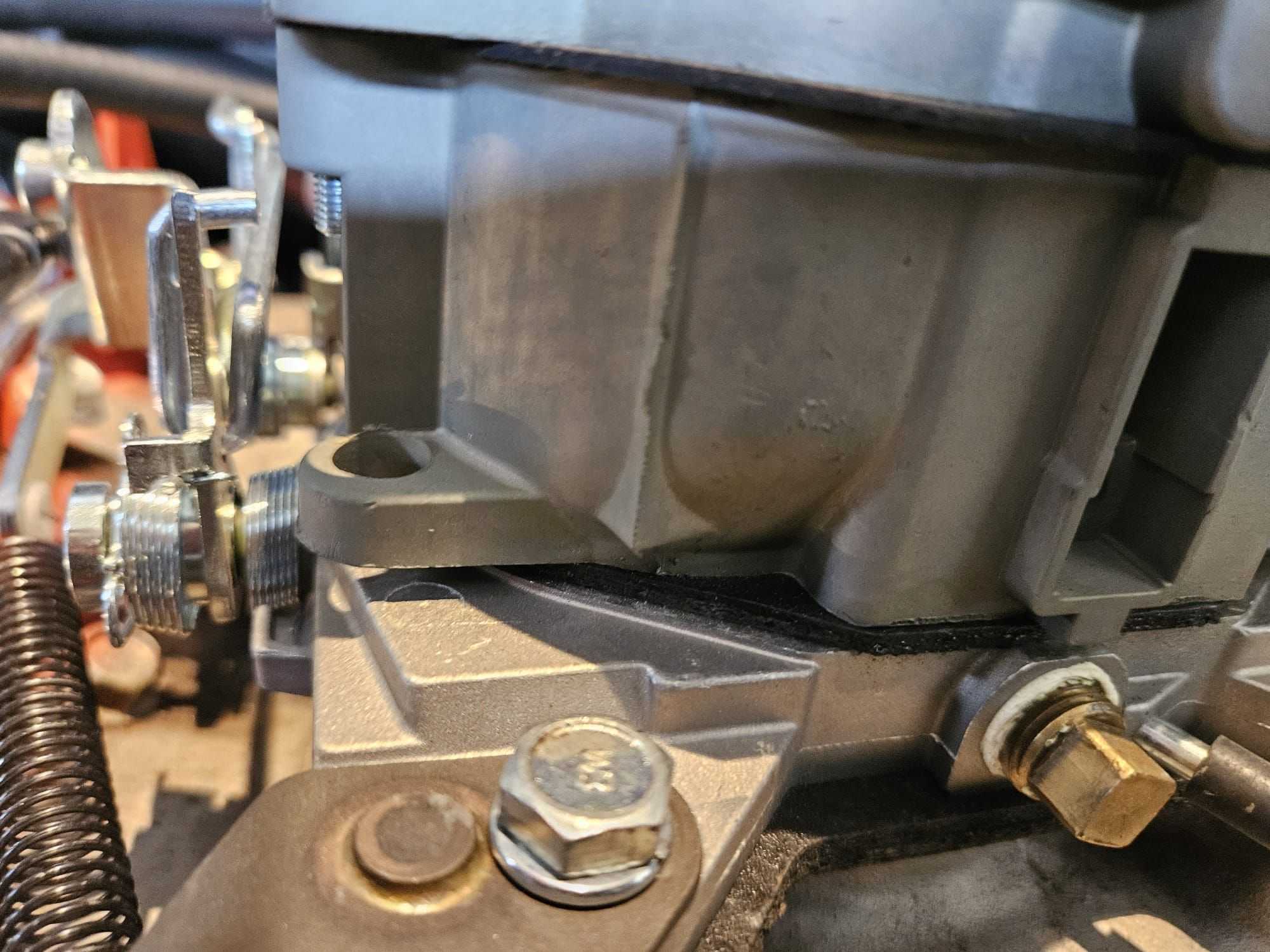

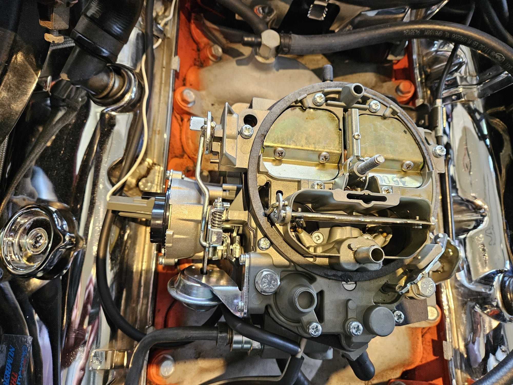

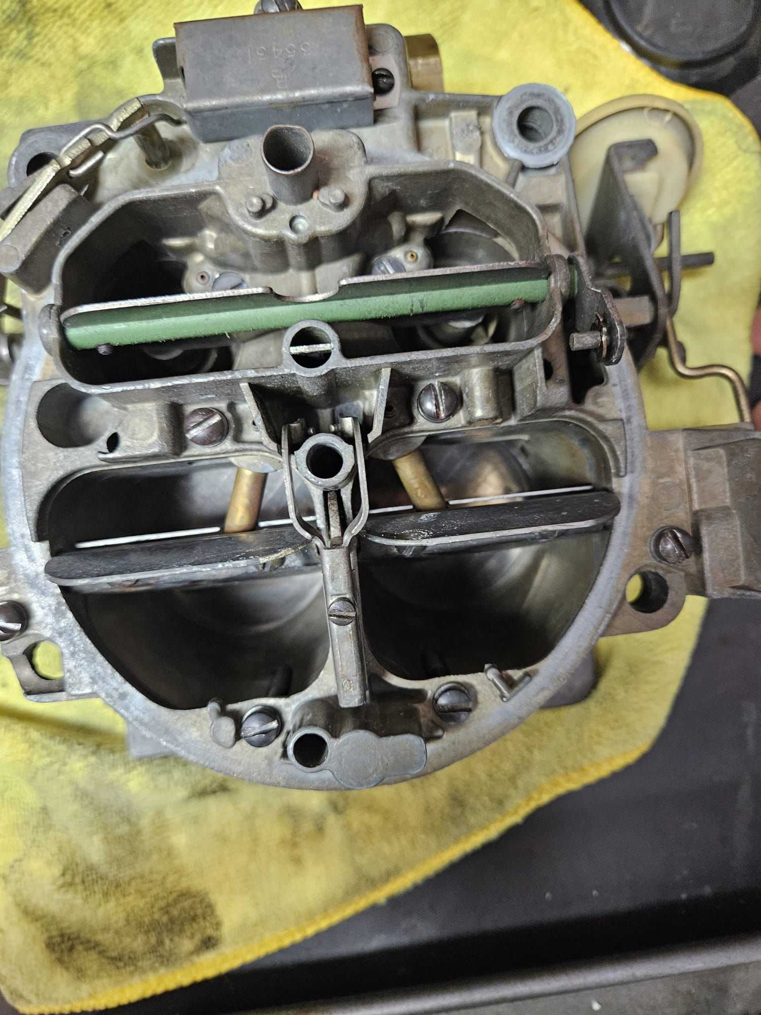

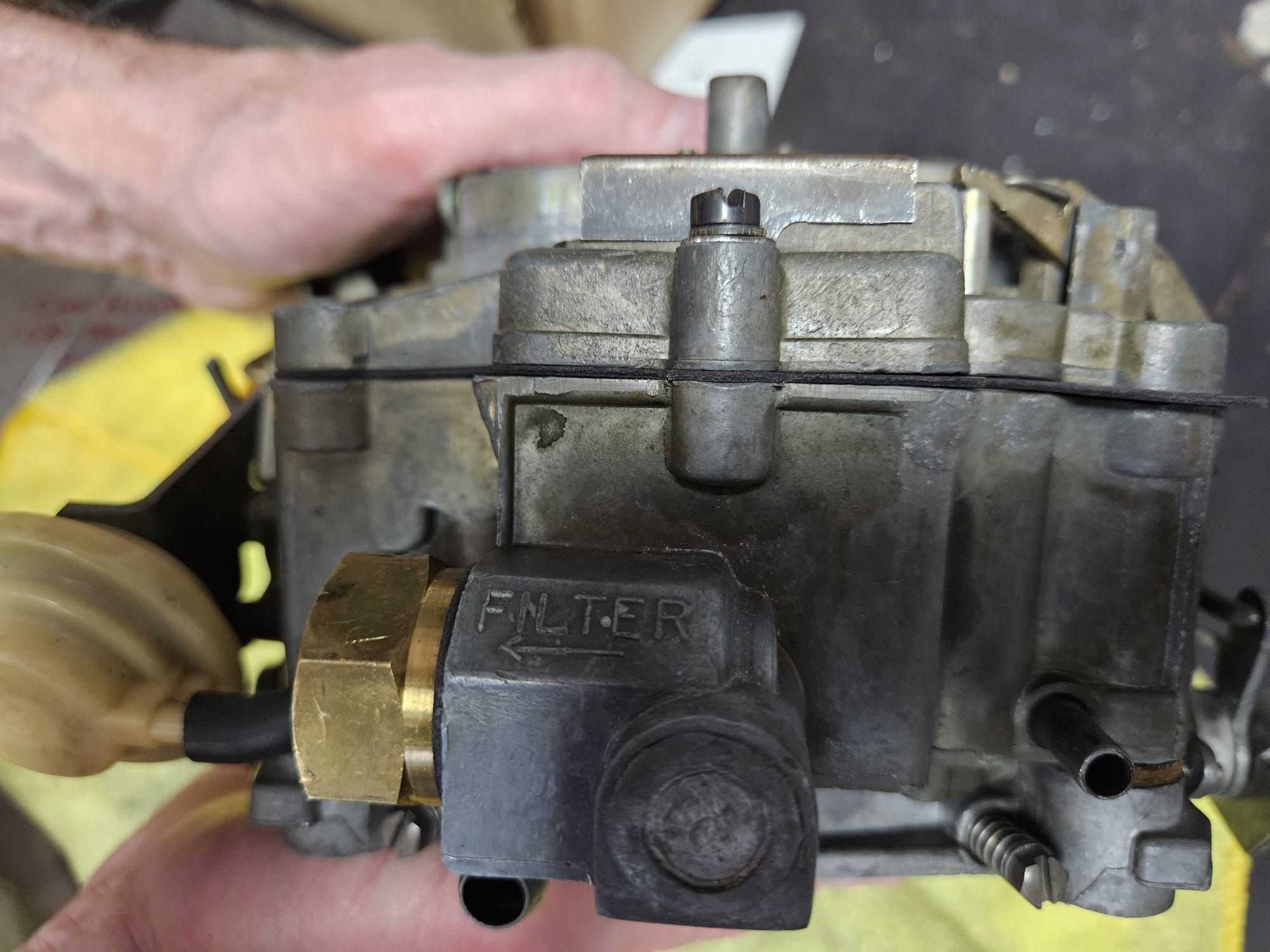

Default Pictures of Carb
Hi All
Thank you for your input. Sorry for the delay I was on extended business travel.
I have attached pics as requested.
It looks to me like there is a larger gasket already installed. I ordered heat sheild for the fuel line today to see if that will help.
Best,
Hans

Old May 25, 2024 | 01:22 PM
lars's Avatar
lars
Joined: Aug 1999
Posts: 14,380
Likes: 6,391
You have a commercially rebuilt, hacked carb that likely has a long list of problems. E-mail me for my paper about the commercial carbs to get an idea of all the things that will be wrong with that carb. And I assume you know that it's not a '68 carb or even a correct 4MV model-series carb... it's a 1980's vintage M4M truck carb.

One more thing: If you have the original 1969 intake, be aware that it requires the use of a special 3-piece gasket "set" between the carb and the intake. Failure to use the special gaskets, with the stainless steel middle gasket, will result in exhaust gas ingestion into the intake, vacuum leaks, and the bottom of the carb getting so hot it will boil the fuel right out of the carb and cause damage to the bottom of the carb.
Post some photos of the carb you believe to be the original carb. The '69 427 carbs are very good... And very rare... They sell for around $2K in rebuildable condition. I can tell you if the carb is correct and if it is a good candidate for rebuild. Post the carb number as well.
Lars

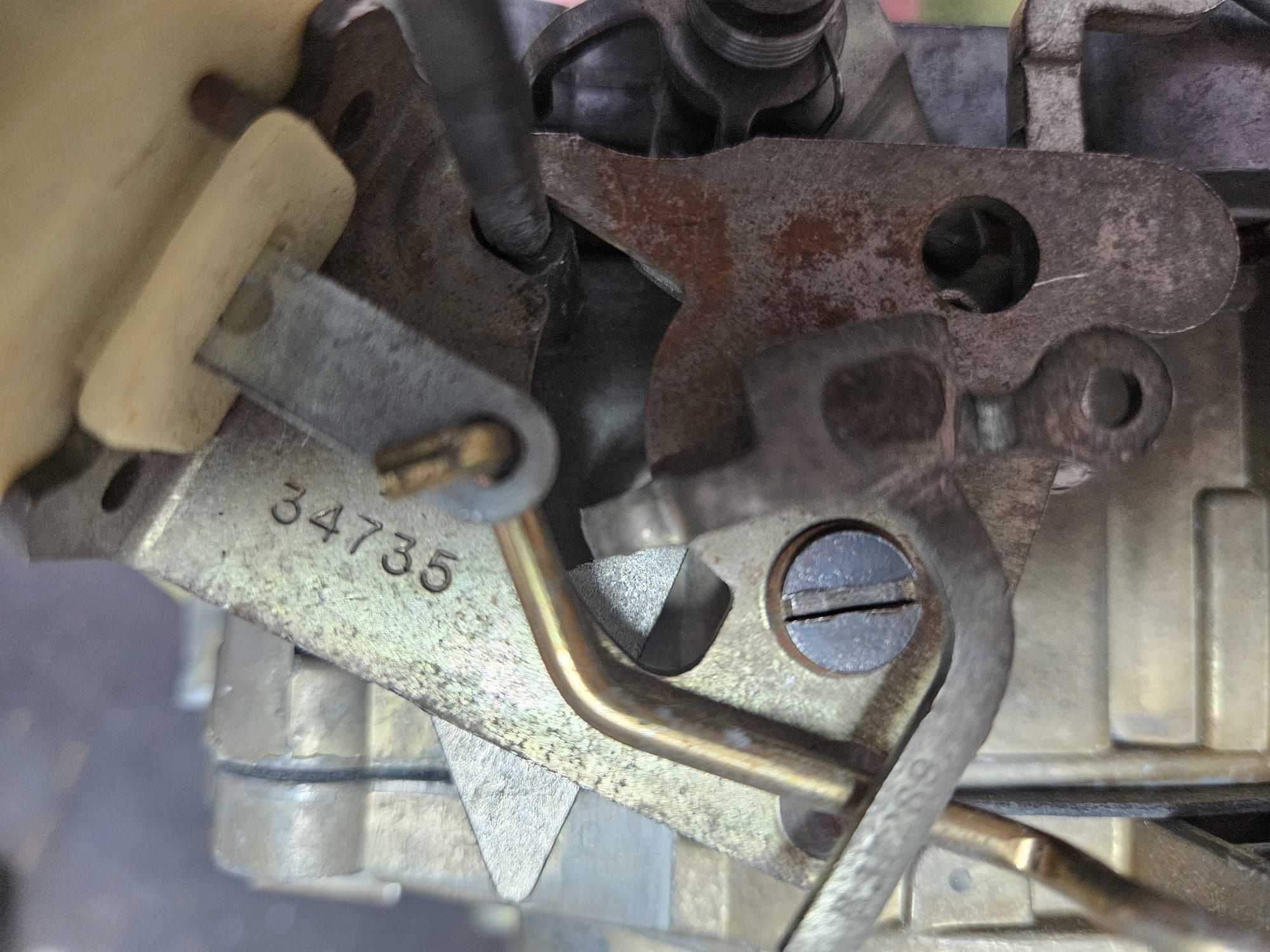

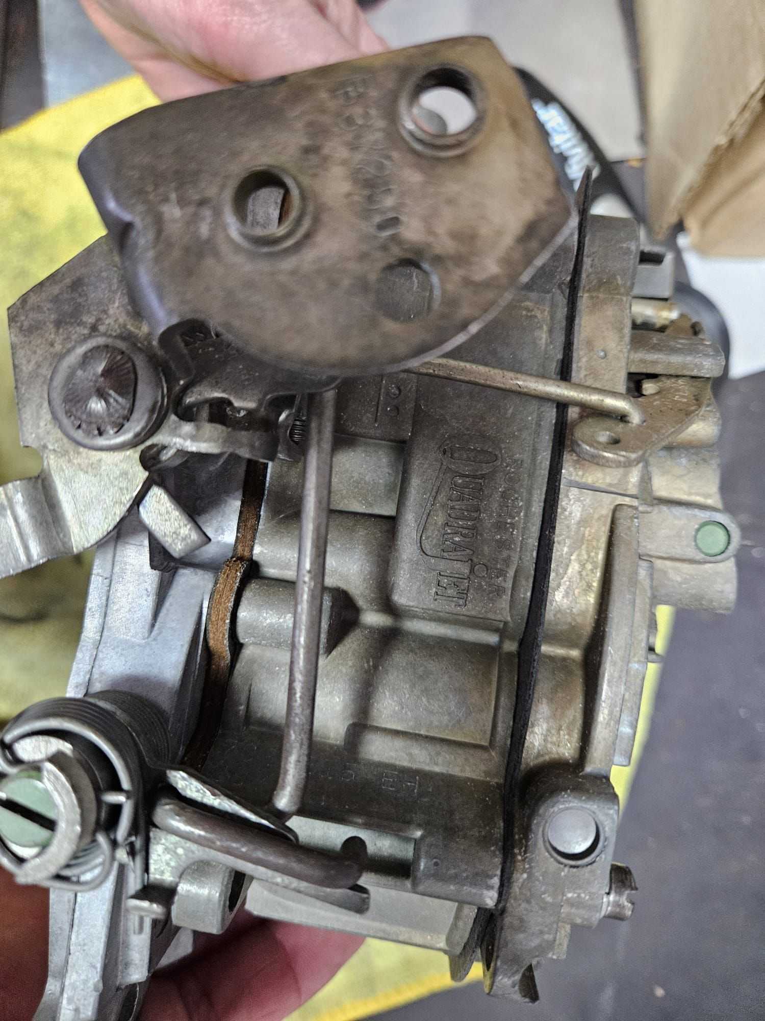

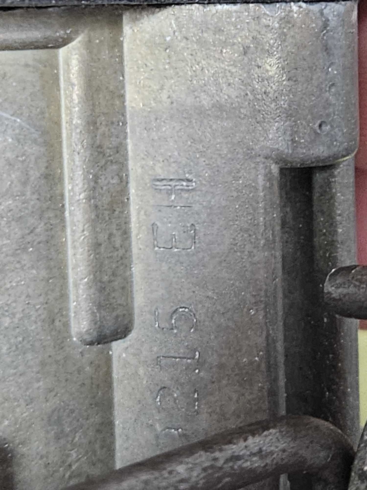

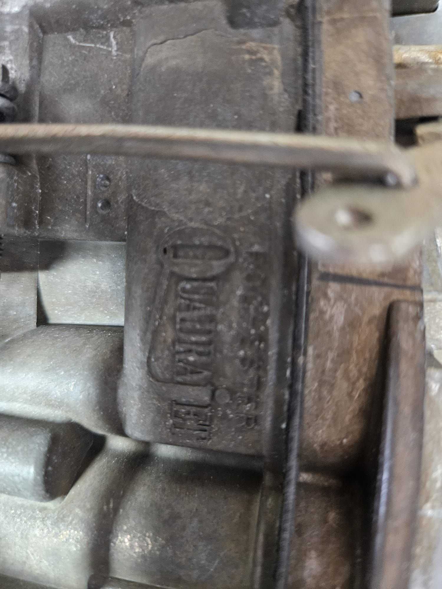

Default Original Carb Pics
Hi Lars,
Here are the pics of the original carb. My vette was born in November 69 all other numbers are matching. The only thing I did not have was an alternator, but the kind folks here helped me with that. On the side, stamped into the body (not on a disc) is “7029215 EH, then below that “2979”. From what I can tell, this tells us its from the late 60’s (702), produced in 1969 (9), it’s a QJ 4 bbl meeting Federal standards (2), Chev division (1) and the 5 is an odd number indicating a manual xmission. 2979 means it was produced on the 297th day of 1969.
Other identifying numbers:
  • On one of the base ears: 37983
  • On the base in a circle: 7037600
  • Back near the secondaries in a circle: 7038524 and “GM” and “RP”.
Old May 26, 2024 | 06:35 PM
lars's Avatar
lars
Joined: Aug 1999
Posts: 14,380
Likes: 6,391
Your 7029215 carb is a Q-Jet used on 1969 Chevy, Chevelle, Camaro and Corvette 396 and 427 engines with manual transmission. It was built on Friday October 24th,1969, which makes it unlikely that it was ever installed on a 1969 production car. It has been commercially rebuilt, so it is likely to have multiple problems, which is probably why it was removed from the car. If the carb still has it's original throttle plate and has not been hacked too badly, it can probably be repaired and brought back to serviceable condition. I did not see any photos of your intake manifold mounting flange configuration - are you using the correct 3-piece gasket set for the '69 intake?
To 69 427 4bbl Idling Issue

Old May 27, 2024 | 11:01 AM
lars's Avatar
lars
Joined: Aug 1999
Posts: 14,380
Likes: 6,391
If you have a '69 that was built in Nov '69, the carb would likely be correct. That's a very late-year model car...

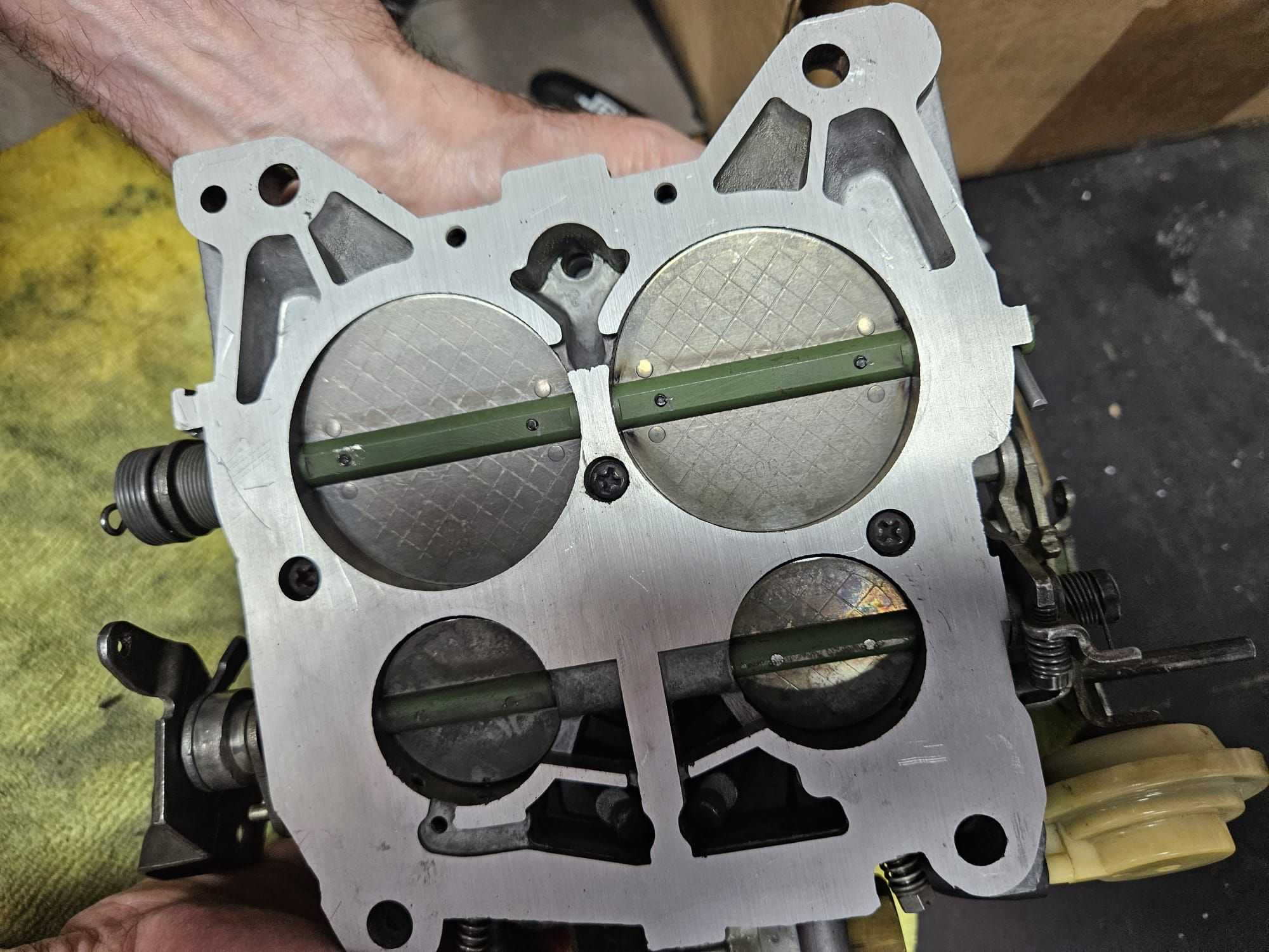

I have for the past couple of years wanted to get the original #s matching Rochester QJet back on, from what I understand from the P/O it was the one it was born with.
Following the above discussion thread, I sent it along to Lars to see if he could save it. I have received it back last week but needed to get a Divorce Choke and a proper spark advance vacuum hose set up as the "truck carb" had an e-choke installed and the vacuum line was not correct for the 69. Just got those in so I will be installing it this week. Will post some picks of the install and how she runs later. For now, I am posting the process and Lars' findings (some screwy stuff!! Like a spring from a ballpoint pen....)
The elapsed time including UPS ground shipping to and from Virginia to Colorado was a mere 16 days the actual work by Lars only took 3 days the rest of the time was shipping....
One item of note for those seeking a Divorce Choke for a 69 427/390 or likely other carbs, I did manage to find it in a "kit" will all parts included (instead of having to buy it in pieces) at Carbs Unlimited https://www.carburetion.com/
First - Review of Initial Findings.
I have your carb torn down and ready for ultrasonic hot tank cleanup. The following issues were noted:
  • Commercially rebuilt carb
  • Warped airhorn - airhorn gasket not seating/sealing
  • Fuel filter installed in carb - you are running 2 fuel filters in series, which will cause a high-rpm fuel starvation problem. I will omit the in-carb filter upon assembly and credit you for the filter not required
  • Badly misbalanced idle mixture settings
  • Incorrect secondary rods installed
  • Lock washers installed on airhorn hardware, damaging the casting. Lock washers were not used on 4MV carbs
  • Accelerator pump not fuel compatible - diaphragm collapsed - pump inoperable
  • Incorrect power piston spring installed - spring is from a ball-point penand has the power piston locked in the full-rich position at all times
  • High float setting - contributing to fuel leaks
  • Idle vent valve bent and altered to remain closed at all times - valve inoperable
  • Secondary throttle linkage altered to open secondaries over-center

The carb checked out really well after repairing some significant items and correcting some setup issues – see attached invoice for a listing of all issues found and corrected.
The tip-off to problems with the carb was the fact that the secondary throttle shaft had been removed by the previous builder and re-installed with aftermarket screws. The secondary throttle shaft was binding severely, and would jam in the wide-open position. It turns out that the builder had installed shaft bushings on the secondary side, which is a very odd thing to do - the secondary side should never need shaft bushings... Further, they had not reamed the bushings to size, so the secondary shaft was severely binding in the bushings. After I did the machine work to the bushings to make the shaft fit, it was obvious that the shaft was also bent, so I straightened the shaft. Once assembled, I attempted to align the throttle blades in the secondary throttle bores, but they would not align properly in the bores for a good seal. Testing the carb in its "best-aligned" condition confirmed that the carb had an inherent air leak through the secondary throttles at idle. This may be the "carb leaks" comment that you have received, and is probably what they improperly attempted to fix by installing shaft bushings. I replaced the throttle blades and obtained a much better seal - the carb showed a significant improvement during test, but still suffered from a fuel "dribble" on the secondary side at idle. This made setup and tuning impossible. After assuring good alignment of the replacement throttle blades, I did the Pontiac "trick" with the secondary airvalves to eliminate any low pressure region in the secondary venturi plenum, which also provides a much better secondary fuel enrichment "shot" when tipping into the secondaries. I removed your stock airvalves and fabricated a pair of airvalves to the Pontiac spec, so your original airvalves and throttle blades are being returned to you with the carb. This solved the secondary "leakage" problem, and the carb is running perfectly with an outstanding level of performance and throttle response.
In this configuration, I ran the carb through all modes of operation from cold-start, hot re-start, idle, and no-load cruise. I also tested for secondary operations and WOT transition. Idle is glass smooth, off-idle response is crisp, and mixtures are right where they should be.
