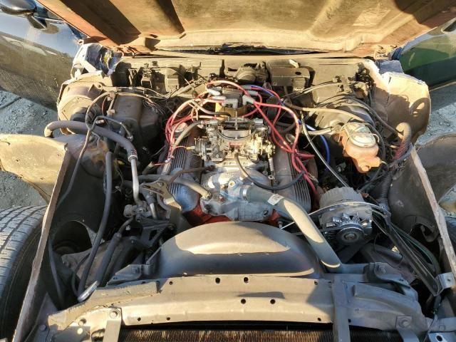

i recently found on copart a 1981 vette that was wrecked and im thinking of buying it. But i have some questions the engine does not look factory. I have no pics of stamps or anything but i have a photo of it if anyone might be able to have a clue. I would probably be dropping it into mine, so im also wondering if itll mate with my manual. I think it will since it looks like an SBC with the four bolt covers, but i wanna be sure. Any help maybe getting a clue of what this engine is would be greatly appreciated.

Could be any Gen 1 SBC ever made, no way to tell from that photo. Most likely a 350 since there is no oil tube on the front. If you are only buying that car for the engine then it had better be cheap.

Edelbrock 1406, and perimeter bolts on the valve covers? There's a 0.1% chance that engine has a roller cam.
I can't see the dipstick, but the listing shows it as an automatic. The engine will bolt right up, but no spare parts.
