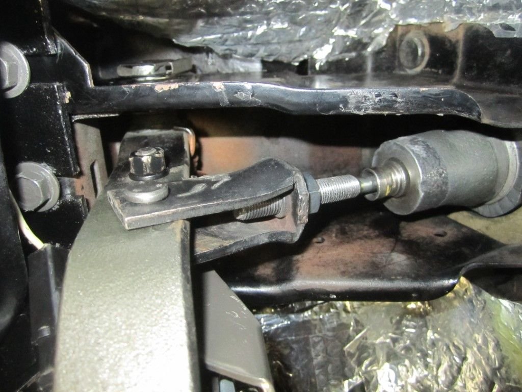

On mine, the pushrod ended up here
but that's not meaning yours would be the same
