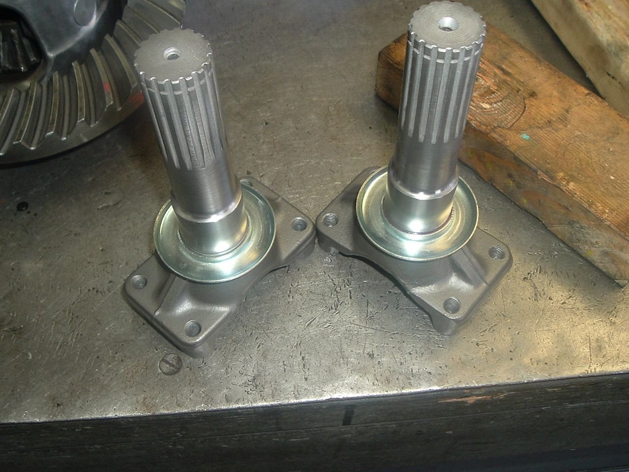

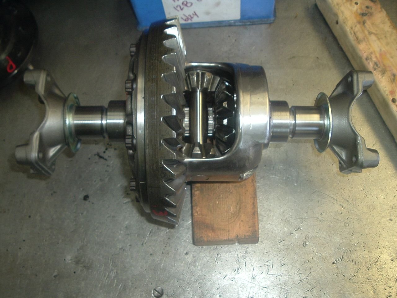

Some have asked what I use in my diff builds for 17 spline axles.
Most of the time, they are ones I have off my shelf that I have prepped. They are GM, non-tipped, non-cored, thru-hardened, and cryo treated.
No, I don't sell these direct, just in my builds. I think they're best out there and in standard or HD.

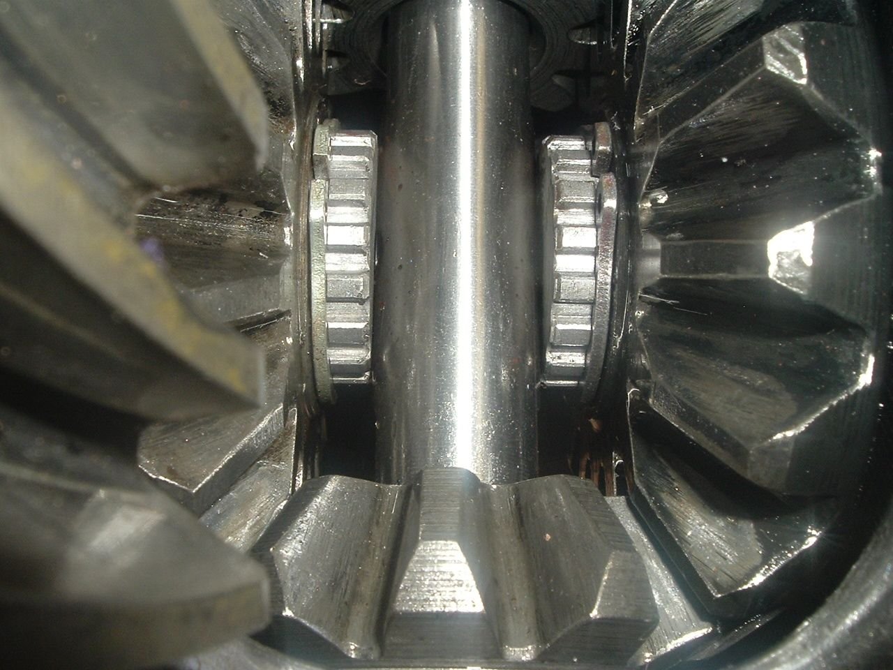

These I just finished yesterday. 005-008" endplay in a polished, tuned, milled, and cryo treated posi.
Good luck.

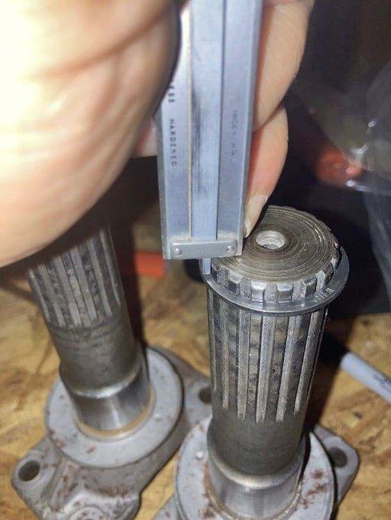

What do they measure from the tip to the c-clip ? I would like to compare to what I have to see how much wear I have vs new / rebuilt.
0.185 is what i learned here
https://www.corvetteforum.com/forums...-advice-2.html
