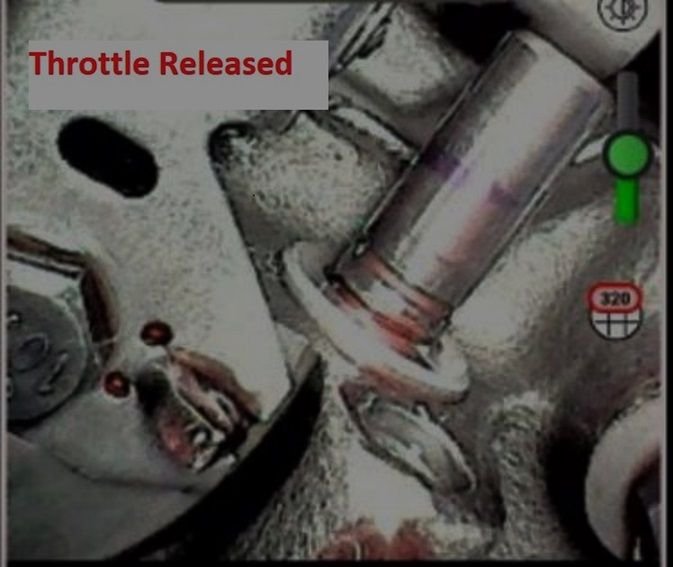

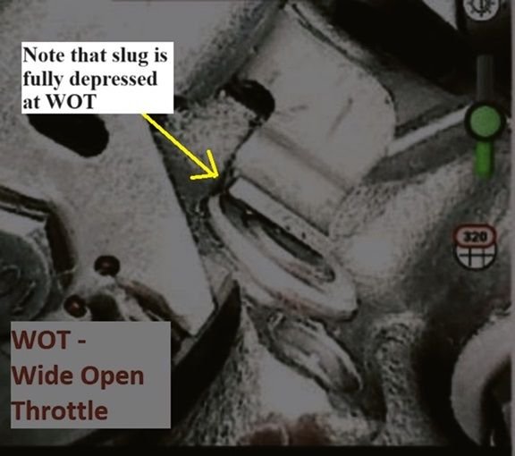

See the pictures below.
If I would have thought about it I would have used my USB Endoscope camera initially. I already owned one. They're only a couple of bucks on amazon.
When the throttle is released the lever should just be "kissing" the slug.
I made a mark on my slug just to see where the midpoint was.
When at Wide Open Throttle (WOT) the slug should be fully depressed.
You will note that this is dependent on the travel path/distance that the cable covers as throttle is opened. My Ramjet 350 already came with the appropriate setup so once I had the camera setup it was easy peasy..... the pressure gauge I had installed to being with let me know I was not dropping pressure to where it would damage the tranny.
I will attach a separate picture of the throttle body & cable so you can see what I mean.
I hope this clear. If you're curious, and have a boneyard nearby you can go eyeball some 80s cars with TV cables but really somebody here will have a picture of Q-Jet being used with a TV Cable......
