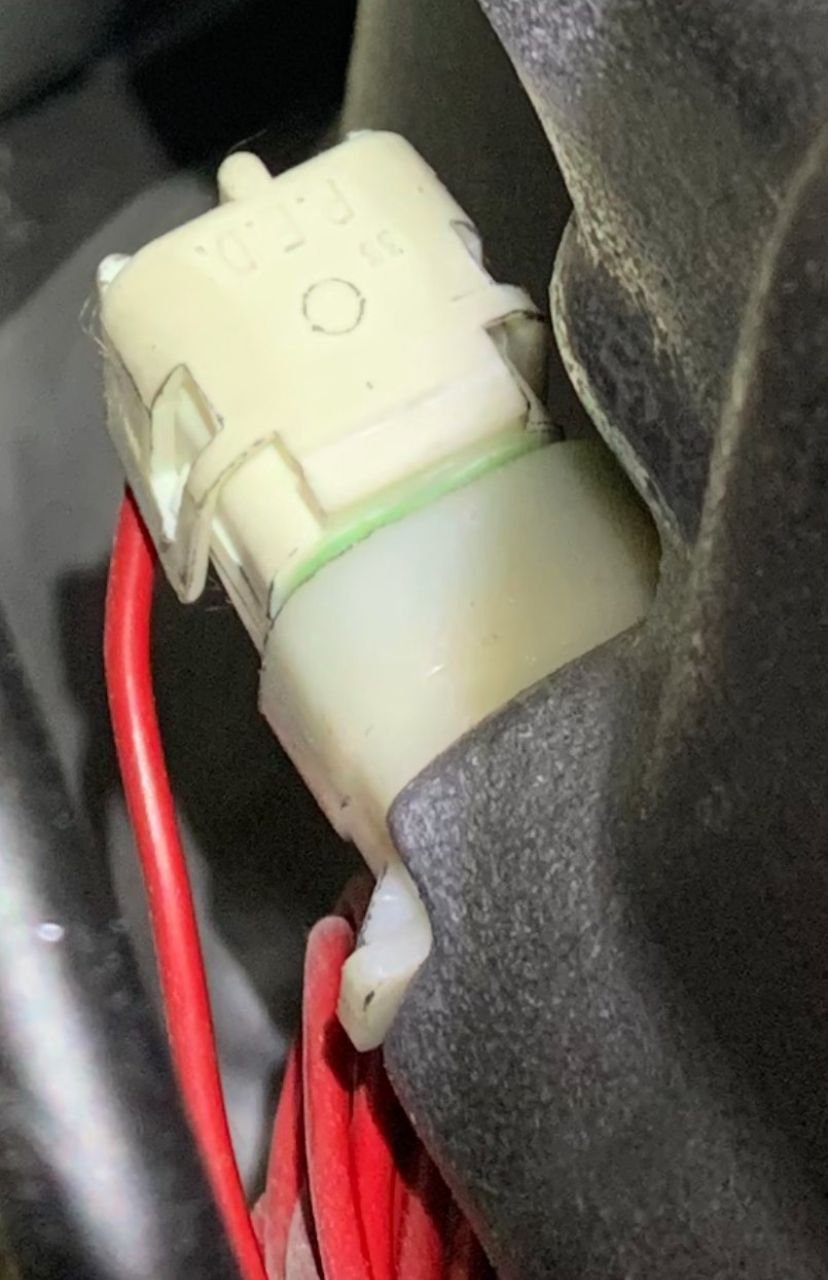

Not hooked up but on the tranny.
Where does it get connected/wired in?

It's the wiring for the torque converter lockup. But there should be three wires not one and not red either. Being that connector on the transmission looks kind of newish, somebody did some finagling. Regardless you going to have to drop the pan and see how it's wired inside. There's a good chance and I'm only guessing there was a normally open switch installed in the fourth gear pressure port and that red wire goes to 12 volts. Normally the 82 CFI has two normally closed pressure switches in the 4th and 3rd gear pressure port. What I'm seeing here will not work with the CFI's ECM. What I had in my 700r4 was TransGo 700LU kit which locked up the converter without any electrical and is what I would recommend. It works very well but only works with earlier valve bodies that are bored for it. From the 82 factory service manual:

Thank you for confirming.
I know that there was an upgrade to petronix as well.
Would that change anything?
Sorry for not knowing more, but things were done without my knowledge and I cannot ask for clarification.

It may, do have the CFI system or has it been changed to to something else?

On further inspection:
apparently my newly rebuilt (numbers matching) transmission was removed; and there is a 700 in its place.
Is this a torque converter to the brake?
Also now on a search for my original transmission that I did NOT realize till now has gone missing!
