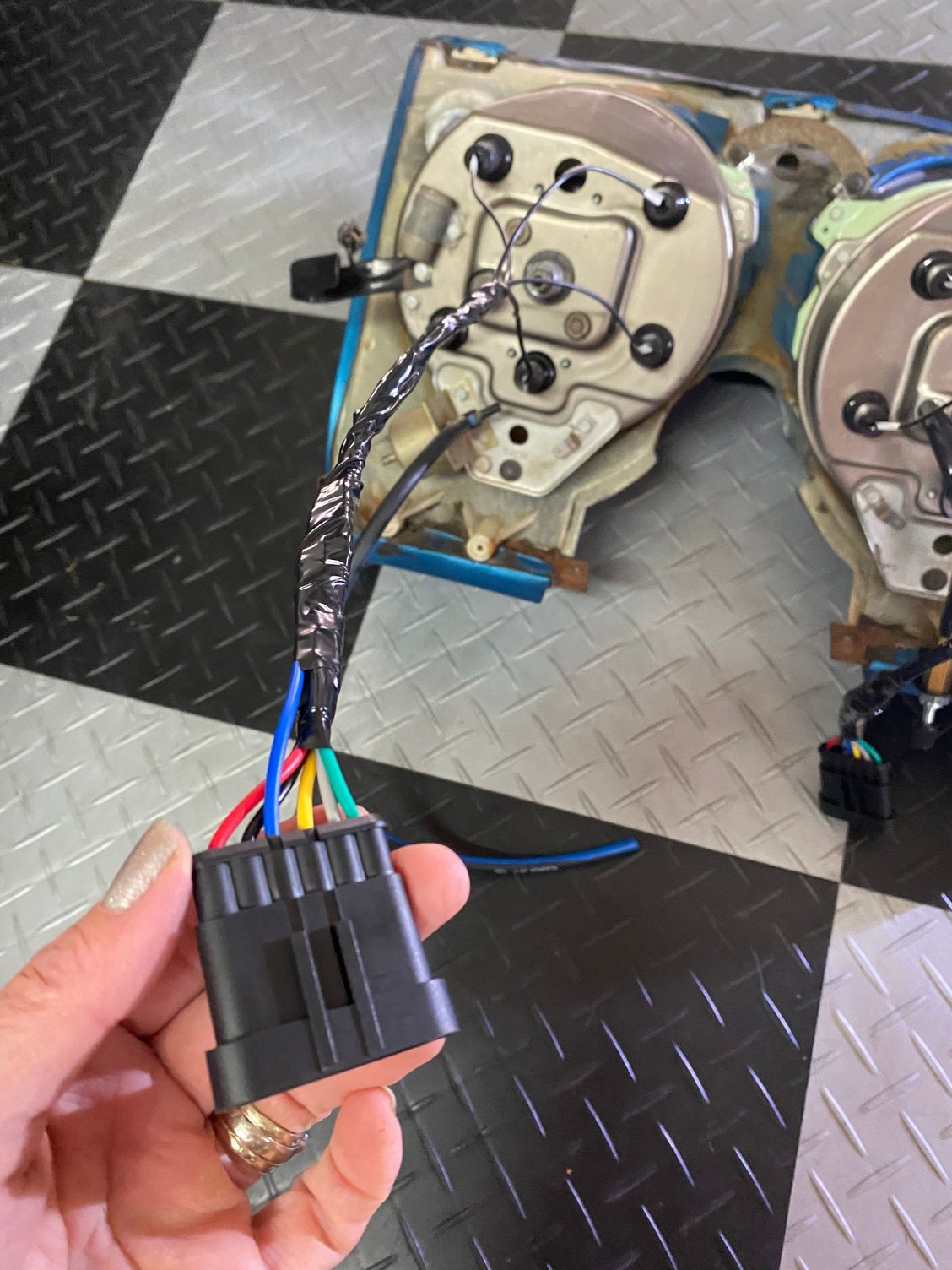

Got a major project I have been dreading done yesterday.
With the quick connects I made as well as the new bulb holders, it was not that bad at all. Vintage air ducts got in the way for sure.

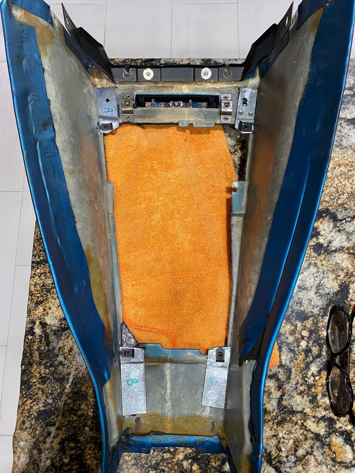

Today was spent prepping shifter console. Typical tab repair.
the repair set I bought all but one went missing in NC. Figured I would save myself $40 and fabricate our own.
Seems like it will work and made sure it would not hit the VA/vent bracket.
Hopefully we will have all the shifter and center gauge console/radio installed soon.
HD had these for around $11
Easy to cut with tin snips.
Had to trim the corners to avoid hitting the original bracket that held the vent ***** and will house the new VA controller.
