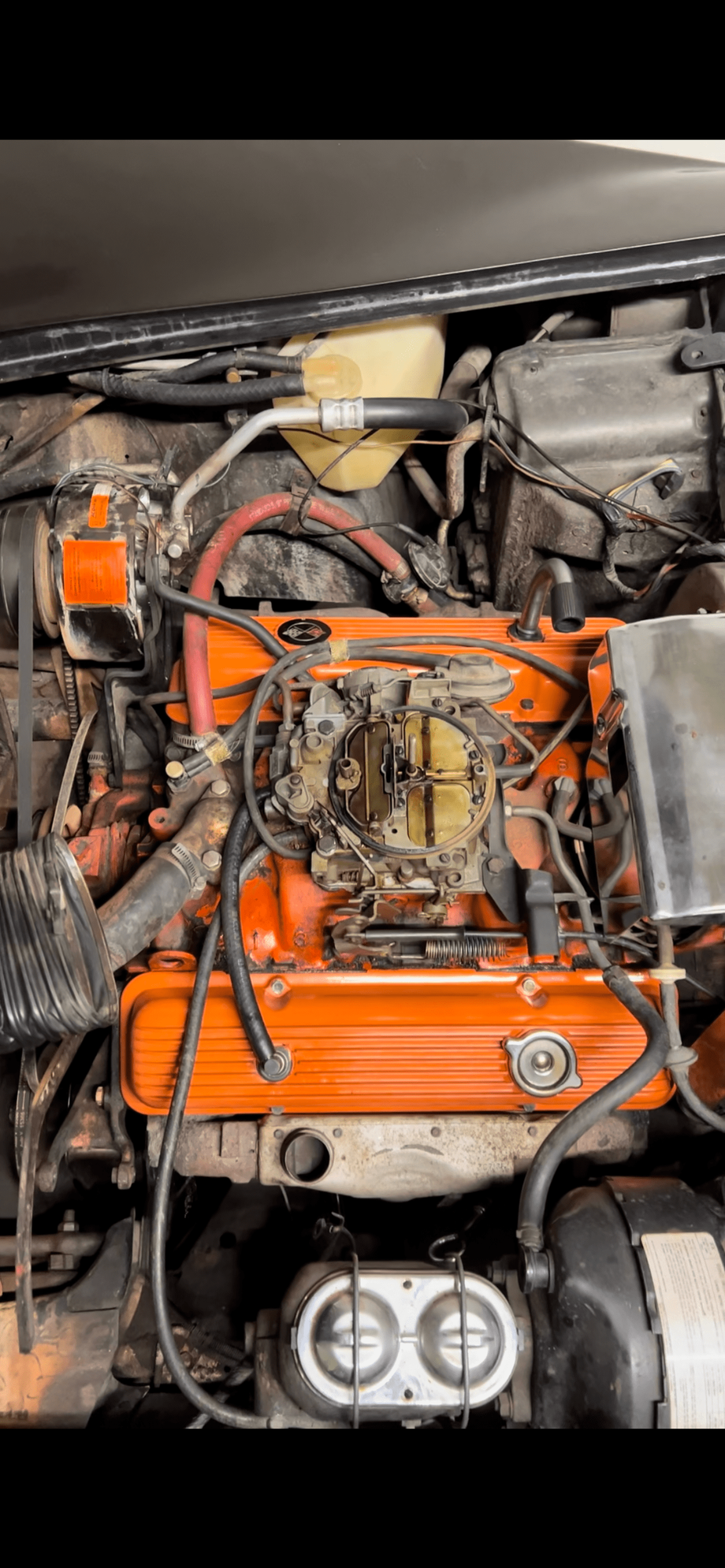

TLDR:
  1. is the Edelbrock Performer Series 750 CFM Carburetor with Manual Choke able to replace the quadrajet without issues?
  2. Would this carb need a spacer for very hot weather? here it can be more than 98deg.
  3. For the valve cover breather that returns to the quadrajet air filter, i need to replace with another type of valve breather?
  4. What will i do with the metal tube going from the airfilter to the driver side header?
  5. With a new setup should i close the EGR? The next step will be to get new headers.
Ive done some gasket replacement work on my C3, 1974 L-48 5.7L 350 sb. Im ready to upgrade my carb to something with more performance and that can also handle the spanish heat. Today it is over 98 deg. I have the stock quadrajet setup. Ive been looking at this carb, and would like to know if its worth buying.
https://www.jegs.com/i/Edelbrock/350...7L+%2F+350+%29
Also what other changes i need to. make for this upgrade. In the original setup there is a valve cover breather that feeds back into the air clearner, correct me if im wrong. But with a upgraded carb i wouldnt need this i suppose, i would need to replace with another valve cover breather that ive seen on other vettes around the internet. Ive also seen some vettes that had the EGR closed off, is that recommended with an upgrade as well? what would i do with the metal piece that connects down to the header on the driver side?

Edelbrock would not be an upgrade in my book.
You really cant beat the Quadrajet for all around use and performance for what looks like a stockish engine.
If your Quad is not all butchered up and IS a factory piece(not a remanufactured unit)you cant go wrong.
With good parts and some knowledge they are not hard to work on. Just need to do things right.
If that scares you,Lars here on the board is the resident guru(amongst others) and should be by soon for a look see and some sound advise.

Hey, welcome to the forum. We bought a '72 about 8-9 years ago that had an Edelbrock on it. It was okay, but not good/great. My good friend inherited a '71 with an Edelbrock on it. It was absolute junk.
I agree with the advice above. If you have the original Qjet send it to Lars (do a forum search) and pay him to rebuild it. If you don't have the original Qjet or someone has put some other junk carb on it, find an original Qjet and send it to Lars and pay him to rebuild it.
People who say they can't get a Qjet to run really well just don't know them. They are GREAT carbs when they're set up correctly. IMO going to a Ebrock with a manual choke is a huge step backwards. Lars is the guru. He's a Qjet whisperer.

The Quadrajet is a spread bore, the Edelbrock is a square bore. The Edelbrock will not fit the intake and there is no benefit to switching.

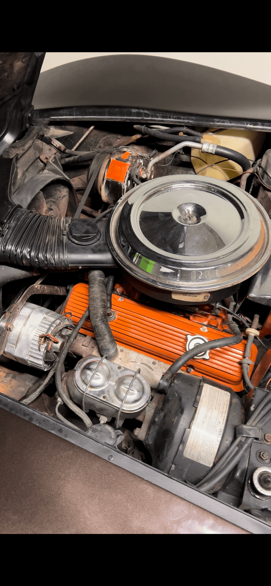

@MelWff if i go the quadrajet route, is the old air filter setup my only option? Ive seen other builds with holley/edlebrok and their round filters that look more like race style

Doesn't your stock air cleaner have a duct to feed cold air to the carburetor? That's the way to go.

yes it does! okay good to know
