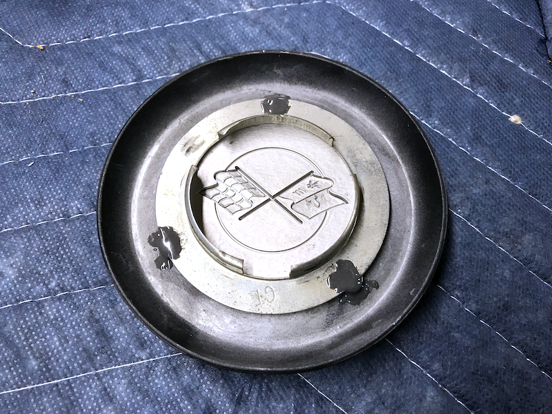

Very curious how yours broke. Can you post pics of the pieces - especially the backside of the large main ring?
If it's like earlier horn buttons, there are three "pins" cast into the rear of the main ring that are peened after the parts are assembled. Kinda like rivets. I disassembled mine to paint the metal and polish the emblem, then used JB Weld to reassemble since the "pins" were drilled out to remove the emblem.
