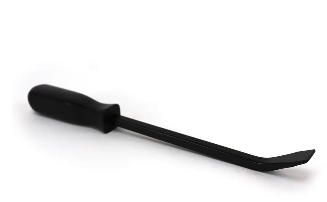

Yep, but it’s fun. Helps to have the tool.

Thanks for the reply. I’ll search for the tool you referenced.
EDIT:
Door hinge spring and tool found. Ordered from Corvette Central.

Yup door spring. Very easy to replace. Bought that tool many years ago. It comes in handy for all kinds of weird things!

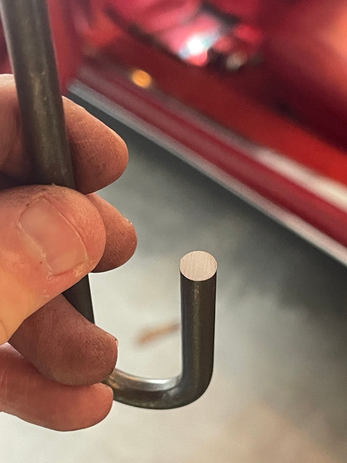

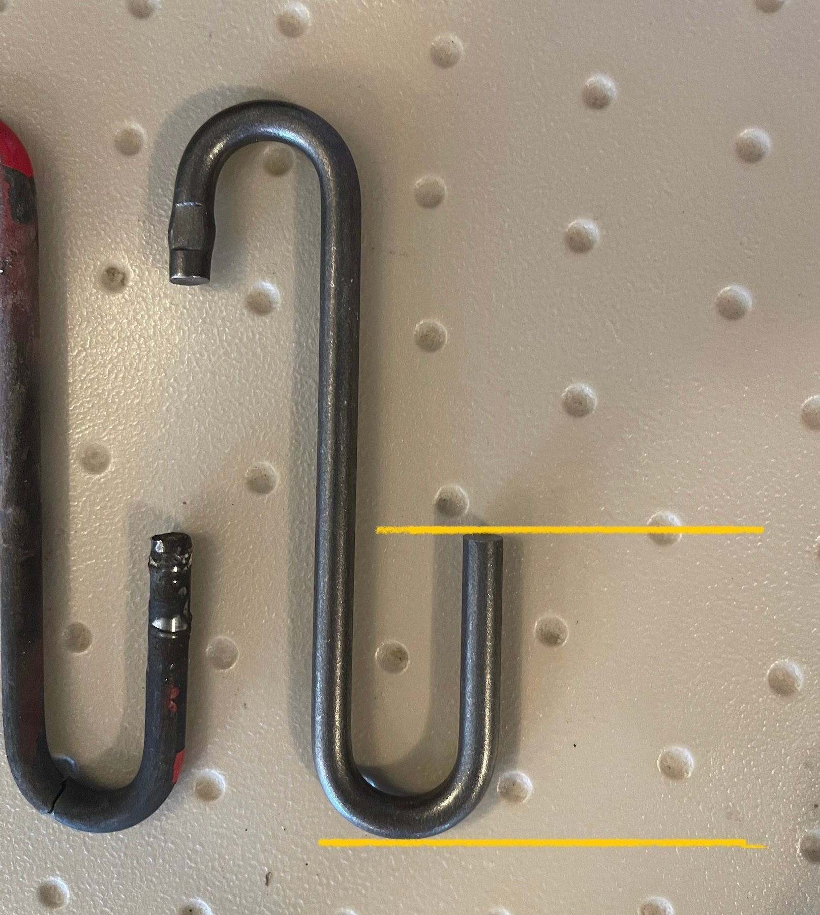

I CANNOT get the spring to line up with the lower slot. I can get it in if I rotate the spring out of the upper slot, then I can’t get the tool in there. I laid the old and new spring on top of each other and they’re identical.
EDIT:
The new spring was NOT identical. The lower leg was longer than 2 1/8”. A little grinding and the job was done in 5 minutes. Thanks WILCOX video!
