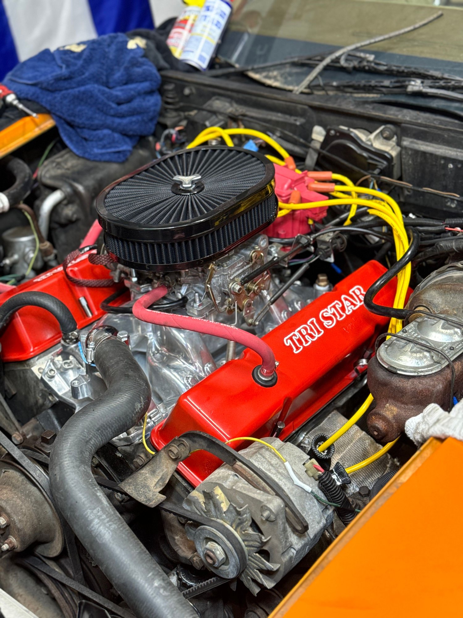

That setup looks great. The “learning” aspect is something i still find as questionable but the ability to look through numbers and edit them on a screen rather than messing with mechanical things. It’s the unfortunate part of my generation not having any experience with that, but plenty of experience with moderating fuel injection systems.
