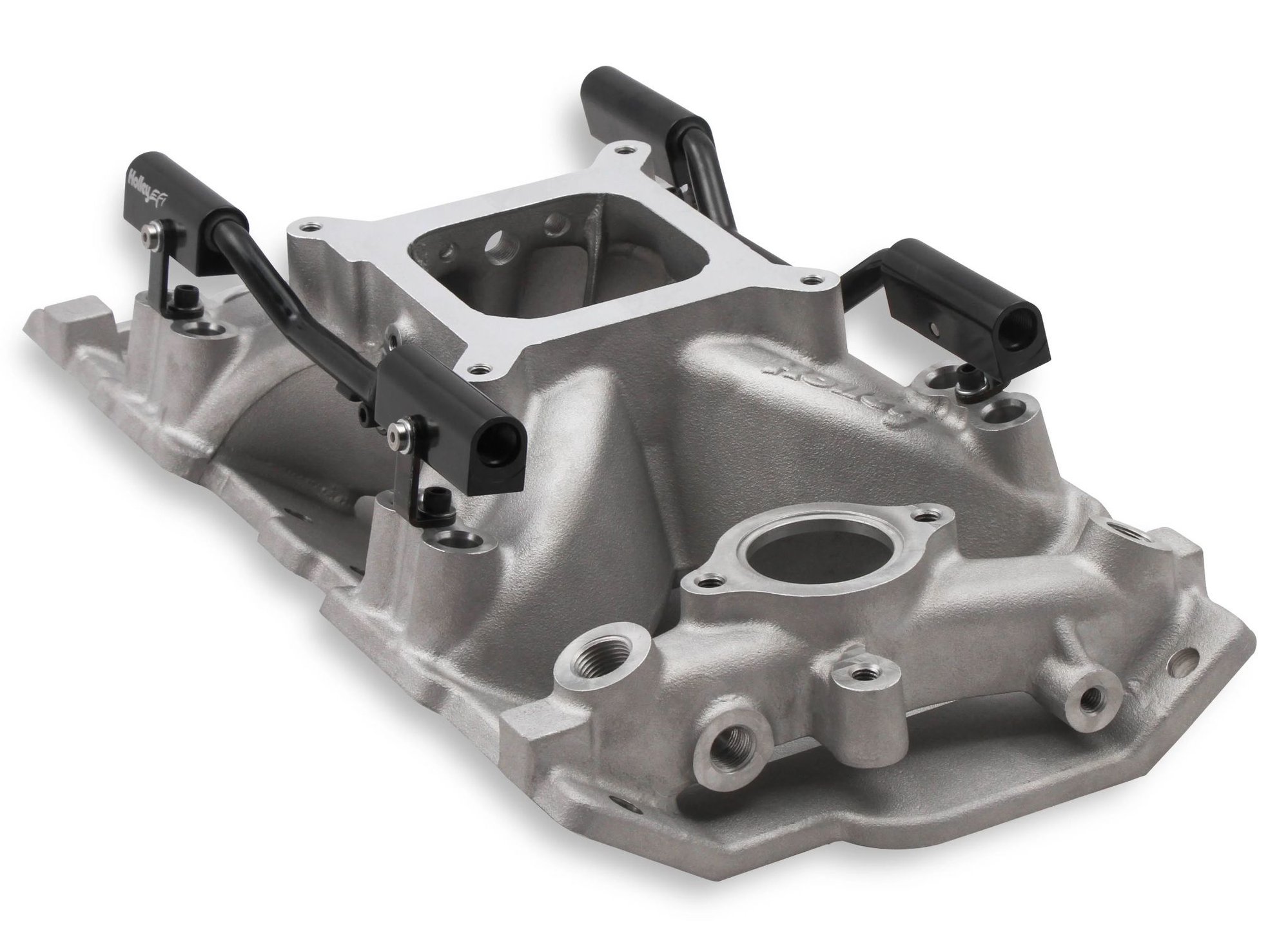

Direct port injectors and an air-only throttle body? That sounds familiar!
If it were important for someone to retain an original Gen 1 SBC, how would you do this? Other than @Fly skids up!'s excellent build thread, is there another example to follow?
https://www.corvetteforum.com/forums...ld-thread.html
If you wanted to keep the Gen 1 SBC, but move to a tuned port injection system - without moving toward a tunnel ram system, here is the blueprint to do it. The parts are still available (I did the research several years ago) for the most part. It would essentially be a single plane manifold with injectors and fuel rails at the ports, with a air only throttle body. You'd have to use an engine management system like the Holley Terminator, but this setup works great - and it can retain some of the look of a Gen 1 SBC - and have all of the advantages of tuned port injection.
Here is most of the parts list, although not every little thing...
300-260
HOLLEY EFI SBC EFI INTAKE MANIFLD AND FUEL RAIL KIT, SINGLE
PLANE 4150 MEDIUM PLENUM SIMILAR TO VR JR
Use 522-368S Short Injectors.
112-588
Throttle Body, Universal, Multi-Port, EFI, 4150 Square Bore, 1,000 cfm,
Cast Aluminum, Polished, Each
522-368S
Holley Fuel Injectors, Sniper EFI Fuel Injectors, 36 lbs/hr., 12 V, Saturated
Circuit, Set of 8
550-936
TERMINATOR X MPFI UNIVERSAL, bb/sbc
538-13
MAP Sensor, Bosch-Style, 2-Bar
558-201
Injector harness designed for EV6-style fuel injectors. For use with
Holley HP and Dominator and Terminator X EFI systems.
558-443
USB/CAN HARNESS, USED WITH CAN PLUG ON SNIPER, TERMINATOR,
HP, TERMINATOR X AND DOMINATOR ECU'S
534-10
Coolant Temperature Sensor for Holley EFI and commander 950 systems
558-465
Wiring Harness, WIRING HARNESS, CAN SPLITTER
565-200
HOLLEY EFI DISTRIBUTOR, DUAL SYNC, SBC/BBC
8222
Coil, Blaster, High Vibration, Black, Blaster 2
EDL-FRC Edelbrock Fuel Rail cross over line and fittings Includes:
4x -6x-6 ORB for each rail
2x -6x45 Deg hose ends
1x -6 Race Hose 1ft
