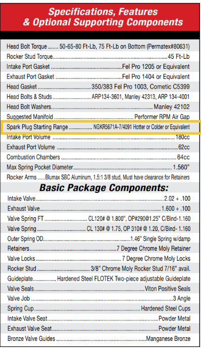

This is what Flotek is now recommending for my model heads. This is a non-resistor spark plug which suggests Flotek believe the heads will perform better with a more vigorous spark. I would have thought the gap would also matter but they don't offer that suggestion.
