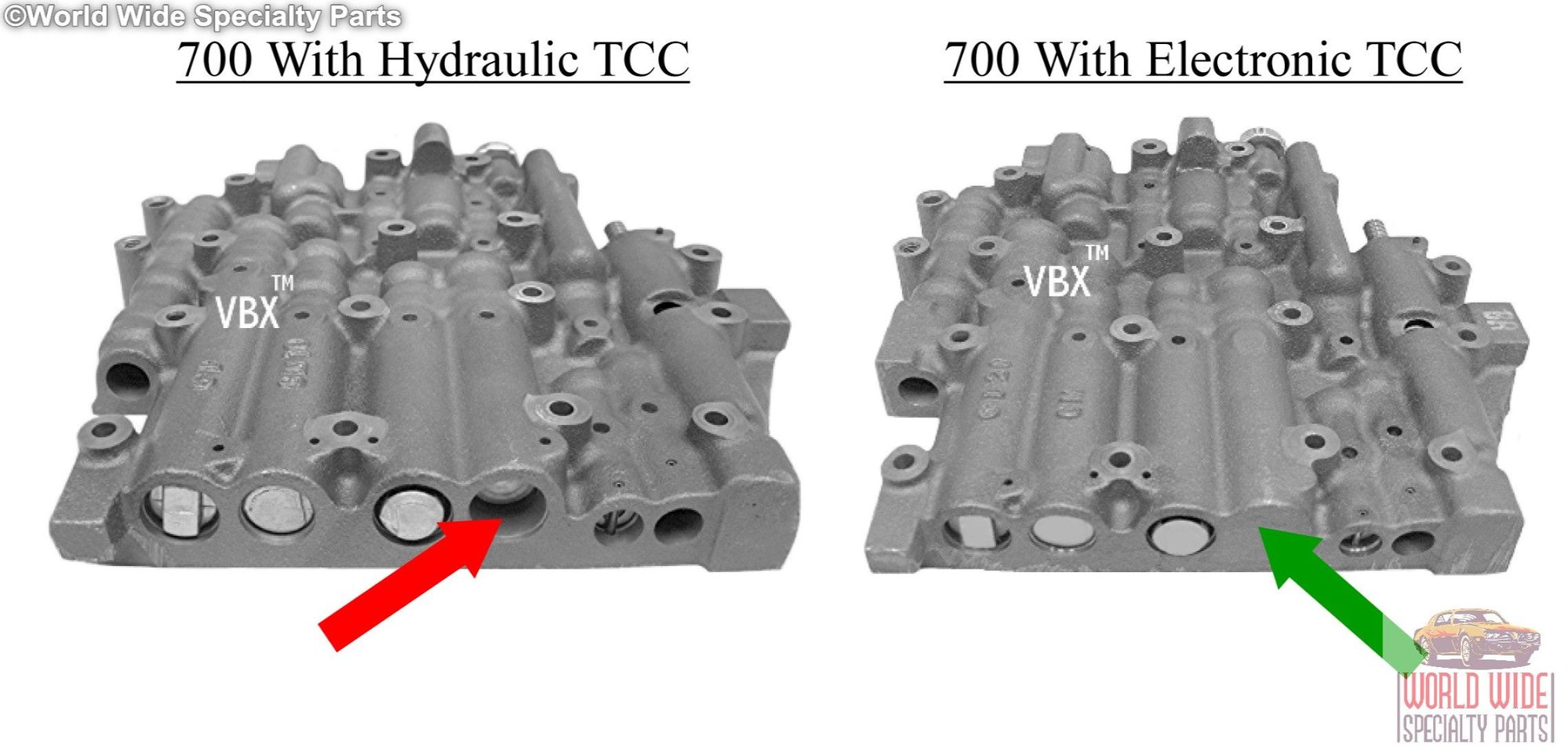

How do you tell if the valve body is factory machined to accommodate the new TCC shift valve and TCC shift TV bushing?
There is casting difference in the case between the years and date codes too. But really you need to drop the pan. An early valve body (those are the bored ones) will swap into any year 700r4 along with the TransGo 700-P separate plate.
The thing I like about this kit is it raises the 4th gear shift point and delays converter lockup after the 4th gear shift. The bored hole in the valve body is like GM originally intended for these transmissions to have hydraulic converter lockup.

Some searching on the net and I found a couple of photos on identifying which valve body you might have.
JT
