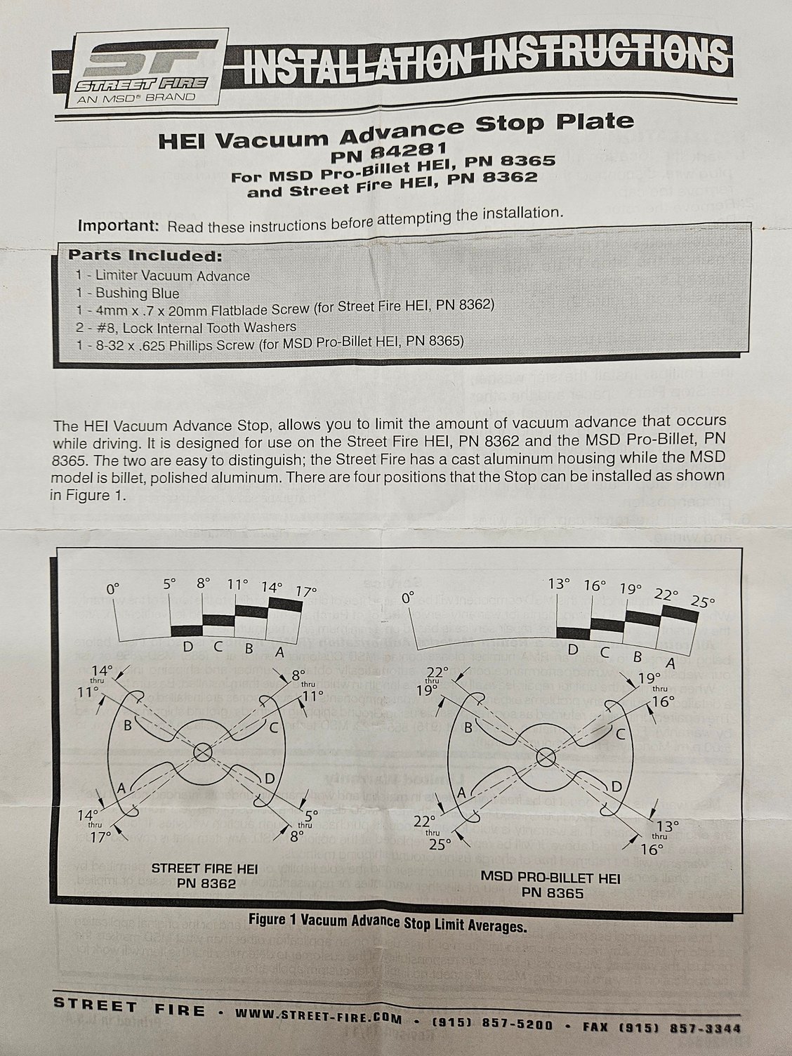

Thought I would share the info on using a vaccum limiter that came with my MSD dist. As you can see there is quite a bit of adjust available with a correctly working vaccum advance.
