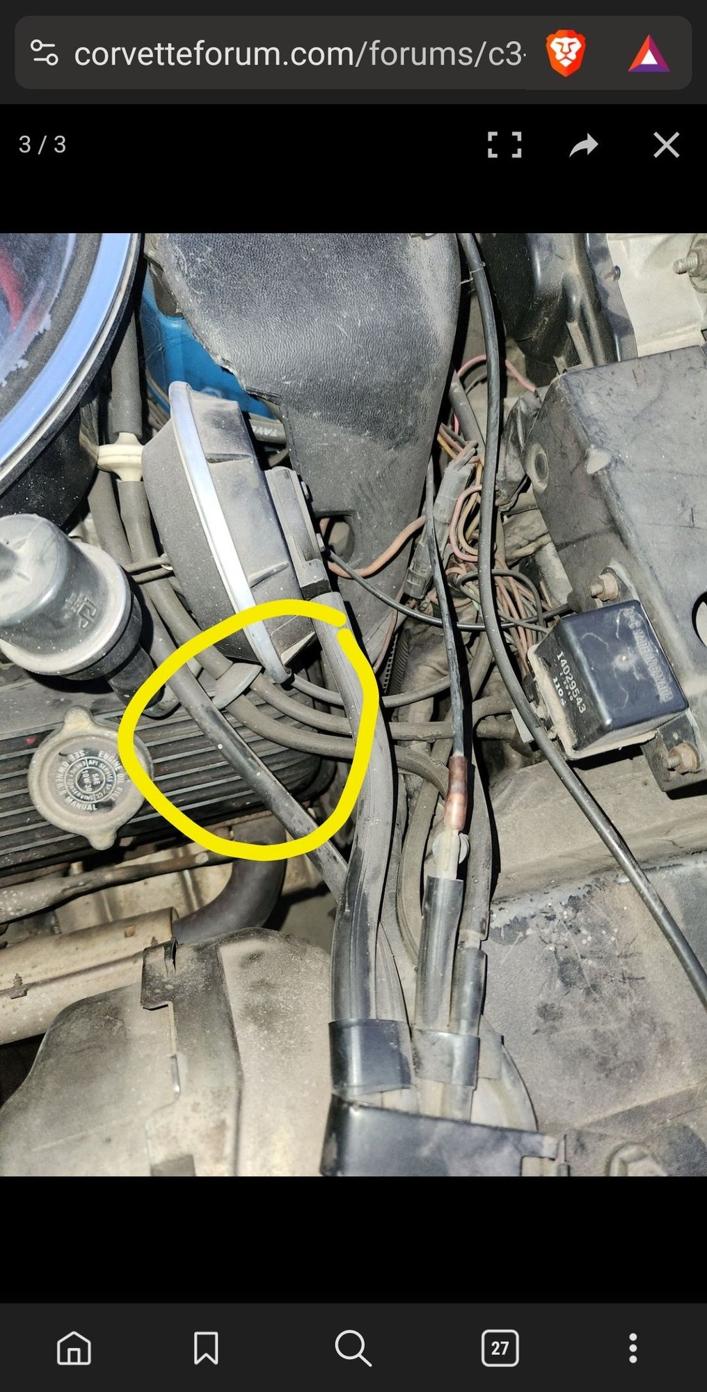

I popped my hood and it's it those 2 hoses that plugged into the firewall?
Old Sep 7, 2024 | 01:24 AM
4-vettes's Avatar
4-vettes
Posts: 13,227
Likes: 7,823
Cruise-In VIII Veteran
In your second photo, centered up and down. Slightly left side to side. There it is just in front of the edge of your cruise actuator. The smaller of those 2 lines on that check valve/spliter. Remove the smaller line, cap that post of that vacuum check valve. Yes that line then goes into the firewall grommet. And the one next to it is the line coming out.

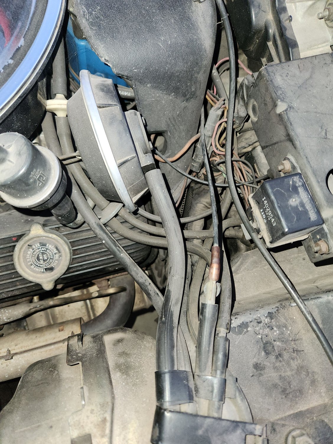

That one ?
Yes!
Old Sep 8, 2024 | 05:18 AM
4-vettes's Avatar
4-vettes
Posts: 13,227
Likes: 7,823
The smaller hose, on the right in your photo is sending vacuum to your headlight switch. Which for whatever reason you did not disconnect when you decided to convert to electric headlight door operation.
disconnect and cap that. The hiss you hear is a vacuum leak. You DO NOT NEED vacuum leaks.

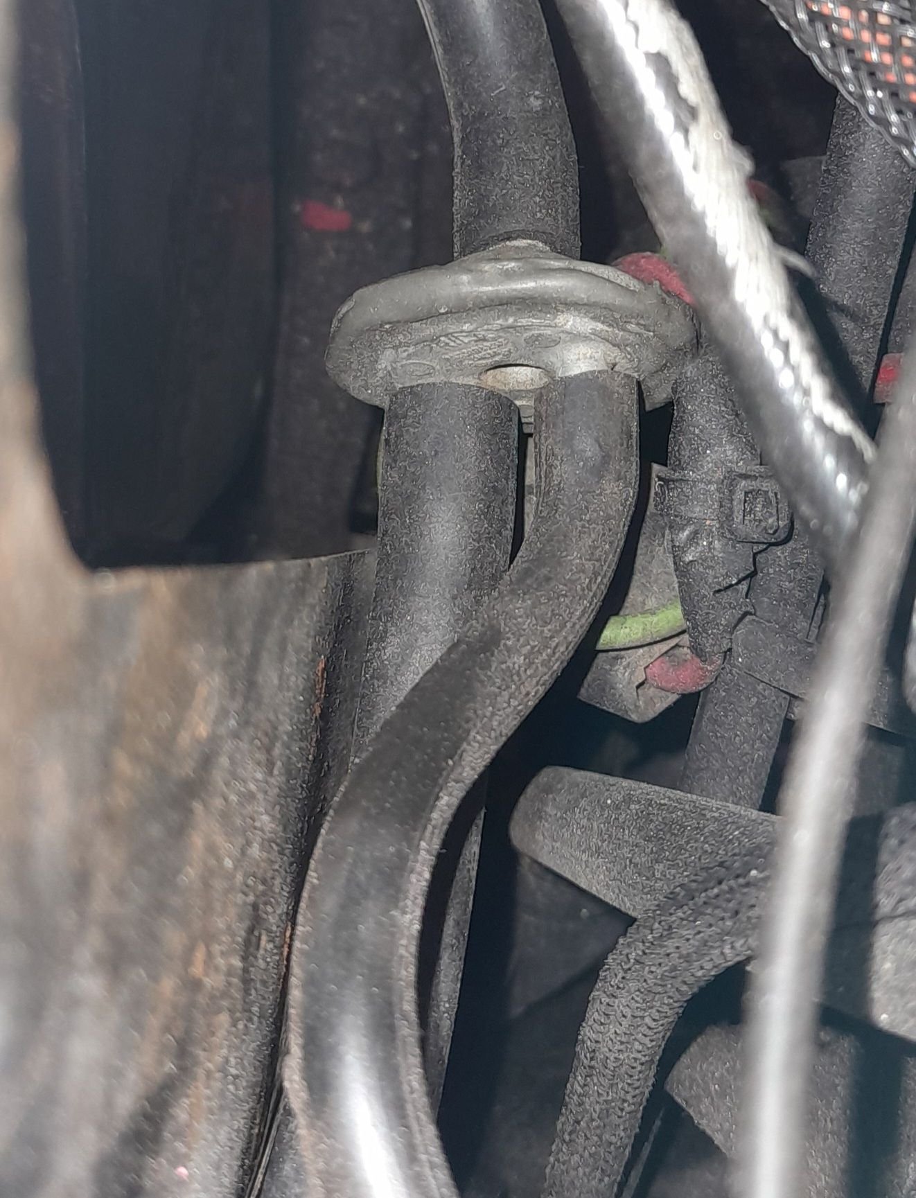

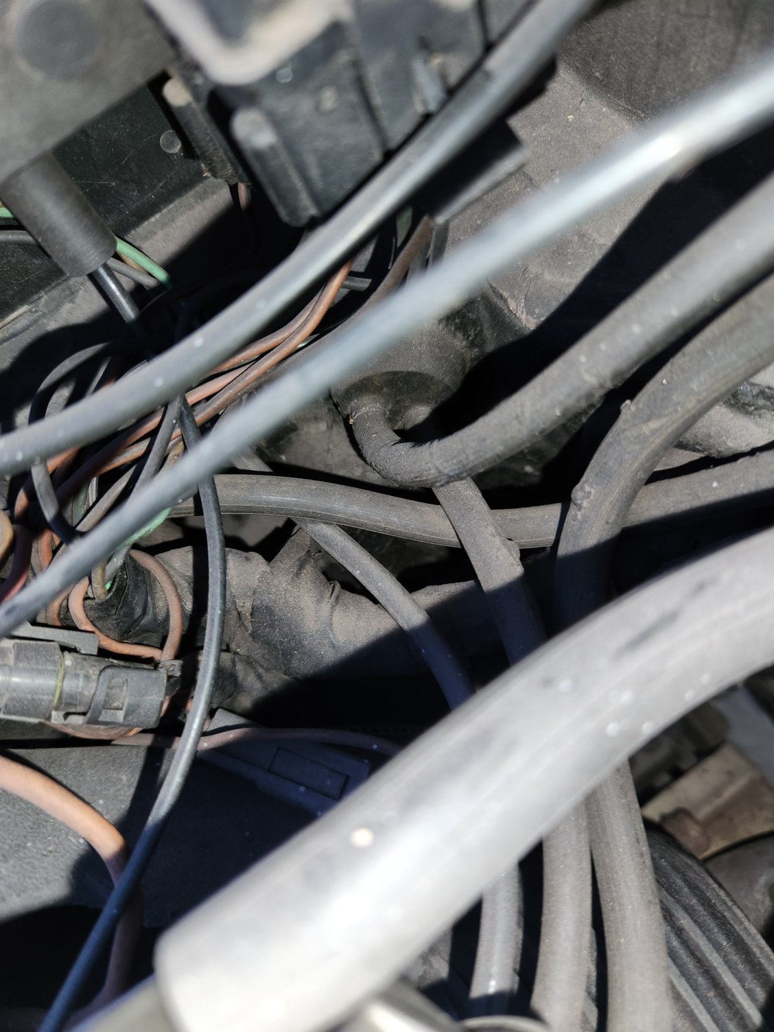

By any chance on the (2) lines coming out from the firewall, are one of those to the AC vents?
Old Sep 27, 2024 | 07:44 PM
4-vettes's Avatar
4-vettes
Posts: 13,227
Likes: 7,823
No. AC vent vacuum line is really thin. Looks like a thick wire actually. Goes through firewall about in the center.
Old Sep 27, 2024 | 09:23 PM
Hellah fresh's Avatar
Hellah fresh
Joined: Jun 2022
Posts: 96
Likes: 27
Ok I just wanted to make sure because I went ahead and plugged up both valves on both ends. Basically took out the line in between.
